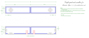

I wonder if it would be possible to couple a pair of small speakers in a soundbar configuration for bass enhancement using direct radiation for stereo separation?
Dear EddieT,

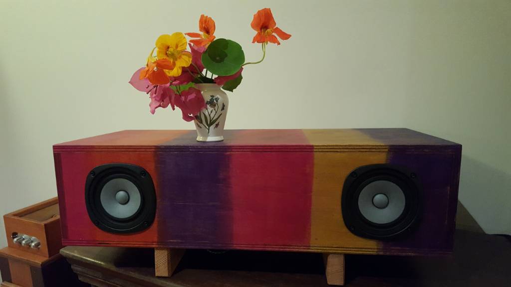

I built a soundbar with the SPK Audio F02A-4(2" full-range) and it has plenty of bass about 70Hz.
SPK Audio F02A-4 soundbar at YouTube

@nandappe Thank you very much, I like the design and I think the parallel ports would indeed enhance coupling bass to the room. I also enjoyed a visit to your website.

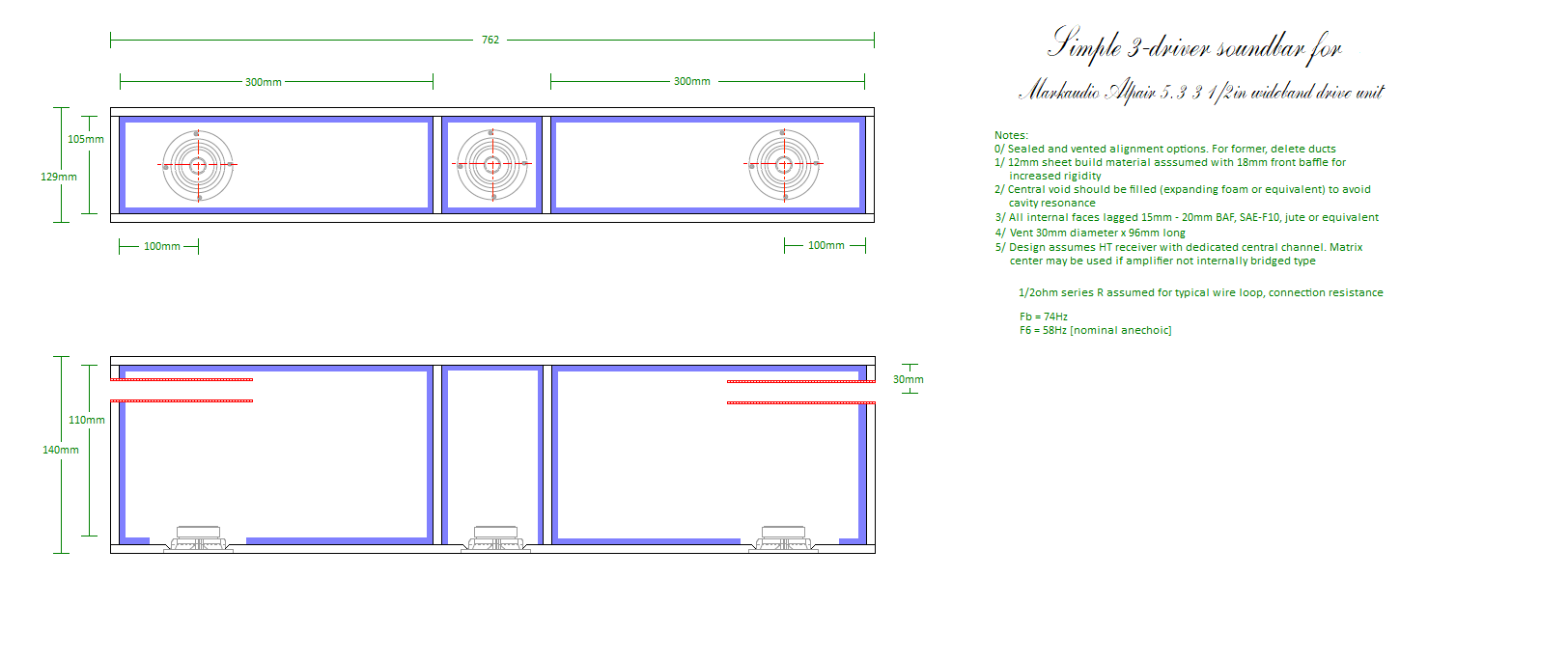

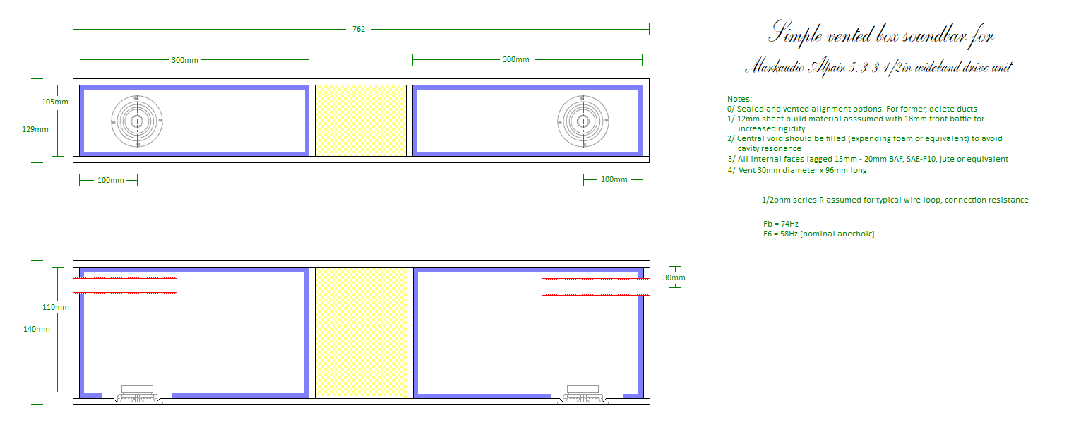

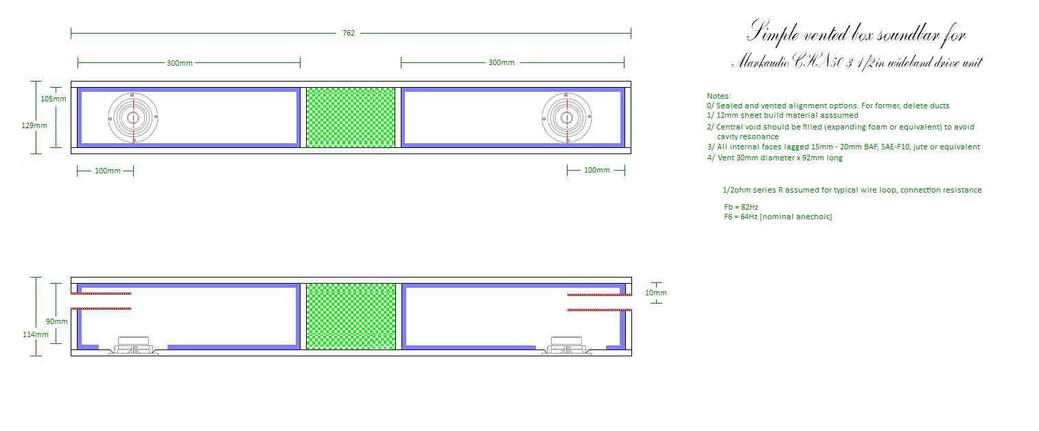

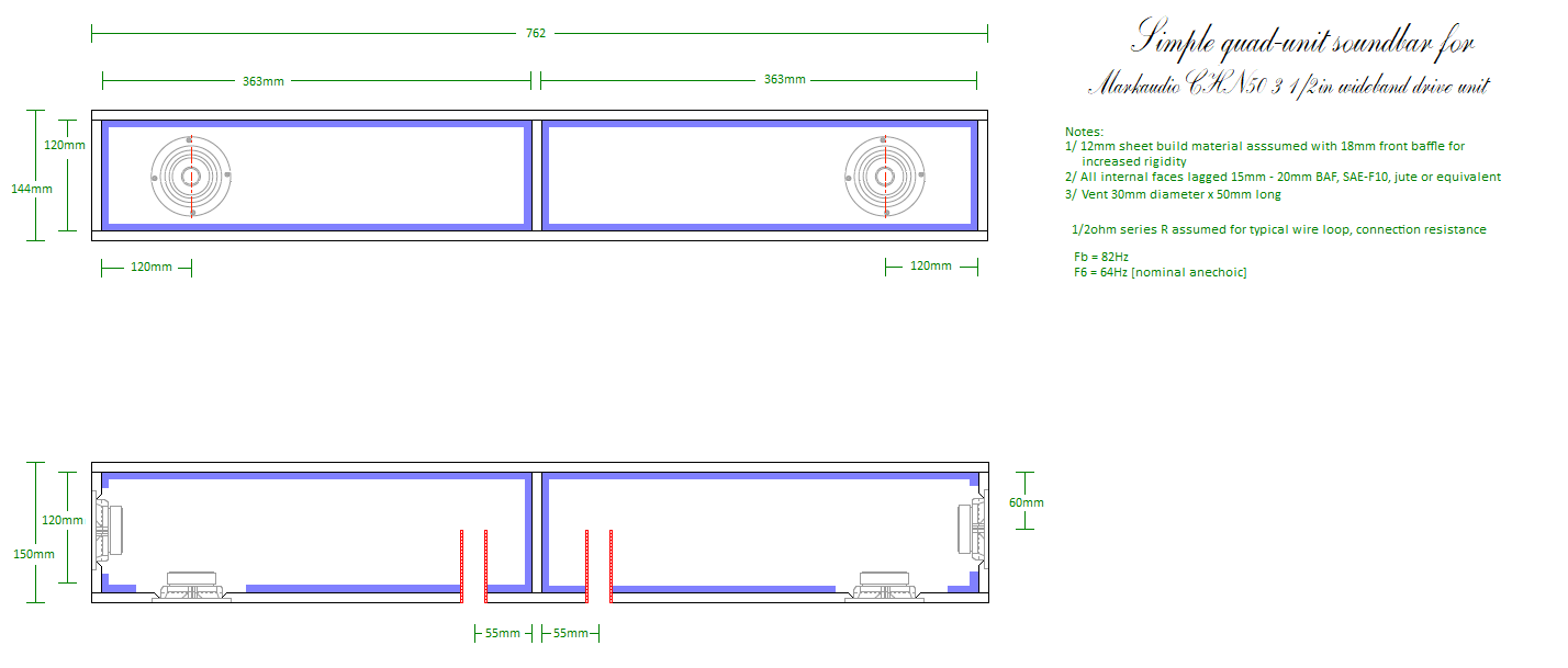

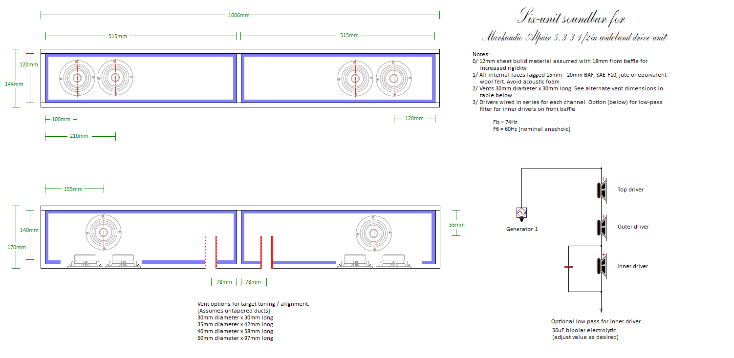

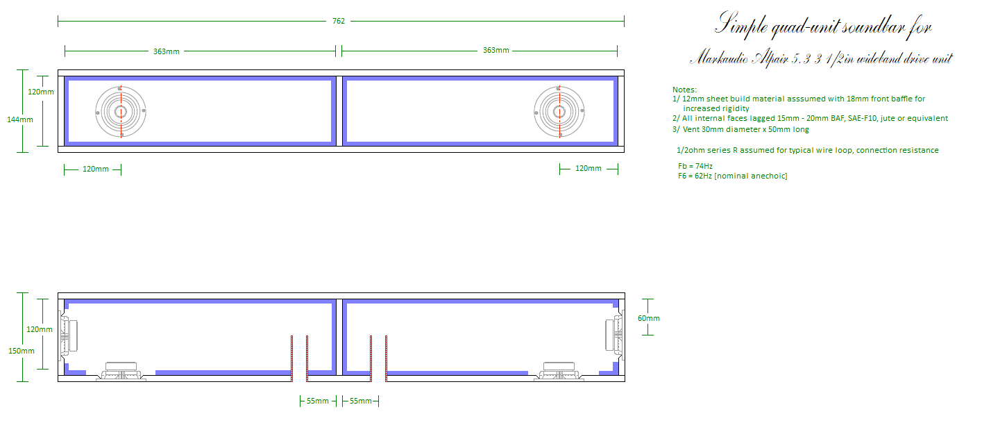

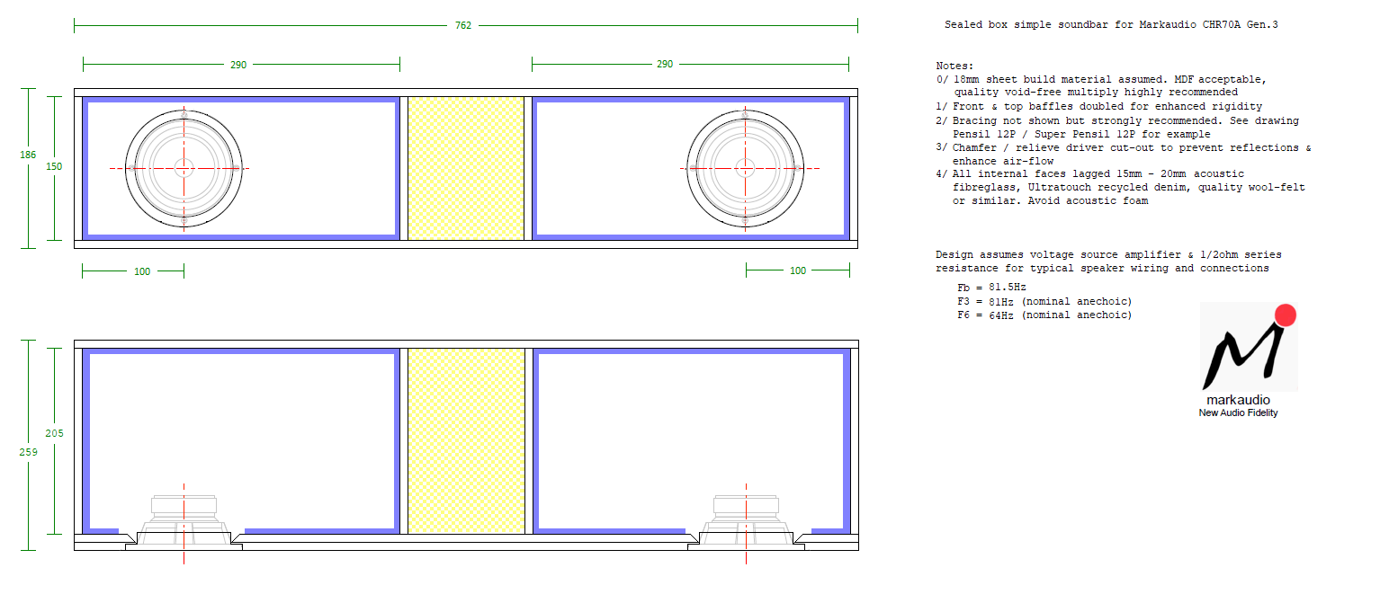

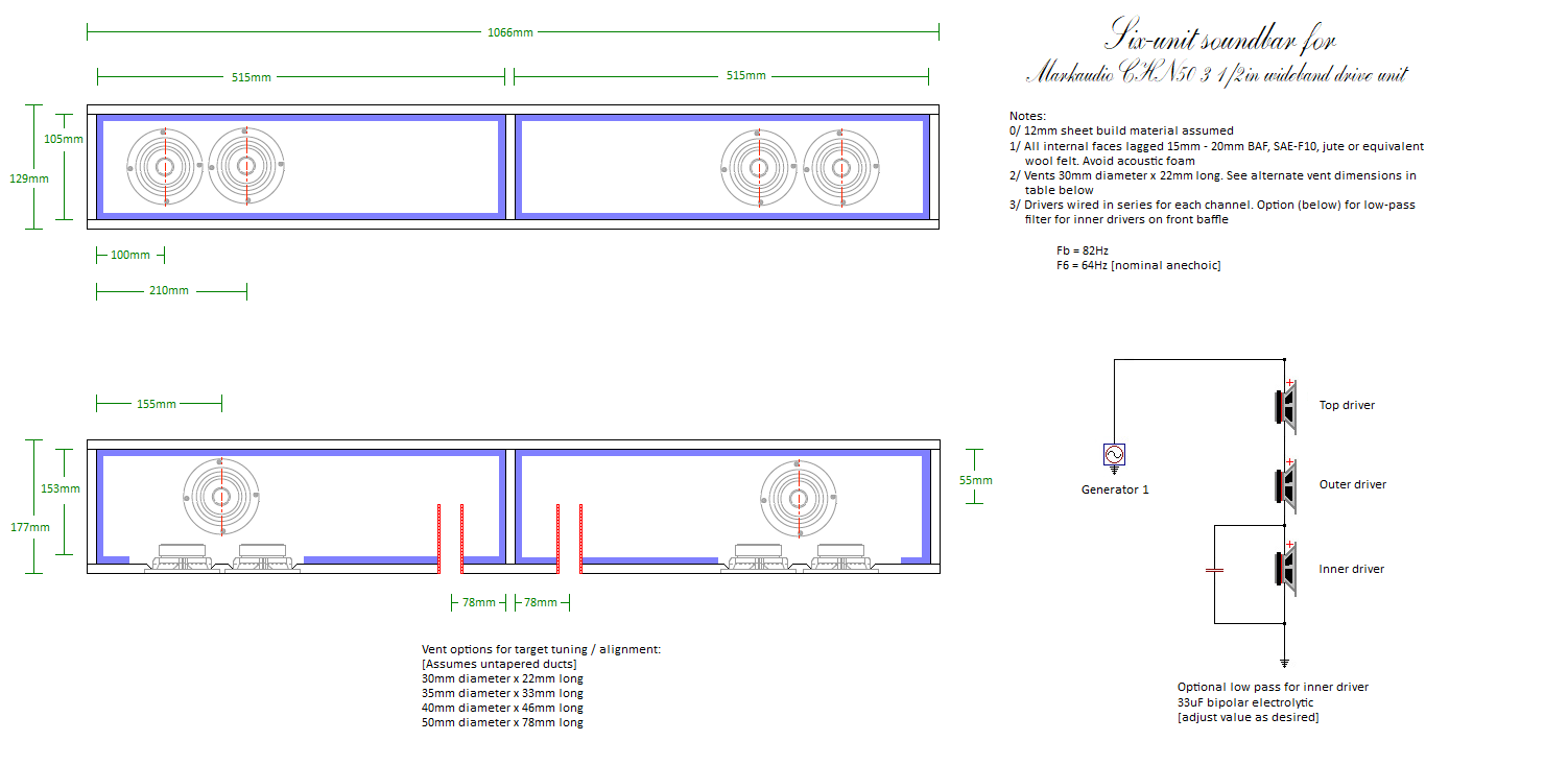

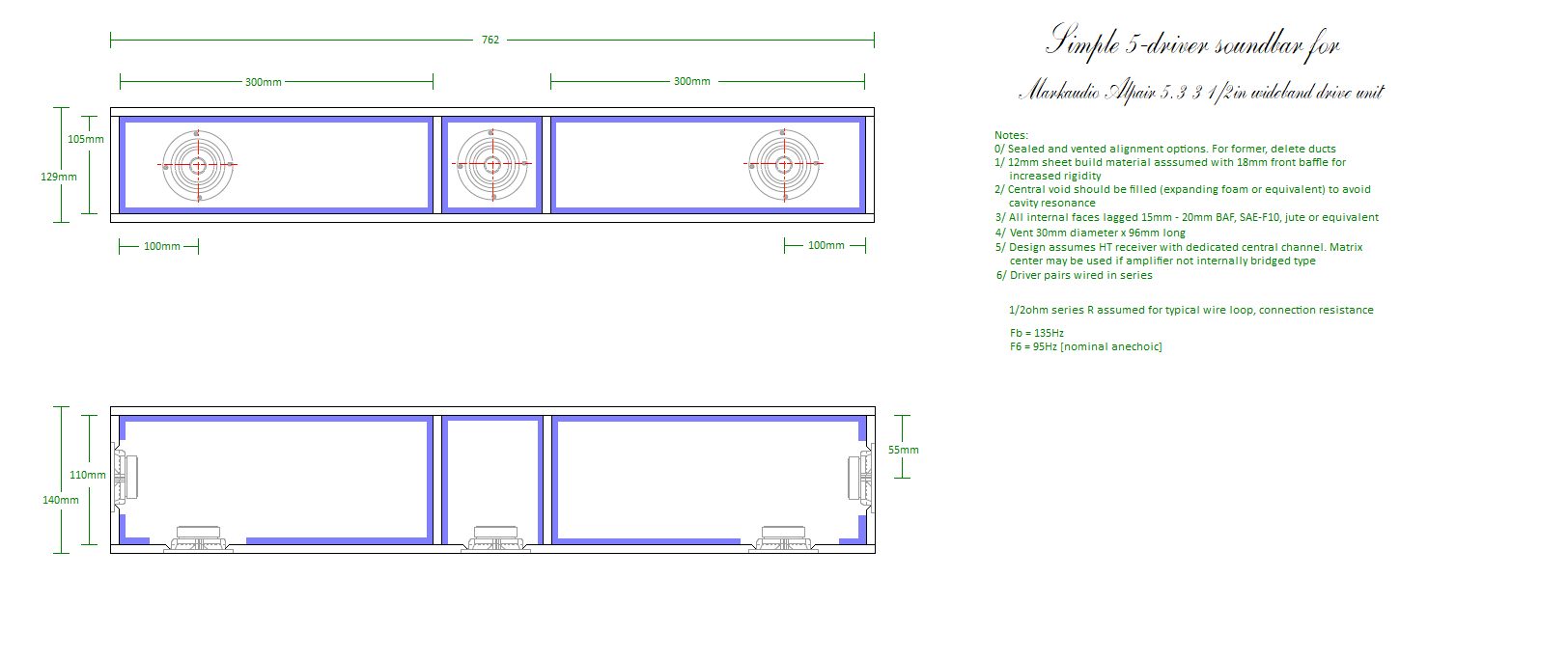

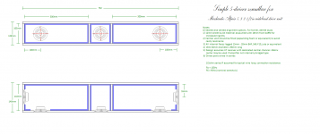

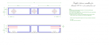

Just to add confirmation, it's certainly possible. The attached are some simple designs I did some months ago for a few of the MA units -they're on their site, but tend to get buried. I suppose I should do a few more when time permits.
I didn't express it well but I was thinking of single or coupled chambers to enhance the bass. The adjacent parallel bass ports of nandappe's design come close.
@Scottmoose , would the CHN50 soundbar designs you have here and on the MarkAudio wesbite work with the CHN-50P too? or are they very different.
thanks
