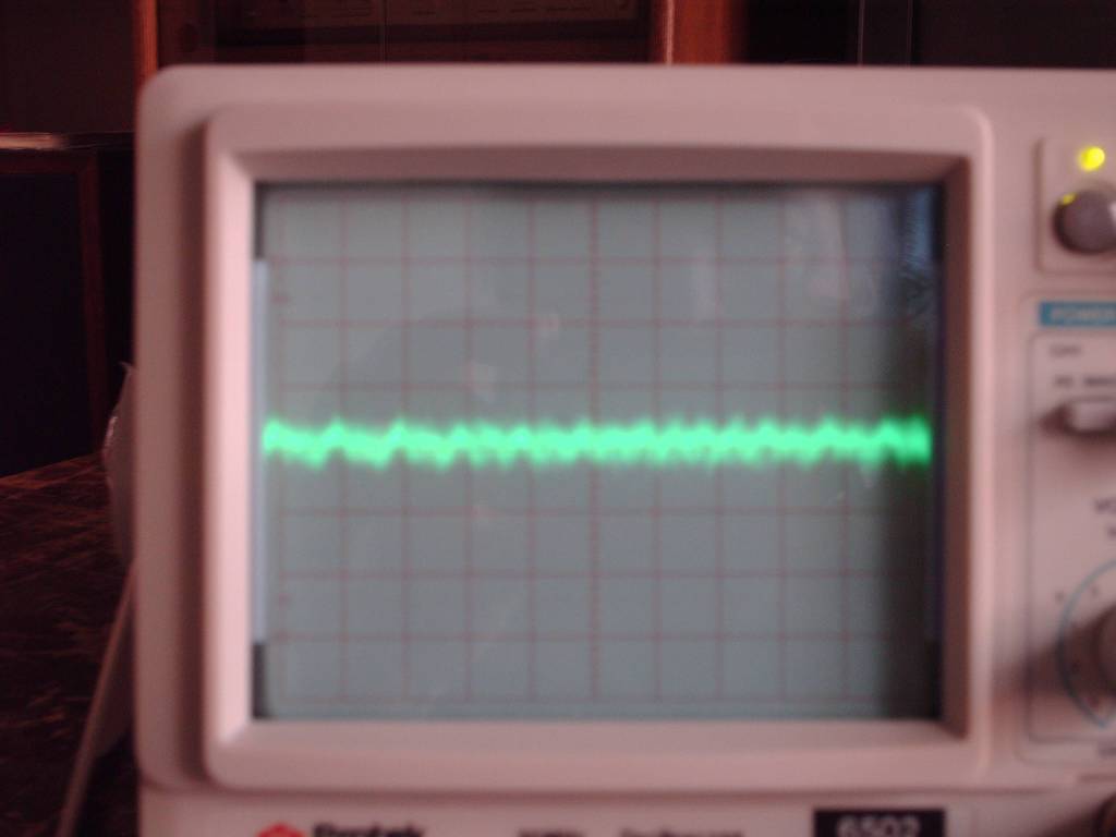

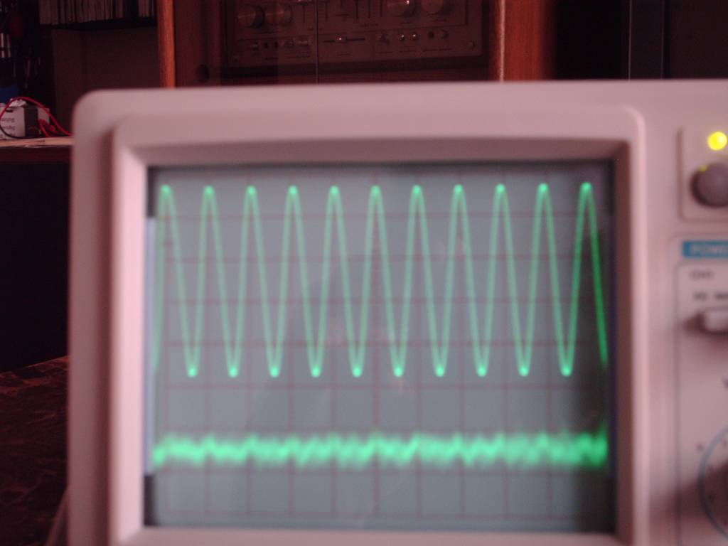

It appears that the problem is solved. U206 is socketed, so I removed it from the board then reinserted it. Distortion is now reading .0008%. This is in test mode given in the manual.
INPUT: 3V
80K FILTER IN
RATIO: .01%
ATTEN: 0 dB
OUTPUT VENEER: Fully up
LOW DISTORTION MODE
Frequency: 1K (100 x 10)
The issue of the meter swinging wildly was caused by a dirty ADJ switch. I have Option 003 (AUTO SET). This switch is a sealed type where cleaning can't be done. Replacement is the only option. Cycling through it cleared it up for now.
Here are a few pics of the set on my o'scope. The Distortion pattern (bottom trace in photo 1 and the trace in the pic on the right) is the same after removing U206 with the exception of the wild spikes.
Perhaps someone with a fully functioning set can post some pics of their output from the DISTORTION OUTPUT jack under the same conditions. In this way we can create a working file.
P.S. No, I don't have a pink scope.😀

Correction
Photo 1 is the DISTORTION OUTPUT trace only where as pic 2 is a trace of the 1K frequency from the INPUT MON (top trace) and the DISTORTION OUTPUT trace of the 1701A. (Bottom trace).
It looks as though yours is more than meeting specs. getting replacement optocouplers is probably wise. Allied has the Silonex ones in stock in the US. They are supposed to have lower distortion.
The distortion waveform looks correct. if you enlarge it to one or two cycles of the fundamental you will see probably 3 cycles in the distortion residual along with noise.

Demian,
Thank you for your quick replys. I still want to buy optocouplers to have on hand. Would be nice to be able to plug in upgrades without circuit mods.
What this set really needs is to have all switches cleaned. The ADJ VR will be a problem since I can't open it to clean it. It can be opened, but the thin metal that holds the 2 halves together will not tollerate bending back and forth that is needed to open then close the halves.
