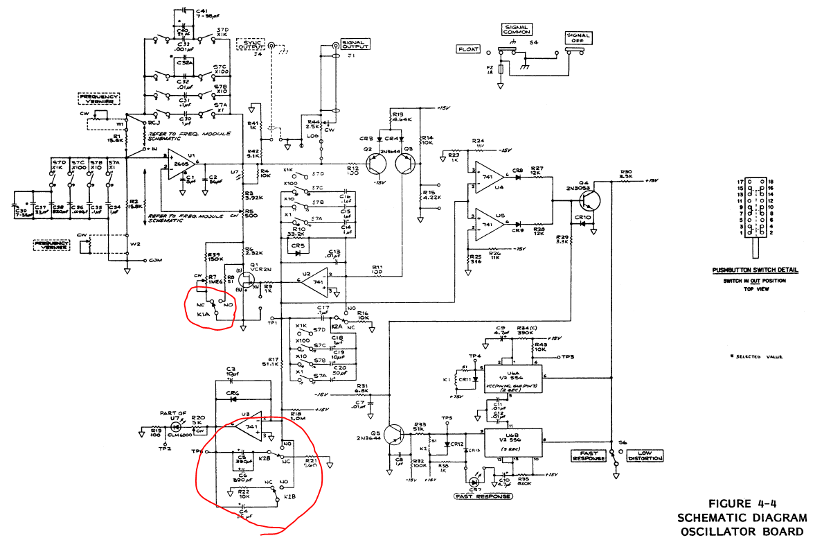

I picked up the 1701A over the weekend and it is a clean looking unit. I am waiting for the manual to arrive, so I can read it, no matter how painful that endeavor might be. 🙂 Never have used a distortion analyzer before, so any help from the group here is greatly appreciated.
Putting the juice to the box, it passed the smoke test and all lights seem to be working. The analyzer is seeing the oscillator, which is a very good thing. When switching the oscillator down to low distortion, a pretty loud click can be heard coming from inside the box. Happens every 4 seconds or so, but I am thinking that isn't normal. If it is a problem shouldn't be to hard to track down the noise and it will be a good starting point to get the box back up and running 100% again.
This box is way overkill for my needs, working on tube FM tuners and various other old HV tube sets. Looks well made and I sure don't need to learn where are all of the different functions sub menus are located on today's GIF test pieces. TIA
The clicking is common is the ST analyzers. The oscillator has a relay that switches from fast settling to low distortion after a short period. I have not looked at that circuit in "forever". The relay is circled in red in the attached schematic. Once the oscillator has stabilized it switches. There is an adjustment but I hope there are instructions in the manual for adjusting it. Its possible the photocell has deteriorated and needs replacement. The silonex optocoupler would be the prefered option.

Thanks for the schematic Demian, greatly appreciated. Still waiting on the manual and will then see if there is an adjustment for the oscillator when shifting over to low distortion mode. Probably the op amp is kaput and I will poke around in there tomorrow and see what I find. A simple LED check on the light side and I am thinking the resistance on the other side should be under 50 Ohms. (?)
You can upgrade the opamps and get the distortion floor lower. You will need to make adapters to fit the TO99 to a dip footprint.
Sounds like a great idea Demian, while in there refreshing the unit to begin with. IIRC, the U7 LDR is very ripe for failure in the oscillator circuit. When checking Mouser there are options for thru hole TO99 op amps, are these the units you are mentioning Demian? I am thinking they are as you can solder these right to the adapter PCB board and then have the male dip footprint adapters mounted to the other side of the board from the new TO99. Is there a PCB diagram available? TIA
You have it reversed. The PCB's are layed out for TO99 packages (this is vintage) but the best current opamps are available only in SOIC actually. You need an adapter with pins in the circular side to fit the sockets (fortunately it is socketed) and then mount the opamps on the dip side. Also I would suggest an LME49710 but all you can get now are fakes. So next adapter for soic to dip and get OPA 1611 or similar. John Curl had success with AD797 in his 1701 (shares a lot of circuitry).
If there is output from the oscillator then the OPAMP is ok. finding the appropriate Silonex LDR would be the next step and change all of them. I think there is some discussion on DIYaudio of which ones are the best match. That could take some searching. Here is something: Sound Technology 1700/1701 | Audiokarma Home Audio Stereo Discussion Forums

After checking thru various threads about the LDRs that are in the 1701A, it looks like substitutes are still available for these failure prone pieces. The Clairex 6000 looks like it is still available from Little Bear electronics. These substitutes work better in the analyzer side of the box. The Perkins and Elmer VTL5Cs supposedly work better on the oscillator side of the unit. Any ideas as to why?
The VTL5Cs are popular with the guitar crowd and they have exhausted the old manufactured NOS supply for the most part. CoolAudio is making the pieces once again, but I know nothing about this manufacturer, or the quality of it's end products. It seems like CoolAudio is filling a niche market of discontinued audio parts and producing them once again. I sure don't mind paying 9.00 for a part, that use to cost less then a dollar back in the day. Especially if it helps the 1701A work correctly here in 2020.
