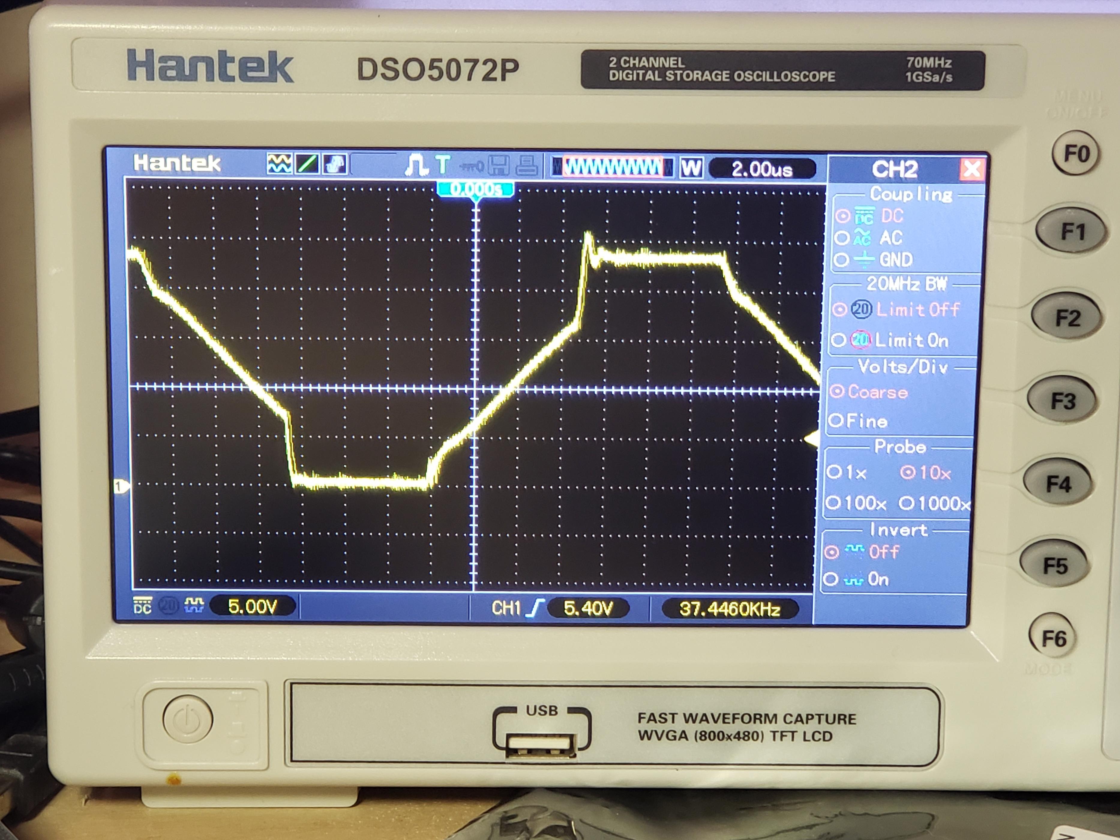

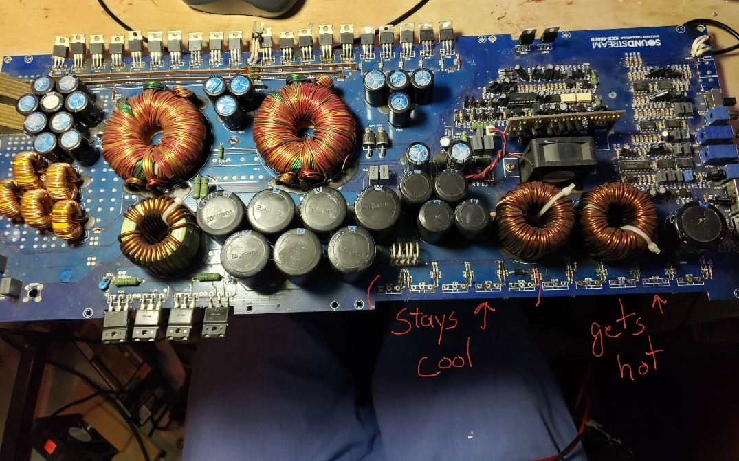

When I apply power to the amp with one fet per bank of the output section, the low side stays cool but the high side gets hot. Any ideas what's causing this? Both waves appear to be identical.

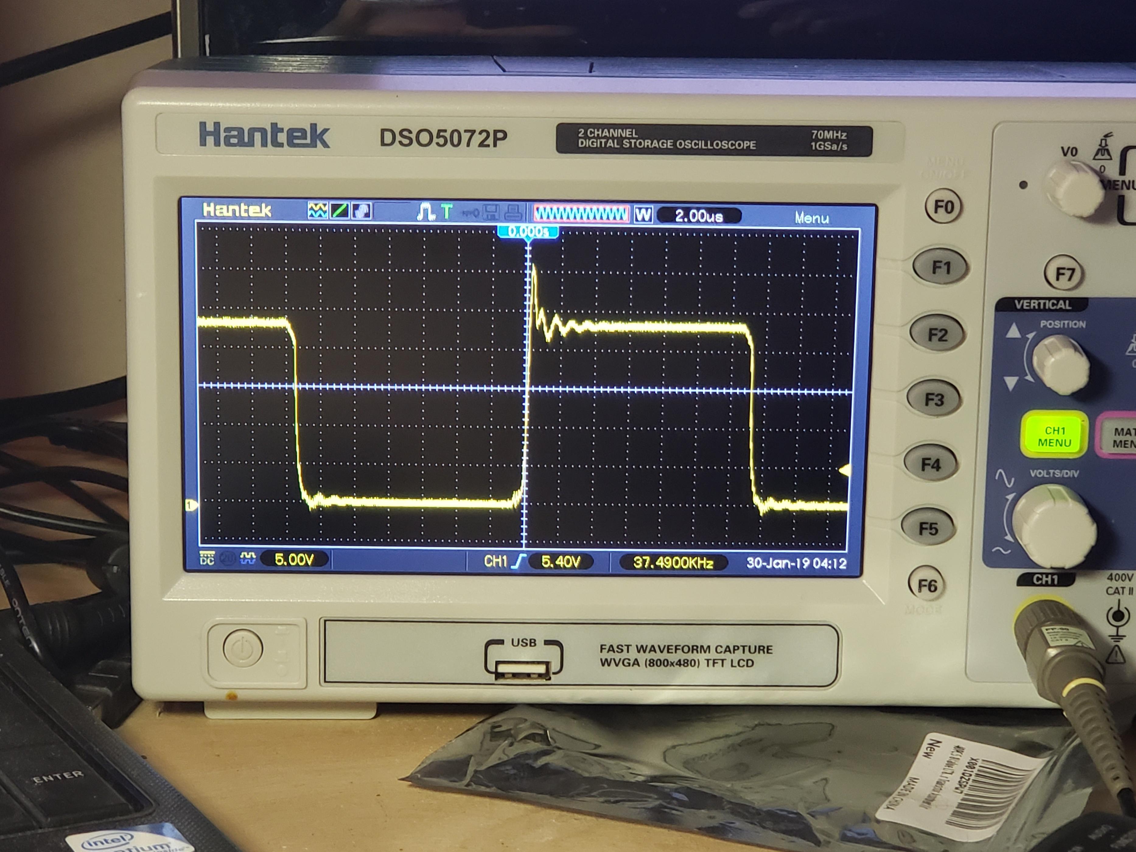

Also when I have the rectifiers out the square wave on the power supply fets look like the first image below and when I put them in it looks like the second image below.
