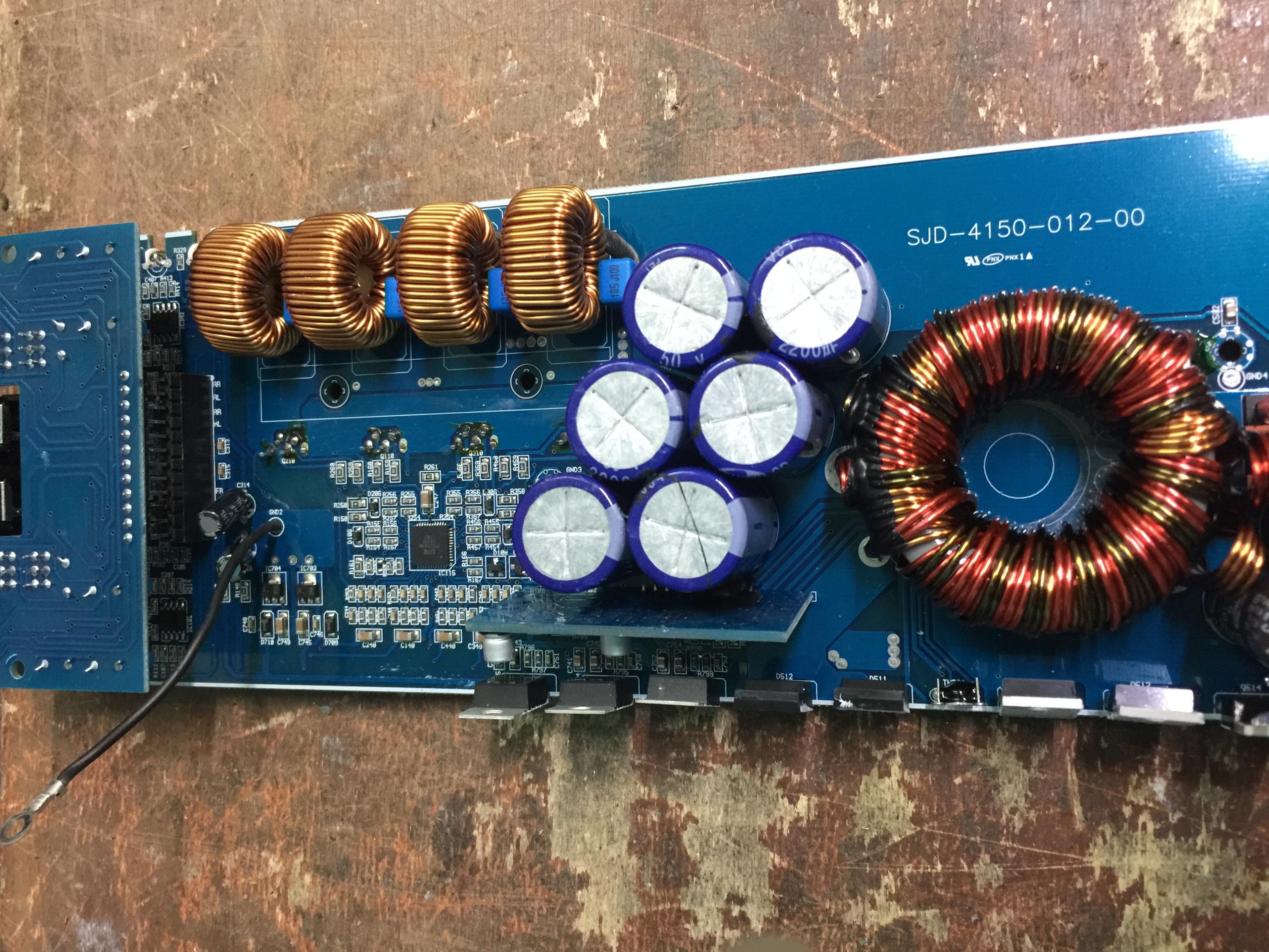

Have you ever worked with this IC?
Have you checked for the various supply voltages on the IC?
Do you have any activity on any of the terminals with audio driven into the amp?
I work with that IC on a similar amp with same symptoms and was not able to solve the issue .The supply voltages present .
Input signal doesn't cause any difference on the output terminals.
should i pull the the output ICs ?
Only pull them if you think that they're defective.
List the supply voltages that you've confirmed as present.
Do you have the schematic diagram for it? I do not.
Hi I think the ic is in shut down I've worked on home theater equipment that uses the irs2053m, which is fairly similar. Would u mind sharing what supply voltage are present .
If you want to take over the thread, the Pioneer GM-D9605 service manual and the IRAUDAMP8 documents may be helpful.
