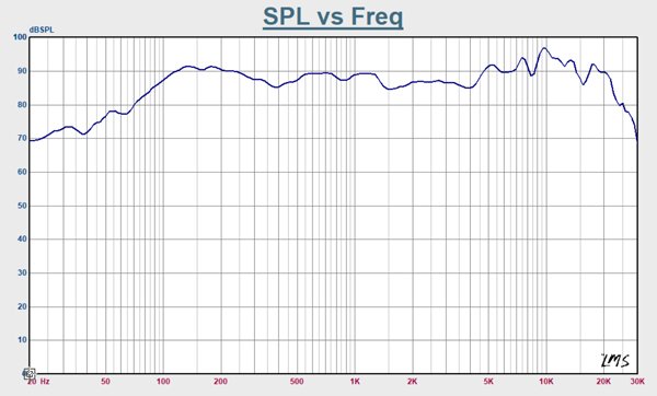

Shown here is the Maop 11 ....would be OK for a mid-range...below 125 Hz, it falls on its face, & above 4500 hertz it starts screaming, trying to hit 100 Db.

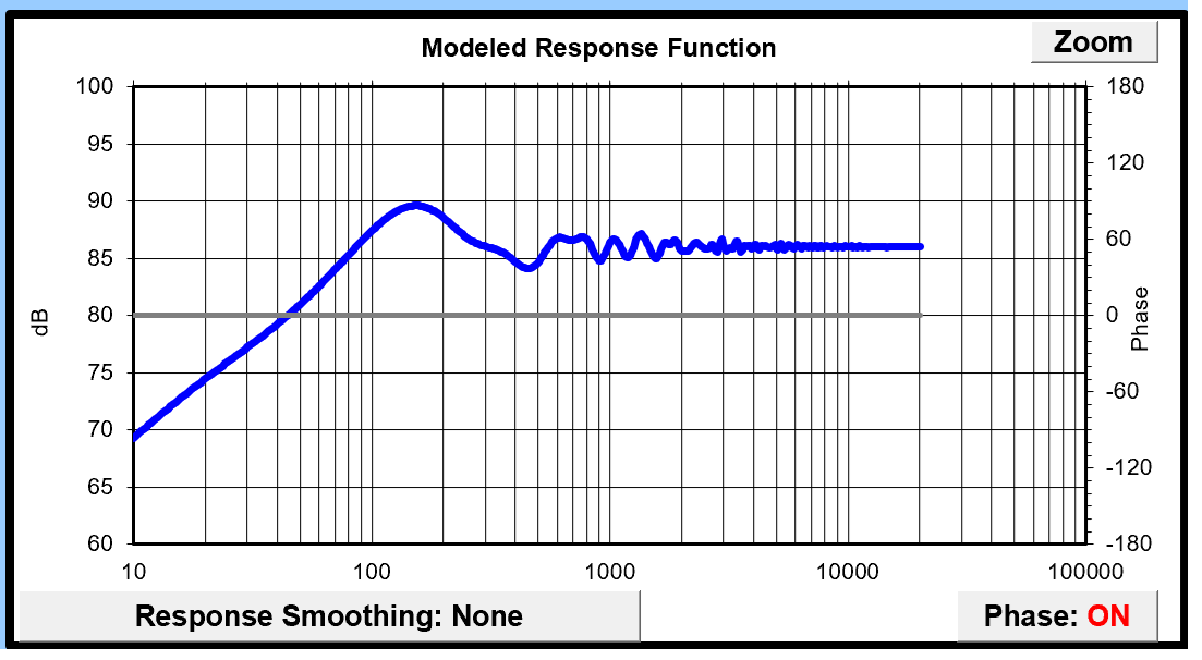

Of course it does: you're showing an anechoic FR taken on an IEC 268-5 test baffle (simulated baffle response attached with relevant offset for the driver location).Shown here is the Maop 11 ....would be OK for a mid-range...below 125 Hz, it falls on its face,
I'm not sure any driver 'tries' to do something since they don't have a mind of their own 😉 (mind, I'm not sure I have either, today). Like many / most larger wideband drivers though it has a rising axial output peaking at 96dB (9.7KHz), mainly to help the power-response, since there's only so much you can do with the cone profile to improve the off-axis.Shown here is the Maop 11 ....would be OK for a mid-range...below 125 Hz, it falls on its face, & above 4500 hertz it starts screaming, trying to hit 100 Db.
