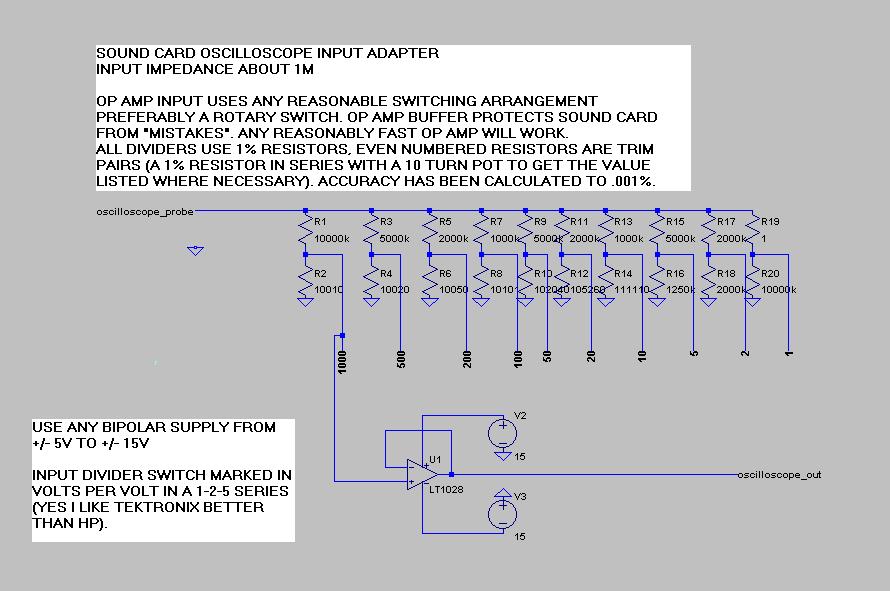

been working on an o-scope adapter for using a sound card as an o-scope. freeware i use is available here:
http://www.qsl.net/dl4yhf/spectra1.html
http://www.moonaudio.com/softwar5.htm
for function generator output use oscope_probe line as the input from sound card line out, and oscope_out as function generator out.
once i build one of these, i will upload board layouts and pix.
