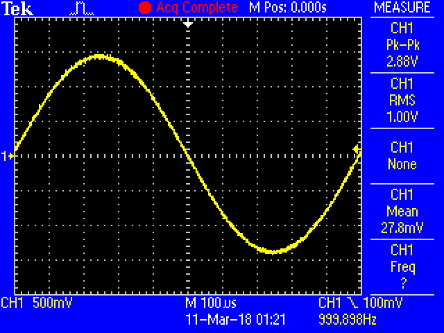

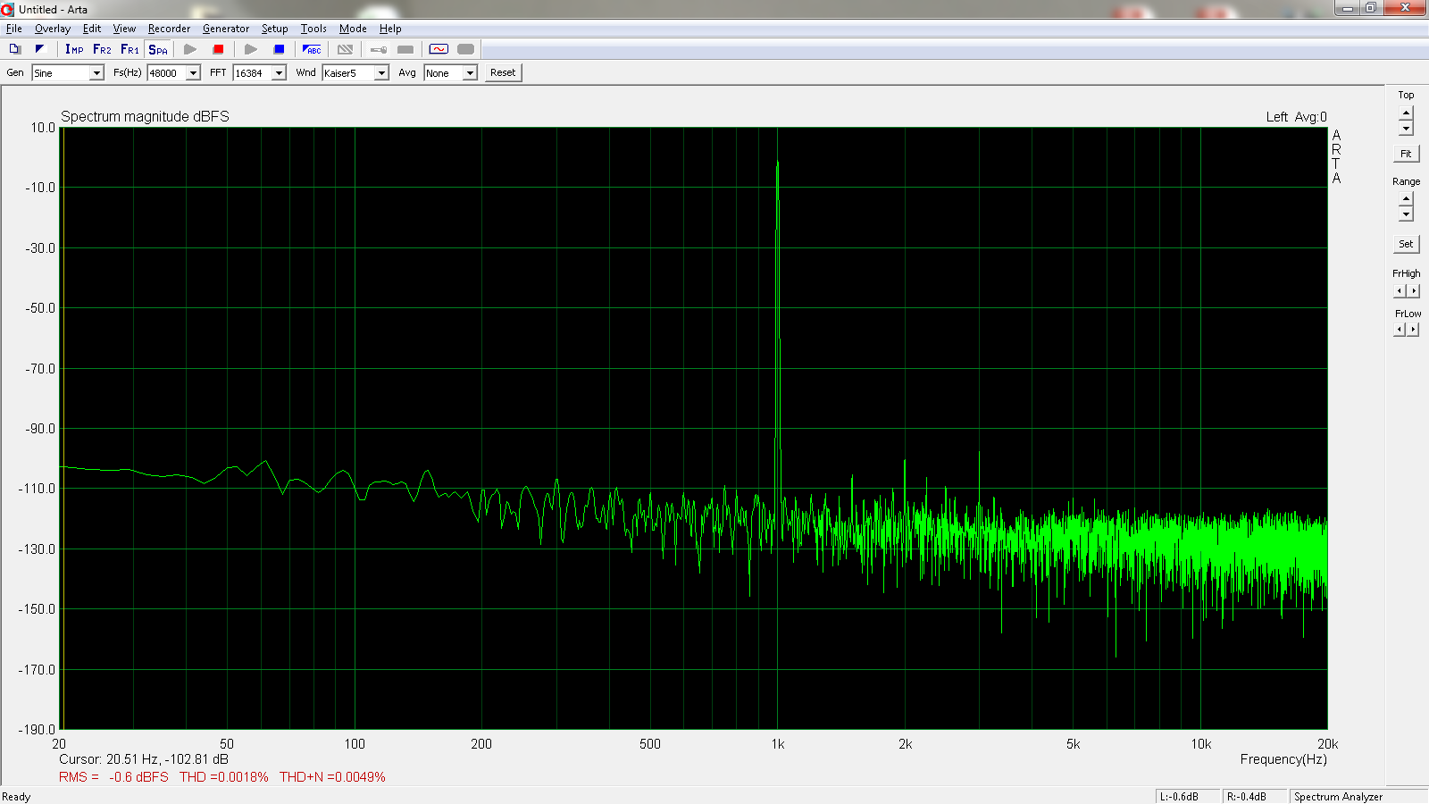

Hi everybody,
The max input voltage supported by Creative Sound Blaster Audigy SE before clipping is 0dbV or 1Vrms or 2.828Vpp.
The images below is my Tektronix TDS1012C-EDU and the ARTA software.
