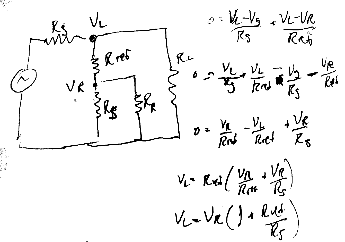

OK, as I woke up this morning it became intuitively obvious that high output impedance will cause the sensed voltage to depend on loudspeaker impedance, giving higher voltages for higher impedances, causing the sensed impedance to increase. Now to figure out the circuit and see if a higher test resistor will impact accuracy, and how little output impedance is needed with a given Test resistor size to minimally effect accuracy.
Looks like intuition was wrong?
Neglecting sound card input impedance, the voltage at the right channel is just the voltage at the left channel divided by (1+Rt/Rl) where Rt is test resistor and Rl is loudspeaker. Output impedance reduces both left and right channel voltages proportionately. I'll have to dig into this more...

You'll only be using one output channel wont you? Conventional measurement styles calling for a large enough series resistance to approximate a current source tend to be insensitive to this anyway.
Output impedance can be found as the value of load that halves the amp output compared with no load.

the greatest sensitivity is had by having the test impedance ~= the measured impedance
a current source does make the math easier but gives up signal amplitude when testing low Z

Here's the math - in the diagram, Vg is generator resistance Rref is test resistor, Rs is speaker, VL and RL are the voltage and impedance of left soundcard input, Vr and Rr are for right. I ignored Rl and Rr for simplicity in this pic, but I did the analysis and it doesn't change much if you include it.
Ron, starting to lose sight of what the question is. You are right in that a larger value of resistor gives the sensed signal accuracy in absolute terms.. the series resistor can be small and still be accurate if it is accounted for, which is typically easiest when your program does this for you, such as Limp (with Arta).
However some find getting the measured signal out of the noise is the pressing issue. This is where the power amp helps, and the benefit comes with the voltage gain. Source impedance, while important doesn't need to be as low as our speaker amps, even though that's what often gets used.
