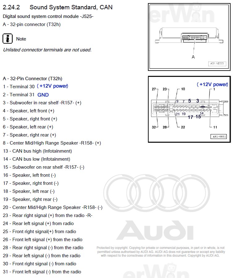

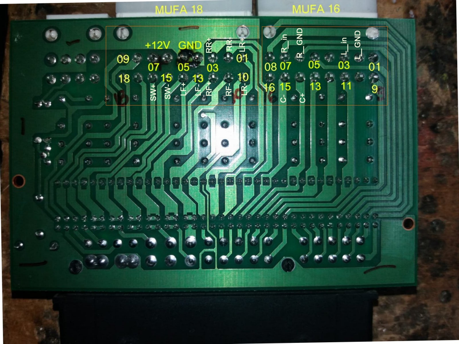

I received a BOSE Sound Amplifier Basic Audi AS4 amplifier module, I want to use it as a separate amplifier, without optical connections,

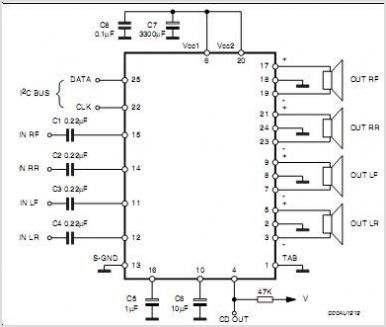

I'm interested in whether the TDA 7566 works without I2Cbus - maybe someone has worked with it before without a controller.
Currently, if the module is powered, you can hear the protection relay switching on and then switching off after a few seconds.
Coupling again if pin 27 - Ring-break diagnostic wire is touched.
With audio signal on inputs I have no signal on output regardless of the relay.
I haven't unpacked it yet to take measurements on the IC board.
If I receive an answer from you that the TDA 7566 does not work without I2Cbus, the approach does not make sense anymore.
I don't even know pin 27 - Ring-break diagnostic wire if it's port in or out. It seems to be in.

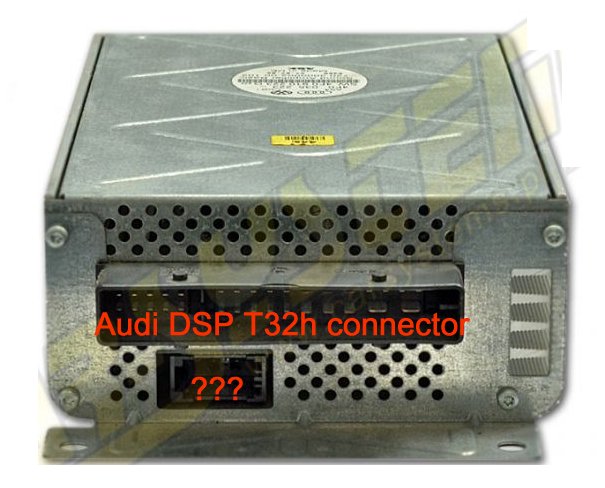

Also I can not find any wiring for secondary connection (below Audi DSP T32h connector) - except one optical port.

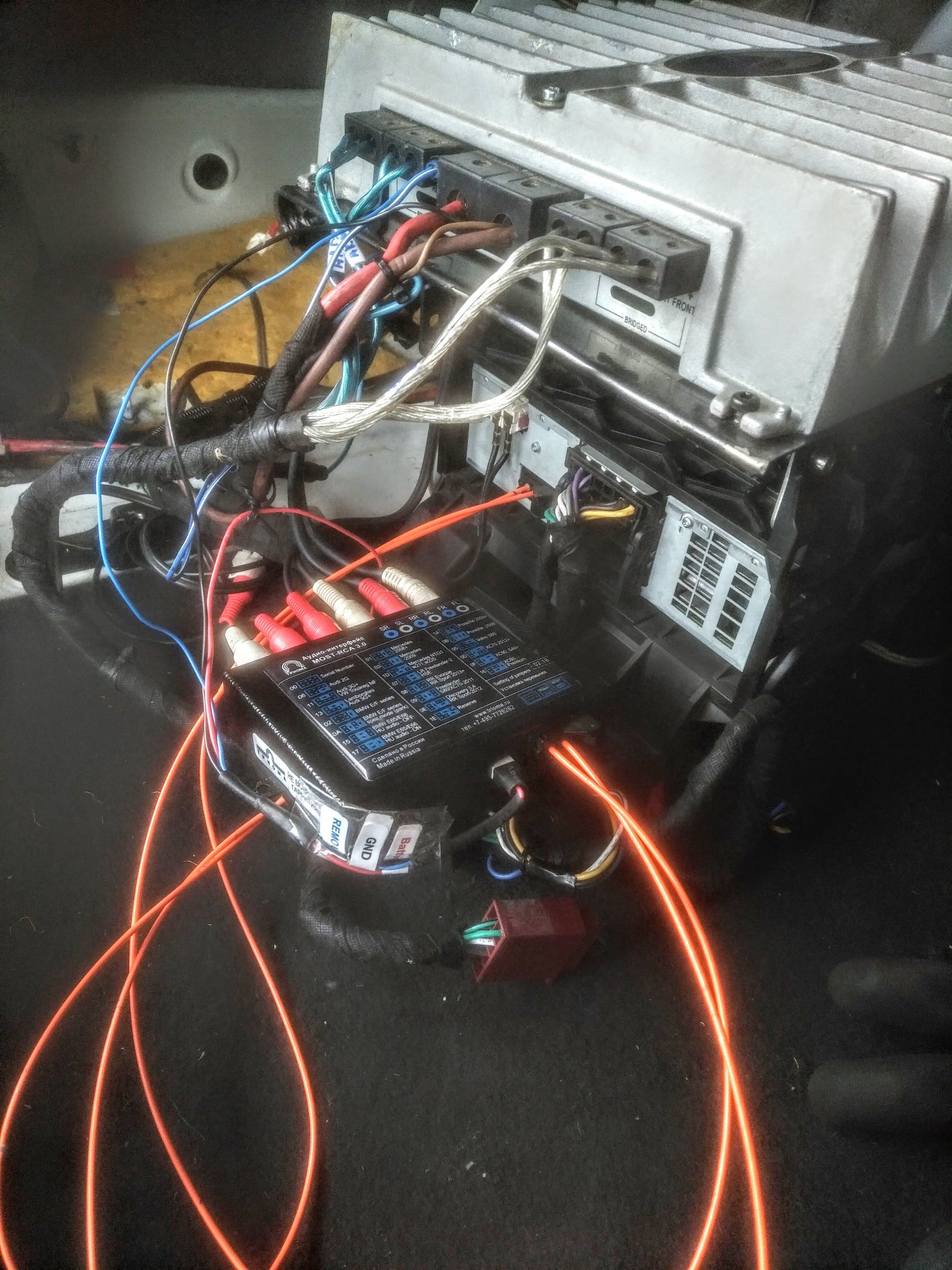

this amp only works with optical fiber (MOST) and there is also the audi component protection to be lifted
if you want to add an additional amplifier you need a MOST to rca converter example: http: //www.trioma.ru/wp-content/uploads/2017/12/instruction_most-rca2.0_eng.pdf
Maybe you are right. The control should be optical. Analog inputs are already available in Audi DSP T32h connector. Shame I can not control TDA 7566.this amp only works with optical fiber (MOST) and there is also the audi component protection to be lifted
to simply add an amp, use the hp output with ca: https: //www.focal-audio.jp/products/customfit/pdf/HiLoV2_technical-sheet.pdf
