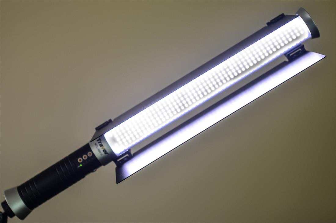

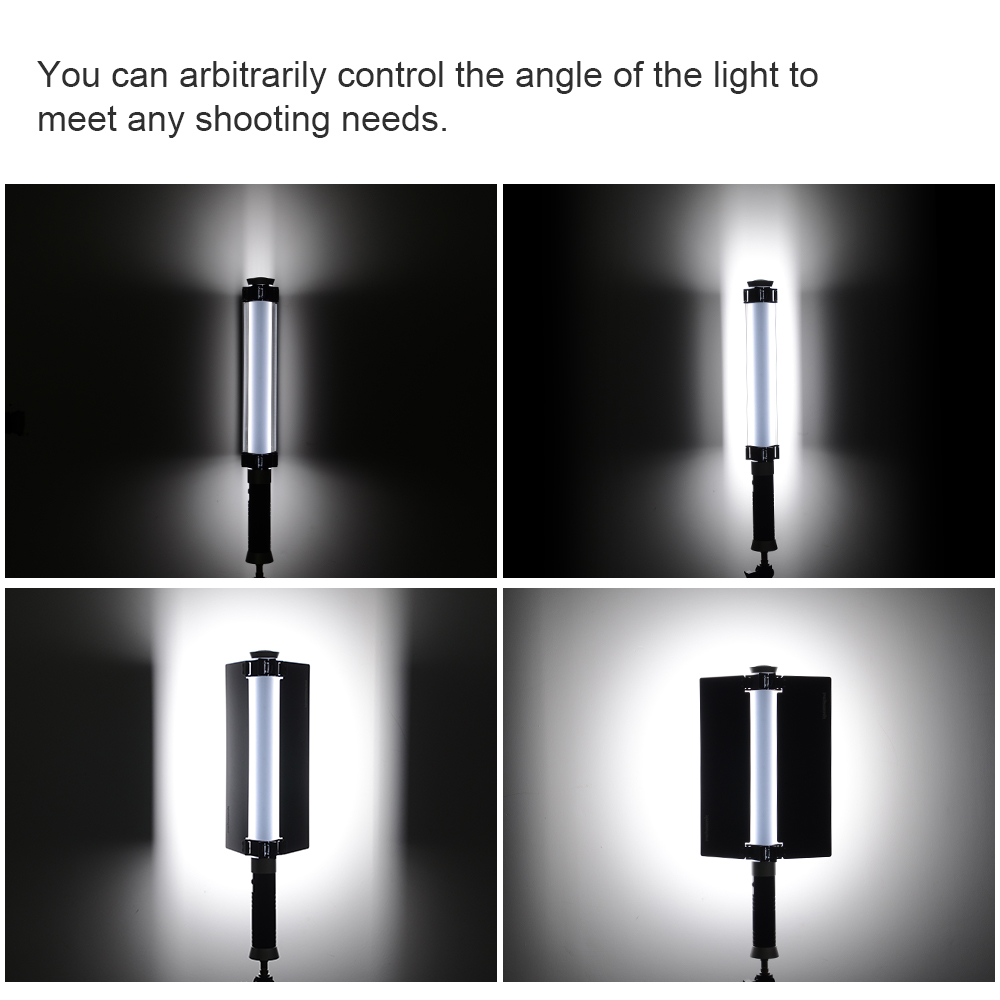

In photography we have barn doors for light to keep the light from spilling onto unwanted areas. With room treatment, we are trying to prevent sound waves from bouncing off the walls and too our ears, adding a delayed sound.
The problem I have with room treatment is the cost and aesthetics of it all. What if we could make broadband absorption "barn doors" or barriers for our speakers to reduce the amount of absorption/diffusion needed in a room. They would be placed so that the sound never makes it too that section of wall. It reminds me of a barrier for ambiophonics.
Is there any merit to this and has it been done?
...These are not my photos, so let me know if that is an issue.
