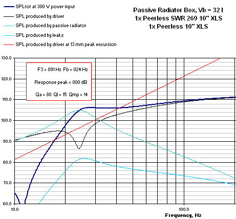

well i think that the better option for me will be to go with the xls10 and passive radiator, what kind of box would this design be best in and what sor of sizes am i looking for, i may be moving rooms soon so i may have more space to work with.

The beauty about the XLS 10" + PR combo is the tiny enclosure required: 25-32 litres or thereabouts. A search should result in many threads about this particular combo, and it's worth going through Peerless' application note: http://www.d-s-t.com/main/tech/appxls2.htm

So what sort of bass extension would the xls 10 + pr in a sealed enclouser of around 30-35 litres give me?

With BK's standard 265g PR in a 32l enclosure you're looking at a theoretical ~109db @100Hz and 3db down @27Hz where passive then exceeds excursion (and output also falls very quickly). This is before room gain. Two passives are better than one if you cann afford it. Download Unibox and you can model the 10" XLS and PR.
