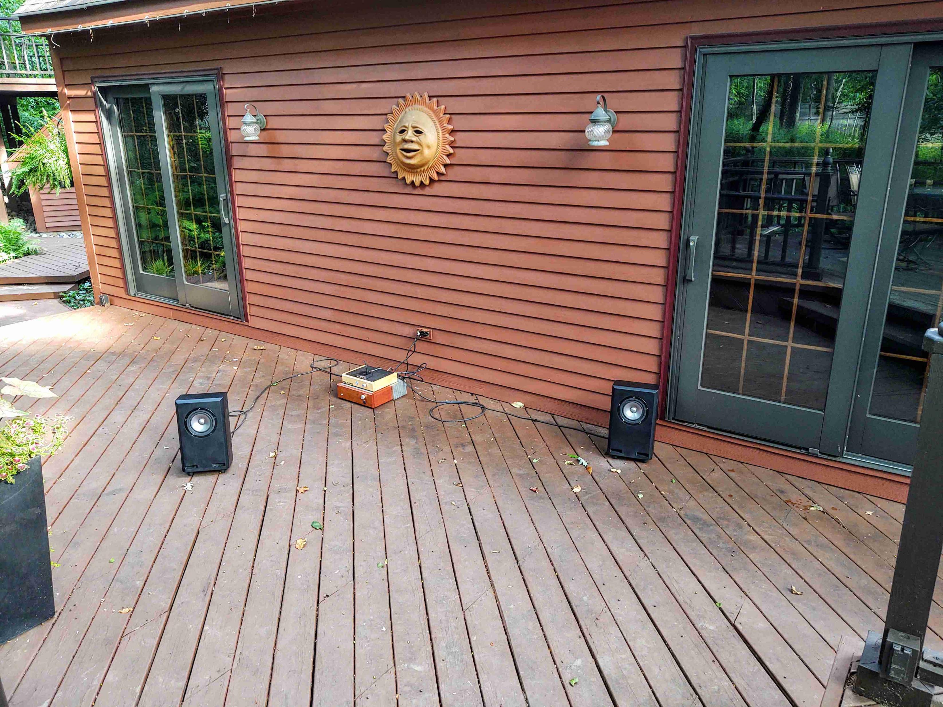

Ok, so I ran them 24/7 for a couple of days in my garage and finalized the bsc filter. They have improved a lot, but for my taste they needed the bsc filter to sound balanced, the final values that I settled on because that is what I had on hand were L=1.25mH, R = 10R, C = 2 uF. Nice bass with this box, mids are nice, highs are ok. Nice imaging as one would expect from a fullrange driver. All in all a nice speaker and fits the bill for what I was looking for, a small portable speaker for my deck. They crush any boom box. Here is a pic from last night during their debut, bluetooth to an old SUBBU dac to an even older MyRef C chip amp. Old diy projects never die, they just go into storage, its nice to use them again.
