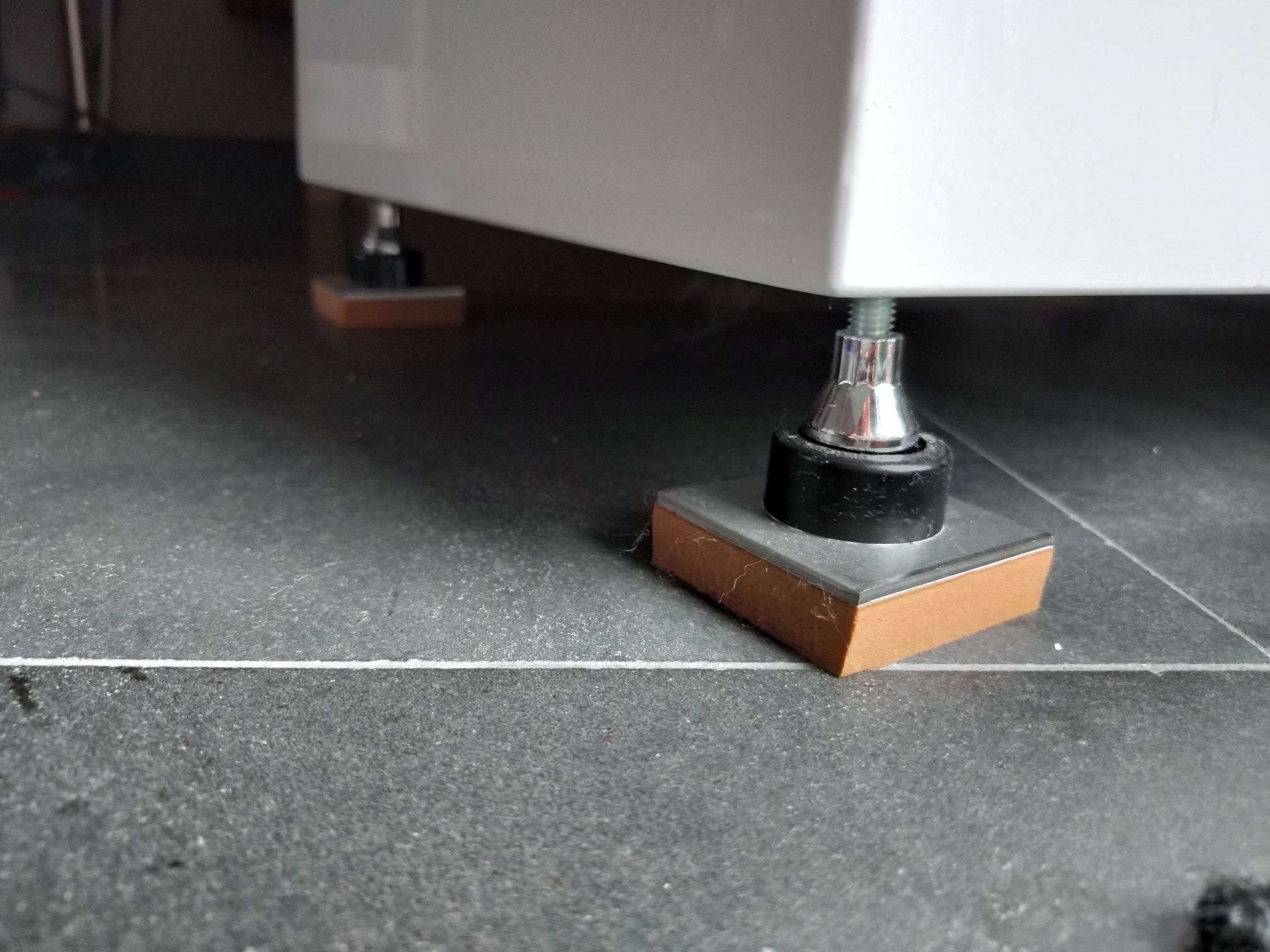

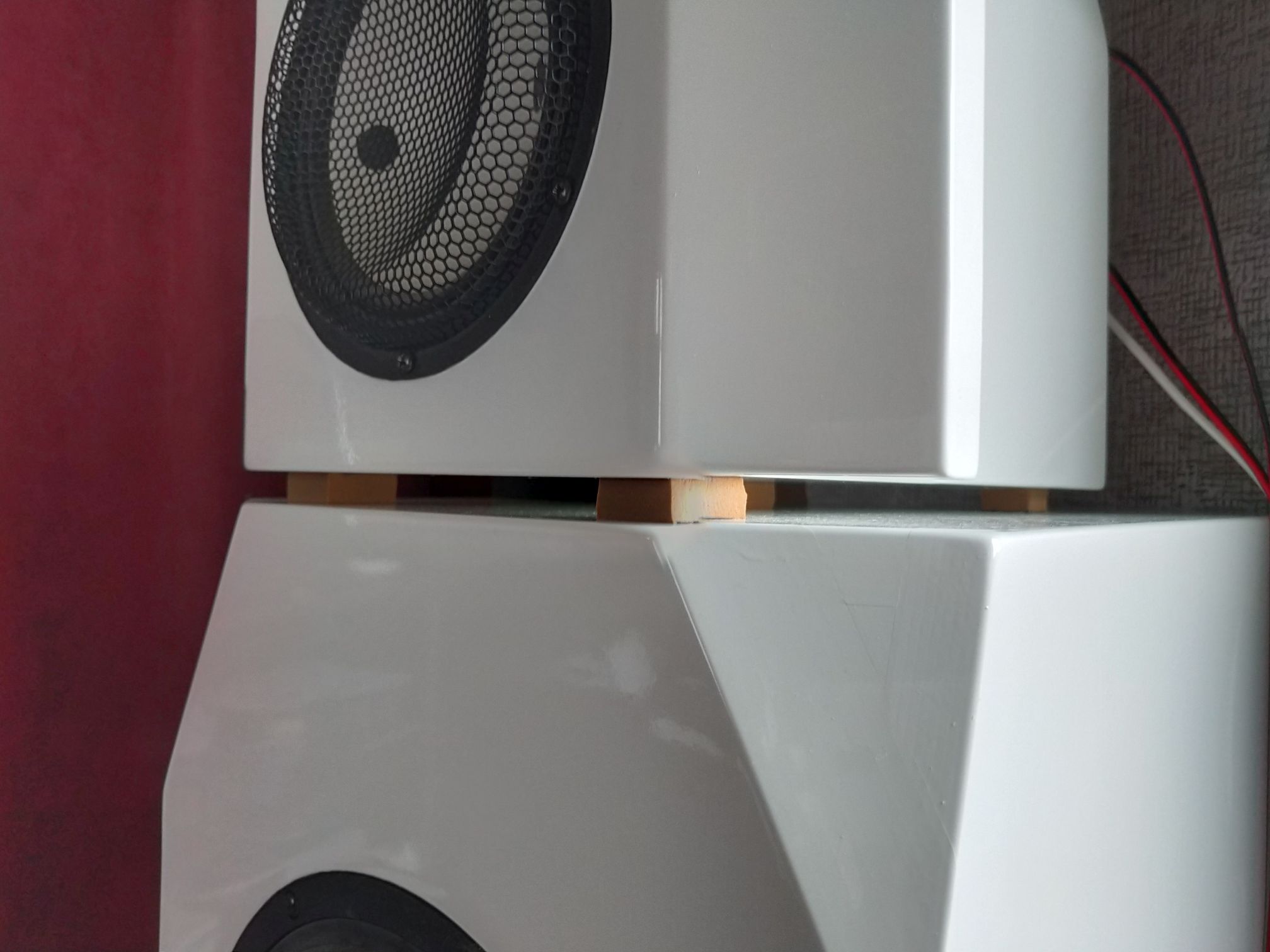

For my speakers I use the brown SR110 that works optimal with a pressure of 0.7kg/cm²
Danny

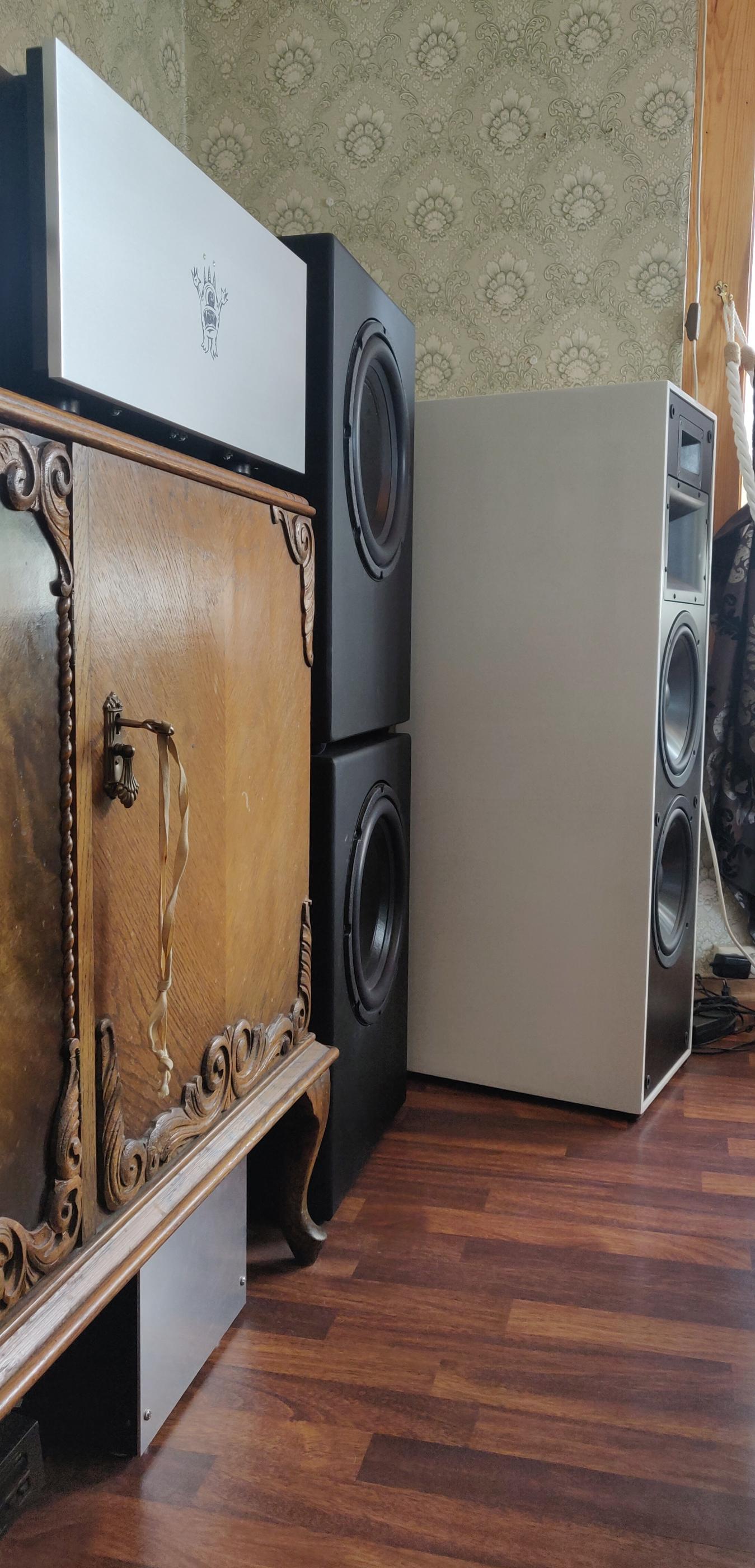

You can buy Sorbothane feet with different stiffness and use the stiffest in the heaviest end.
I use the same stiffness in all 4 corners on my subwoofers and speakers. They are very stable and I haven't noticed any tilting.

Sylomer is a high quality polyurethane foam ...
I use it since two years for all vibration absorbing: speakers, amplifiers, transformers, ...
It's 100% safe for wood, it leaves no marks and is stable in time.
It comes in 10 different stiffness/load
For 100kg(220lbs) in SR110(0.7kg/cm²) you need 142cm², that are 4 pads SR110 of 6x6cm for each speaker.
