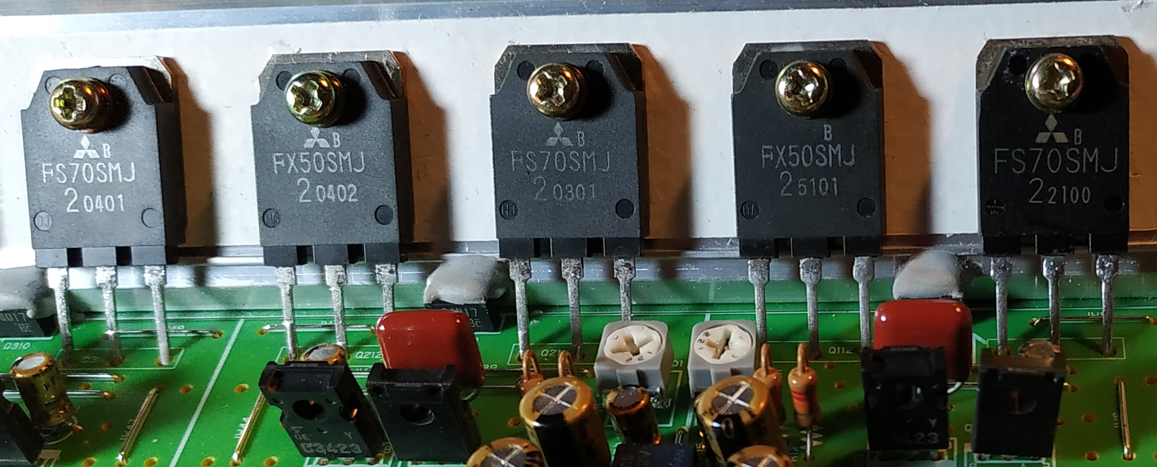

Probed all output Mosfets in circuit, no shorting or open circuits. I did however notice neither of those chips looked exactly like the others. See photo at the end. (The legs seemed off, the fonts were different, and one was missing the Mitsubishi logo all together.)

2. From the photo of the outputs, the FL channel (the two furthest right devices) have been changed at some point.
3. From research, the output devices, FS70SMj and FX50SMj are hard to find, therefore these are likely counterfeits.

The photo of MOSFETs are lit to show the lettering and leg details.

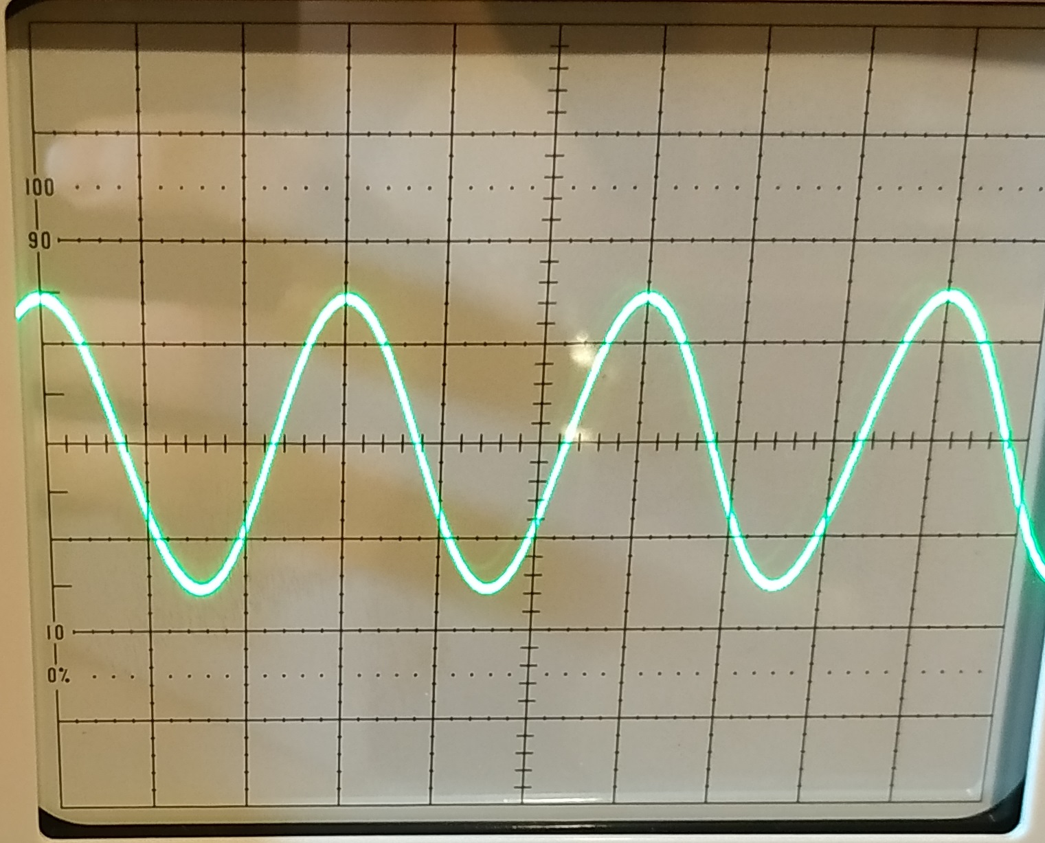

The photo of a clean signal represents what the FR, RL, RR, and subwoofer channels produce. This exact photo is of the FR channel at identical gain, input voltage and scale of the FL channel.

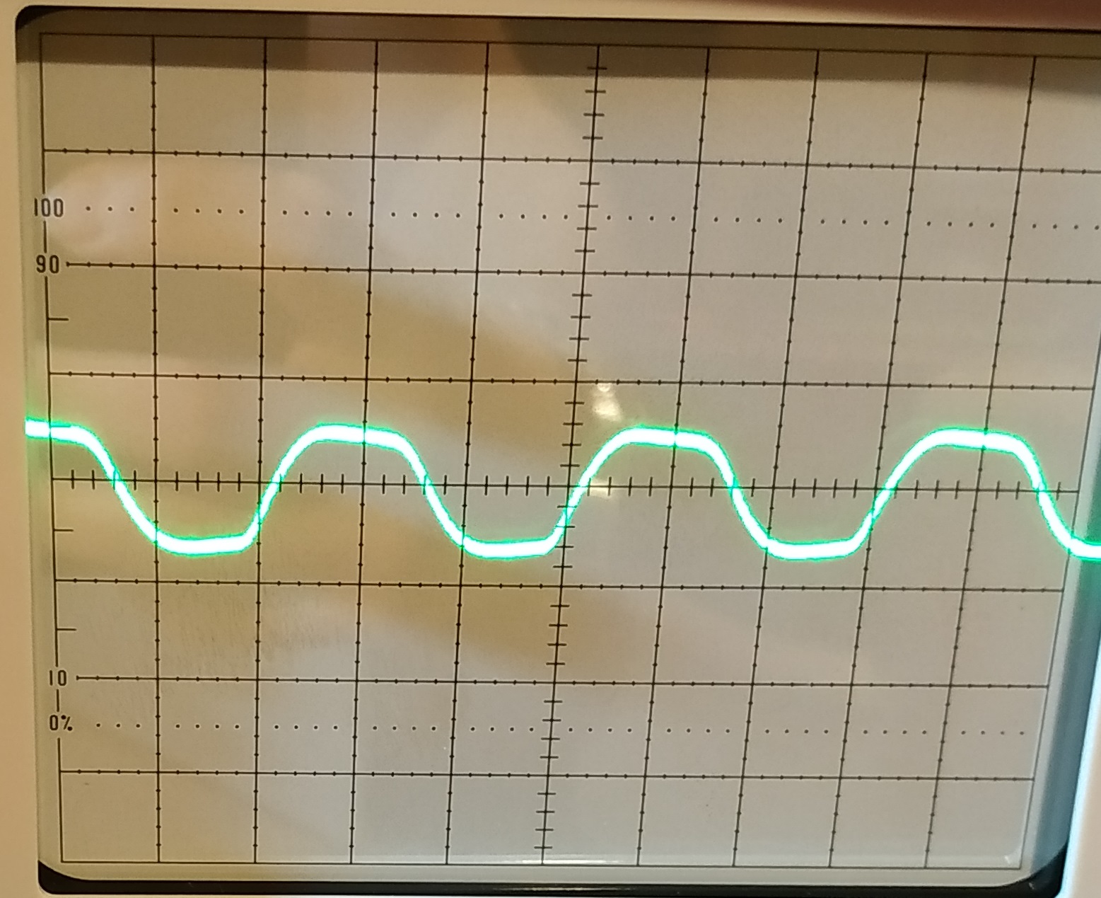

The photo of a clipped, distorted signal are the output from the FL channel. identical. It makes me think I should monitor rail voltage at the legs...
For Both traces, Vertical: 0.5[V/div] Horiz: 0.5[msec/div]

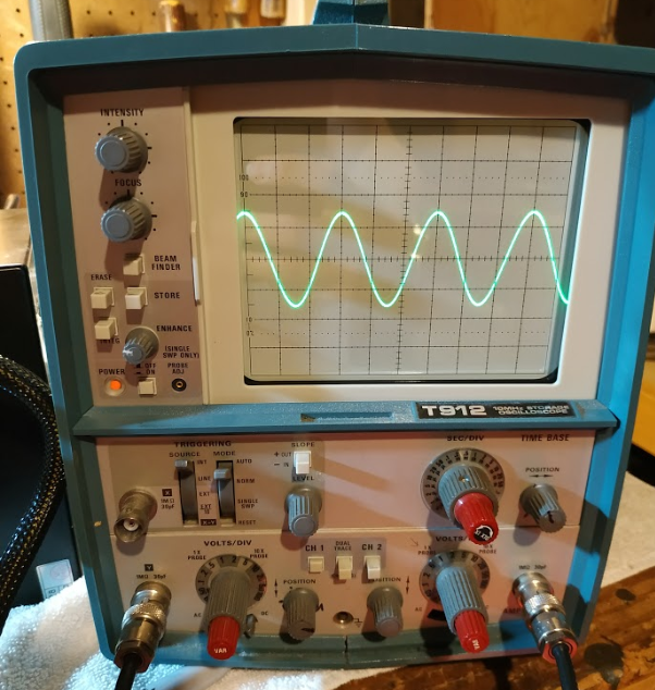

5000 series tek scope?
The rail voltage may be an issue but the fact that the top isn't clipped squarely could mean that the problem is a weak drive signal or even preamp level problems.
the scope is Tek, but it is a T912 hoover style. Its a relatively new addition to this addiction 😎. I had it apart last week and forgot to put the blue display shield back in place. Let me upload the un-cropped photo...
