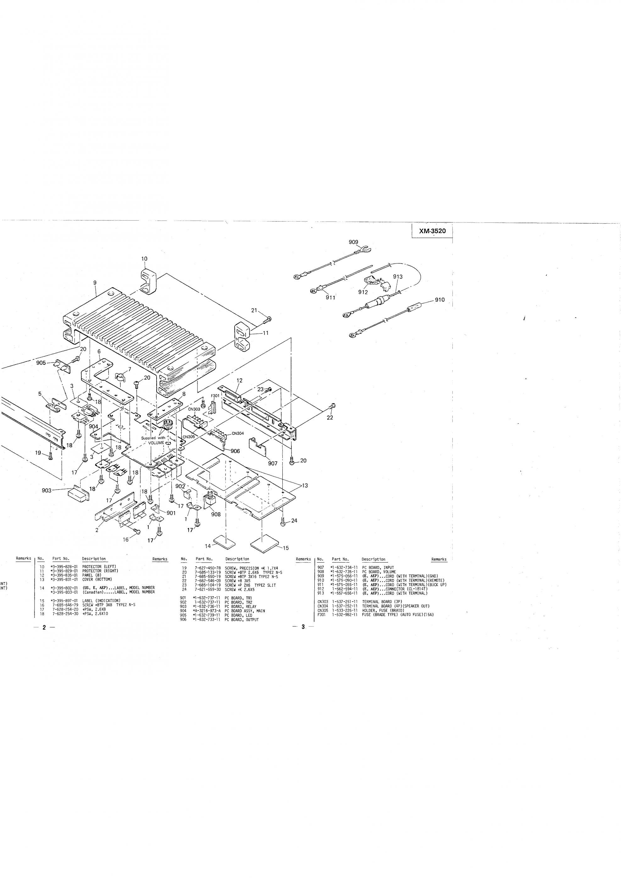

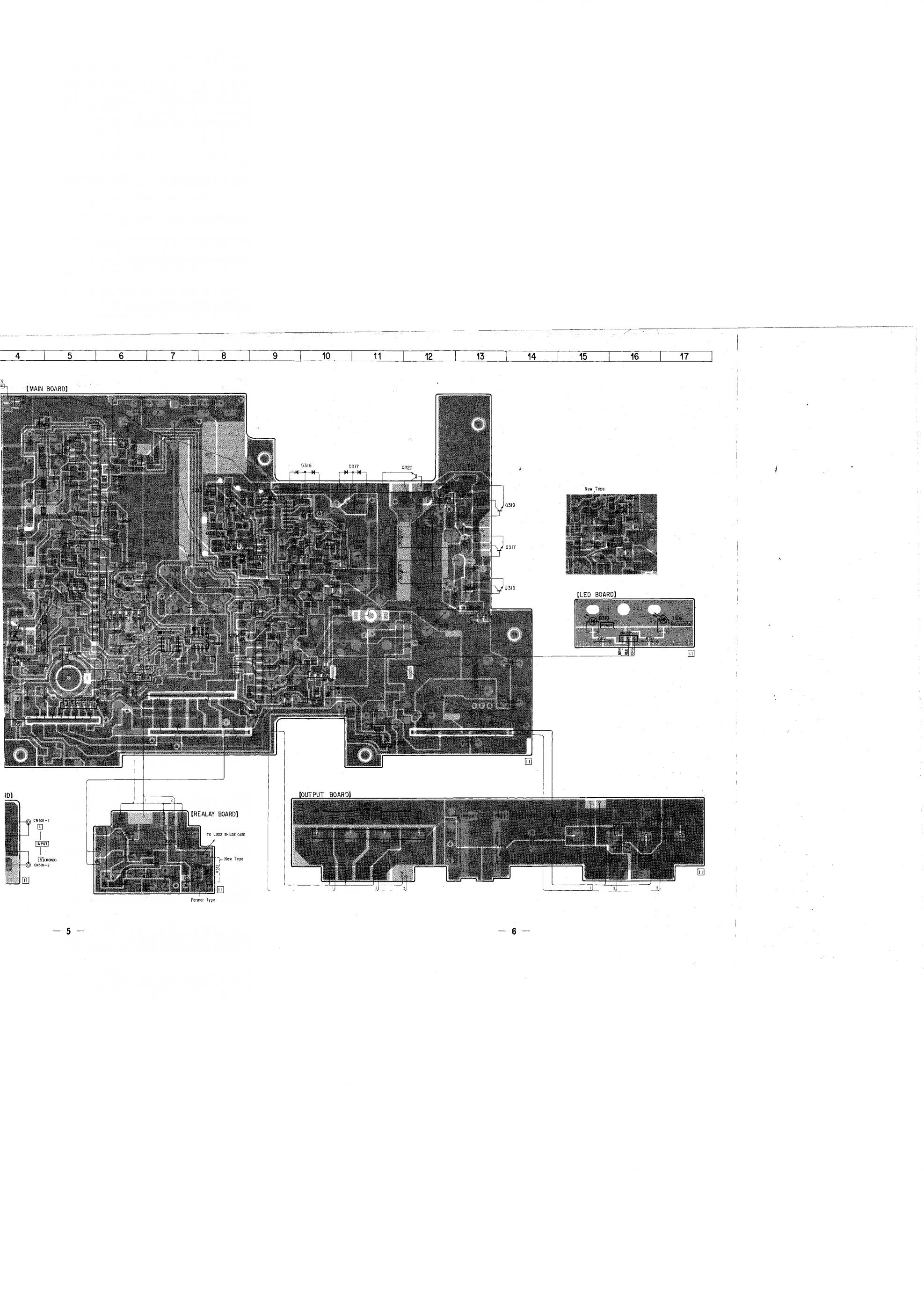

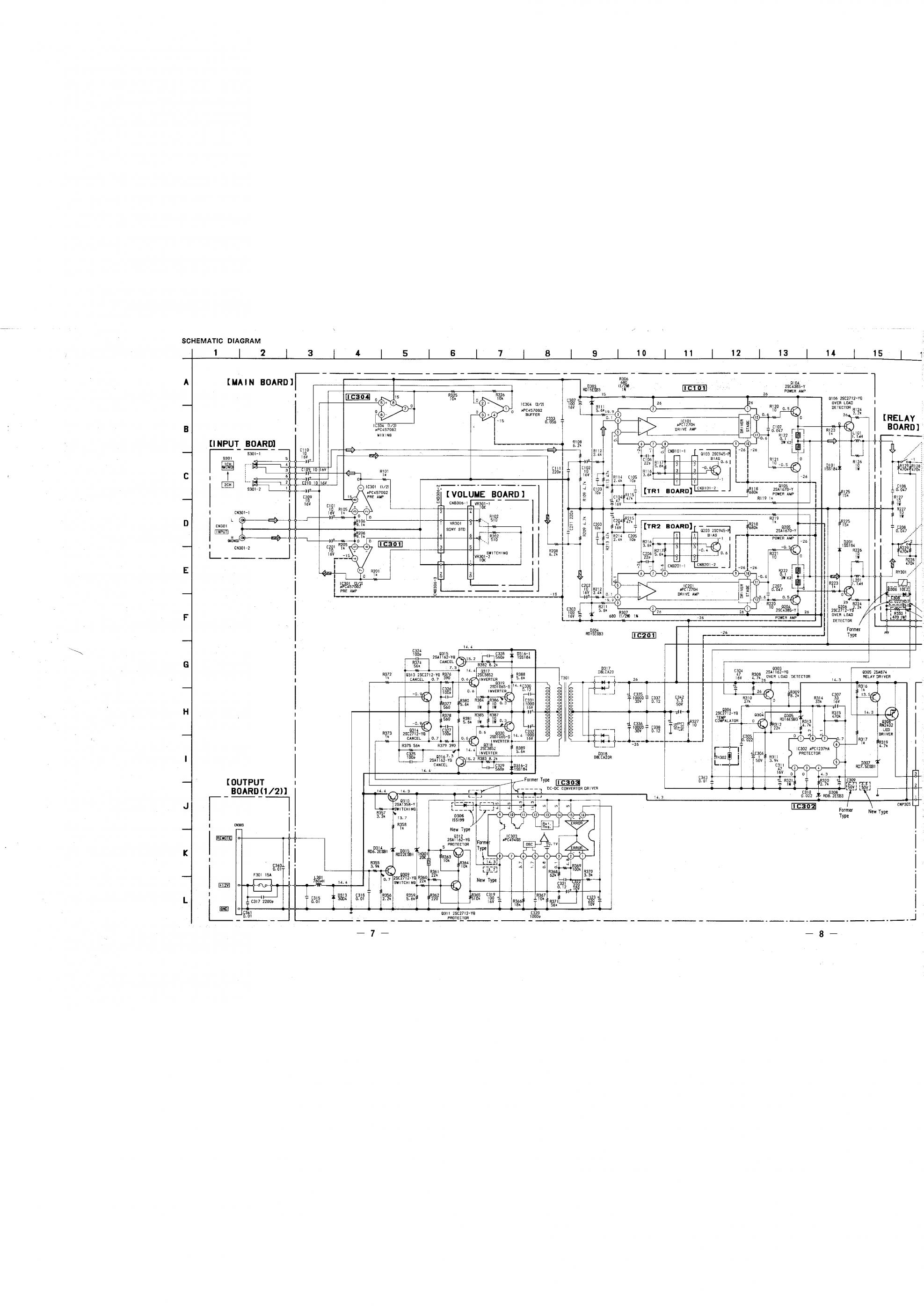

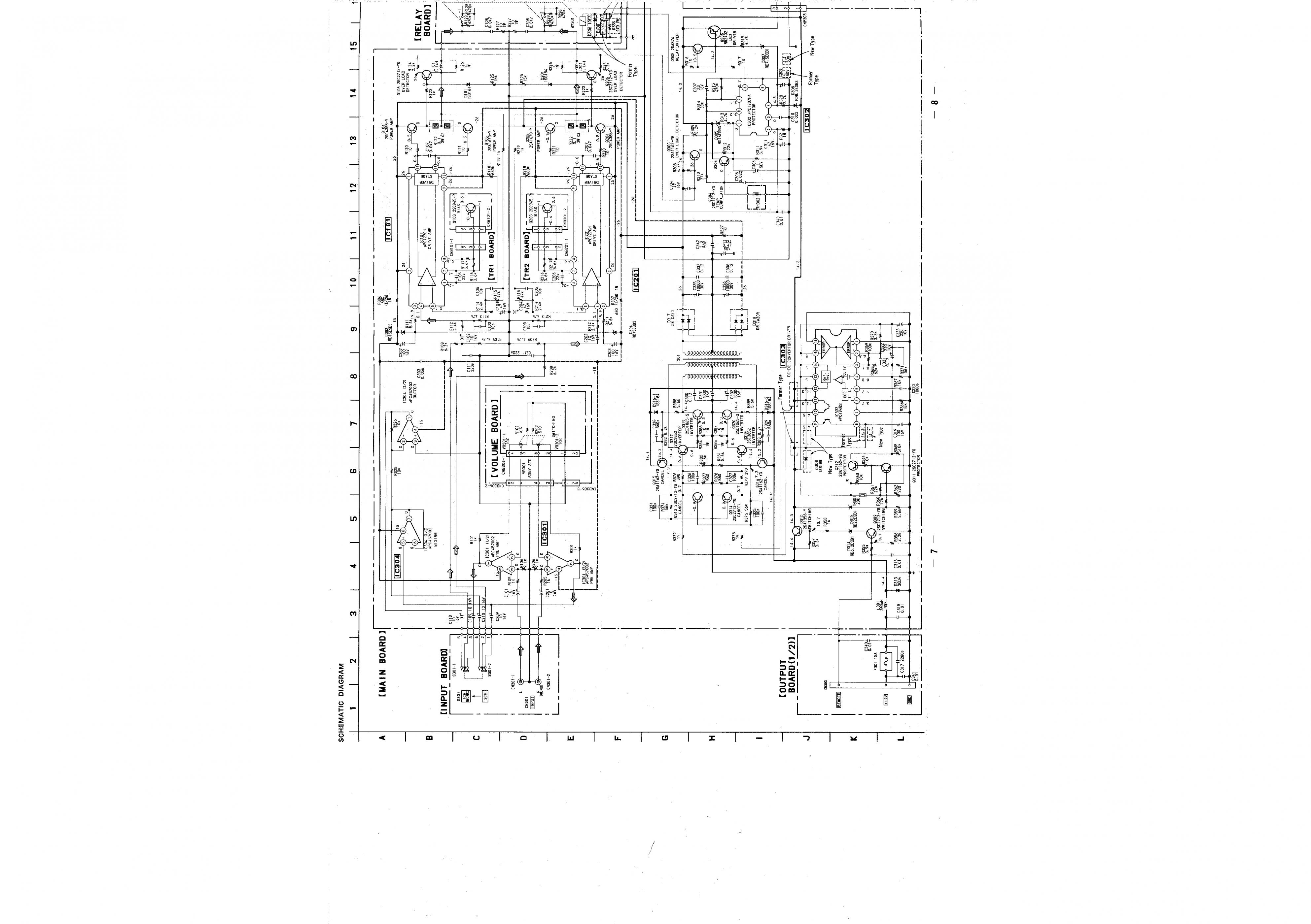

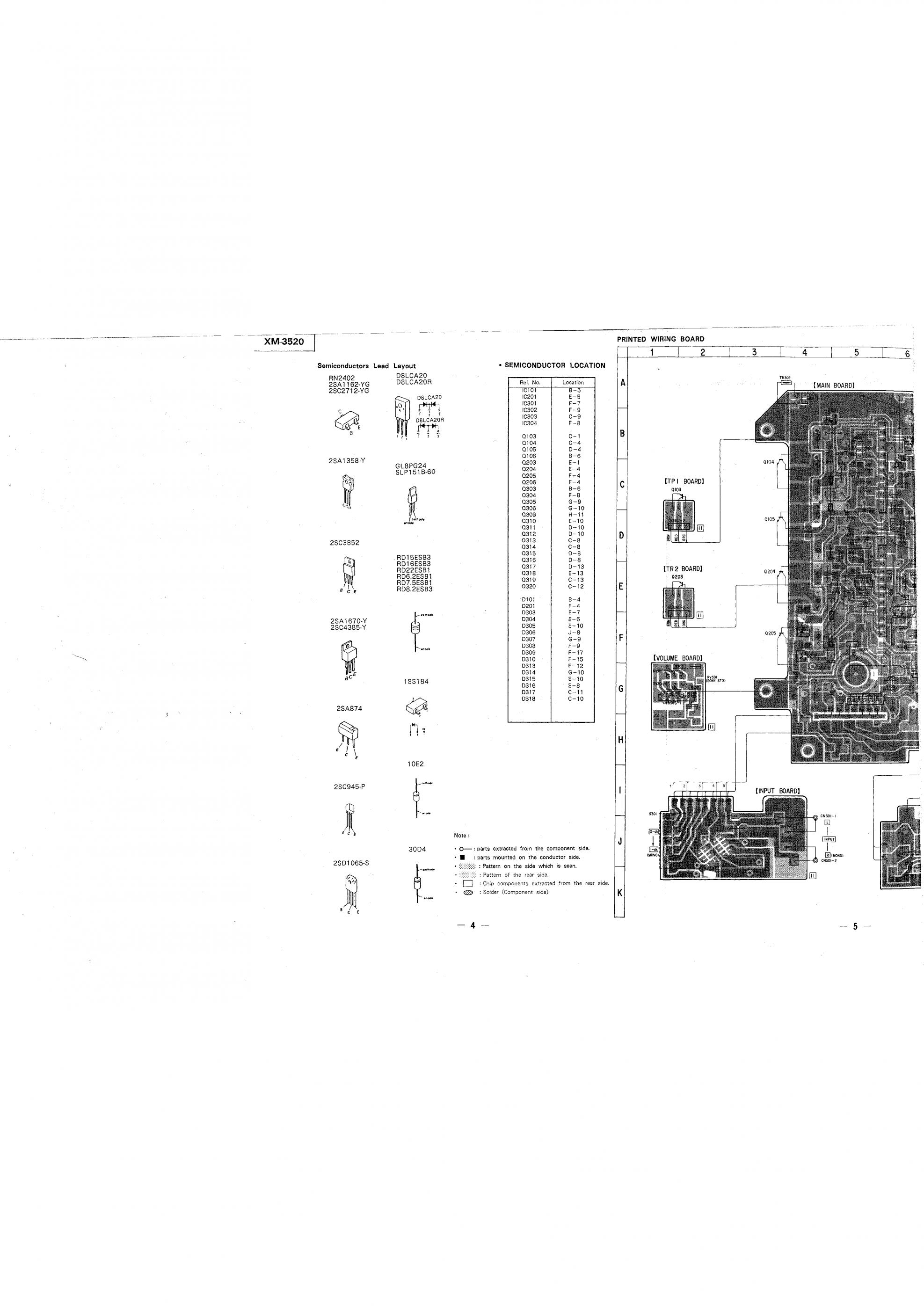

here is what I could find. is it enough?

What is the DC voltage on either terminals of L101 with the amp powered up and all components installed?
DC voltage on collector legs of Q104 and Q105?
