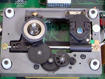

Hi
I understand the KSS 272A laser unit is -since a long time, not available anymore.
Anyone having succed finding any eqvivalent unit, or tracking/changing the diode successfully?
Please I need advise what action to take
Brgds
P

The KSS272A (= 884824411 = KSS-272A) is inside there:
SONY CDP-X339ES, CDP-X559ES, CDP-X303ES, CDP-555ESD, CDP-505ES,
CDP-X707ES, CDP-X505ES, CDP-777ESJ, CDP-555ESJ
ACCUPHASE DP-65, DP-75, DP-65V und DP-75V
(DP65, DP75, DP65V und DP75V SONY CDPX339ES, CDPX559ES, CDPX303ES, CDP505ES, CDPX707ES, CDPX505ES, CDP777ESJ, CDP555ESJ, SONY CDP-X 339 ES, CDP-X 559 ES, CDP-X 303 ES, CDP-X 707 ES, CDP-X 505 ES, CDP-777 ESJ, CDP-555 ESJ SONY CDP-X339 ES, CDP-X559 ES, CDP-X303 ES, CDP-505 ES, CDP-X707 ES, CDP-X505 ES, CDP-777 ESJ, CDP-555 ESJ SONY CDPX339 ES, CDPX559 ES, CDPX303 ES, CDP505 ES, CDPX707 ES, CDPX505 ES, CDP777 ESJ, CDP555 ESJ).
But not inside by x5000 (CDP-X 5000) !!

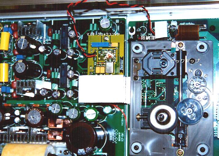

Well, received the SONY cdp-x5000 player today from Singapore. After cleaning and removing dust and changing the small switches on the keyboard printed circuit board (probably corrosion, high humidity in Singapore) I cannot make it to fail on reading the disk. It works absolutely perfect. If you have problems reading the disc I would recommend the procedure mentioned earlier. If you open the top cover of the player (careful with the cabling) you will see three plugs with no connection on them in front of the drive. CN513 CN514 and CN515. Unless you are used to handling a soldering iron I would advice to find a plug that fits in the three pin CN515. Solder pin 1 and 3 together on the plug or put in an on/off switch for future use. (very handy). Turn off the power. Put in the plug or press the mounted switch. Insert the YEDS-18 and read the Table Of Content (TOC). Turn off the power. Remove the plug or turn switch off. The data has been saved in the small chip you see connected to pin 19 and 20 on controller IC201. One line is the clock an the other is data. I suspect this would calibrate the laser for mechanical wear/aging ?. I also suspect that the TOC of any CD would bee sufficient for this procedure but of that I am not certain. GOOD LUCK. I will post any information here that comes to my knowledge that would be of interest
Well the cdp-x5000 has started to skip when it is cold. During this cold winter i have had this problem repeatedly when the player is cold. When the player has been turned on for half an hour or so the skipping stops. I have reason to believe that it is the lubrication of the sledge carrying the cd/spindle motor that has dried up over time or that the electrolytic capacitors on the power supply feeding the sledge motor. (may be ripple on the voltage caused by dried out capacitors ?) I will take it apart and report back information of interest. Absolutely a wonderful player by the way.
Absolutely no ripple on the voltage feeding the sledge motor. Tried two very very tiny drops of a very sticky bicycle chain oil on the sledge guide. That cured the problem. My advice is: Try to find the right lubrication/grease. This player need a different damping of the movement of the sledge, because of the weight of the sledge plus the spindle motor. The friction here is crucial for the correct function of the player. Good luck.
Hello Dacen,
is the skipping problem cured until today? I have the very same problem, not very audible, because error interpolation does a good job here.
I used some grease (Judy Butter, for lubricating bike forks or bearings) years ago. I do not know, wether the problem existed before, because I found out maybe 2 or three years after buying in 1997.
Also the CDP X5000 does sometimes not start, when the lid is closed. This problen was from the very beginning
Replaced the lid switch, but only with little improvement.
All the best,
Salar
All the best,
Salar
Yes the skipping problem is cured. The start up problem is something I am experiencing as well from time to time. Have been trying to look into the reset circuits of the chips involved but I have not been successful so far. I will certainly advice when I find the right solution. If you need the service manual for the x5000 I will send it to you, just let me know.
