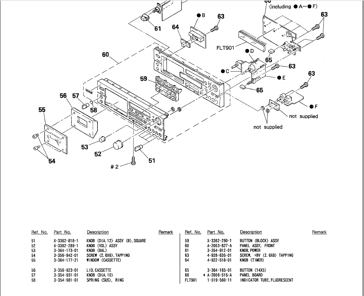

If you mean the service manual of TC-K770ES, I already have it, but honestly I haven't red it yet. I presume the "mode switch" i position 59 on the attached prtscrn. Is that correct?
