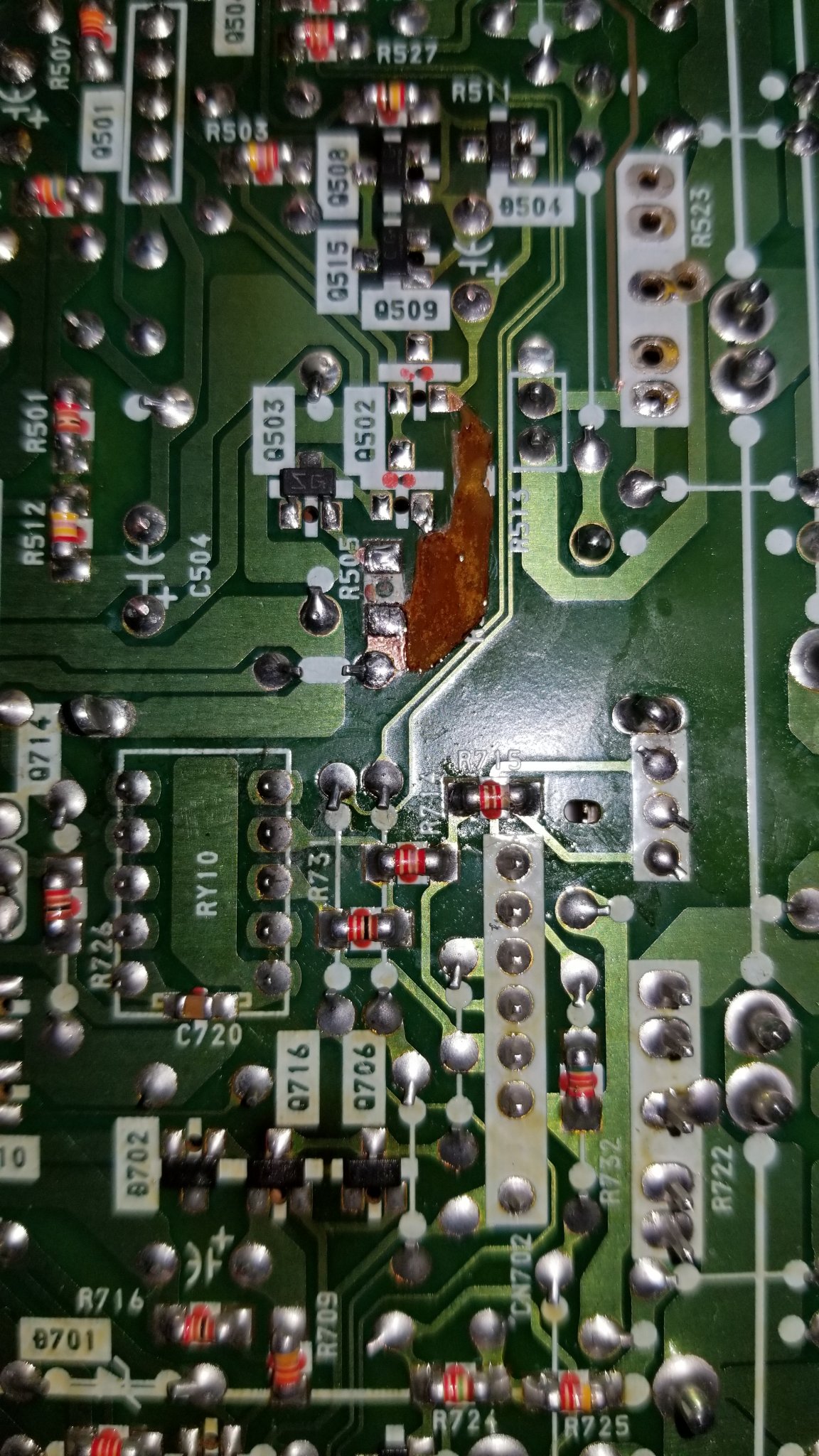

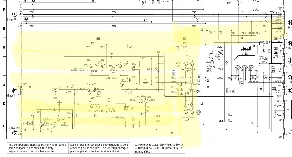

I am in a process of repairing my Sony TA-N9000ES amplifier. I am familiar with electronic, but my skills and experience with power amplifiers are very limited. I hope to receive some advices. A few words on how it failed.
It was a daily use amplifier. Just mid range volume, 8 ohms speakers. I noticed no sound coming out. Checked the amp, it is in protection mode, blinking LED. Turned it off with a power button, after a 20-30 seconds turned it back on and... enjoyed a fireworks with lots of smoke.

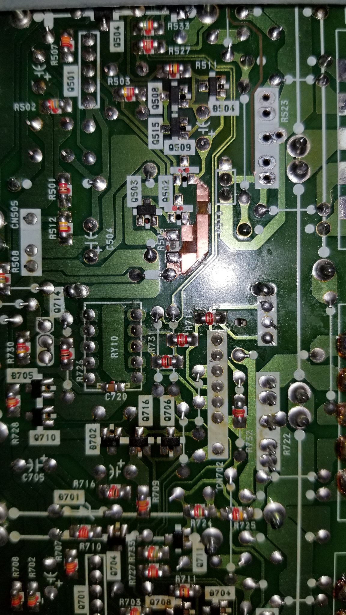

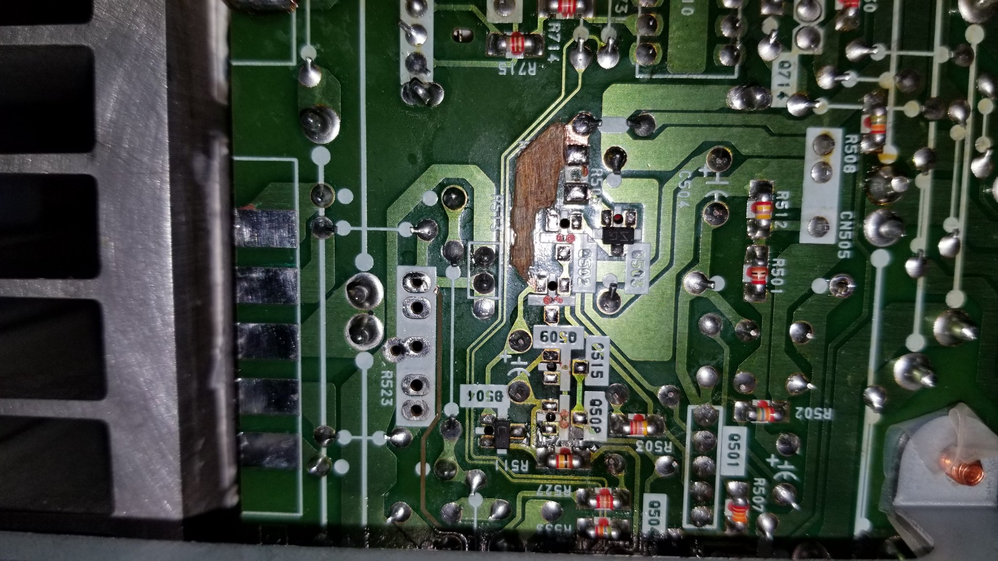

After opening it up and brief testing found positive voltage on center channel output. Static component testing showed that most of the components in this channel failed or evaporated, taking out some of the board traces. Did lots of cleaning.... ! First picture shows schematic with failed components in red circles. Second picture shows the worst burned area, in addition to a few more traces just disappeared.

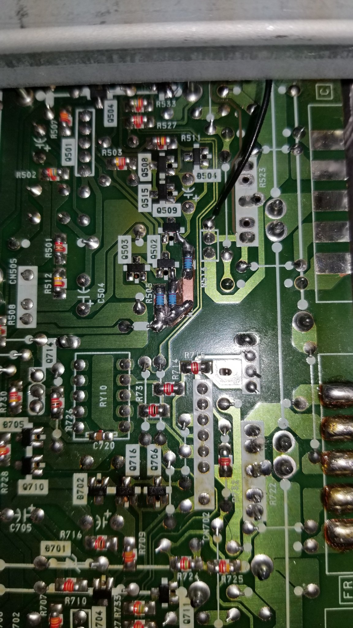

I have removed all failed components, repaired the burned area and reinstalled all the components. Ordered most original from Mouser.

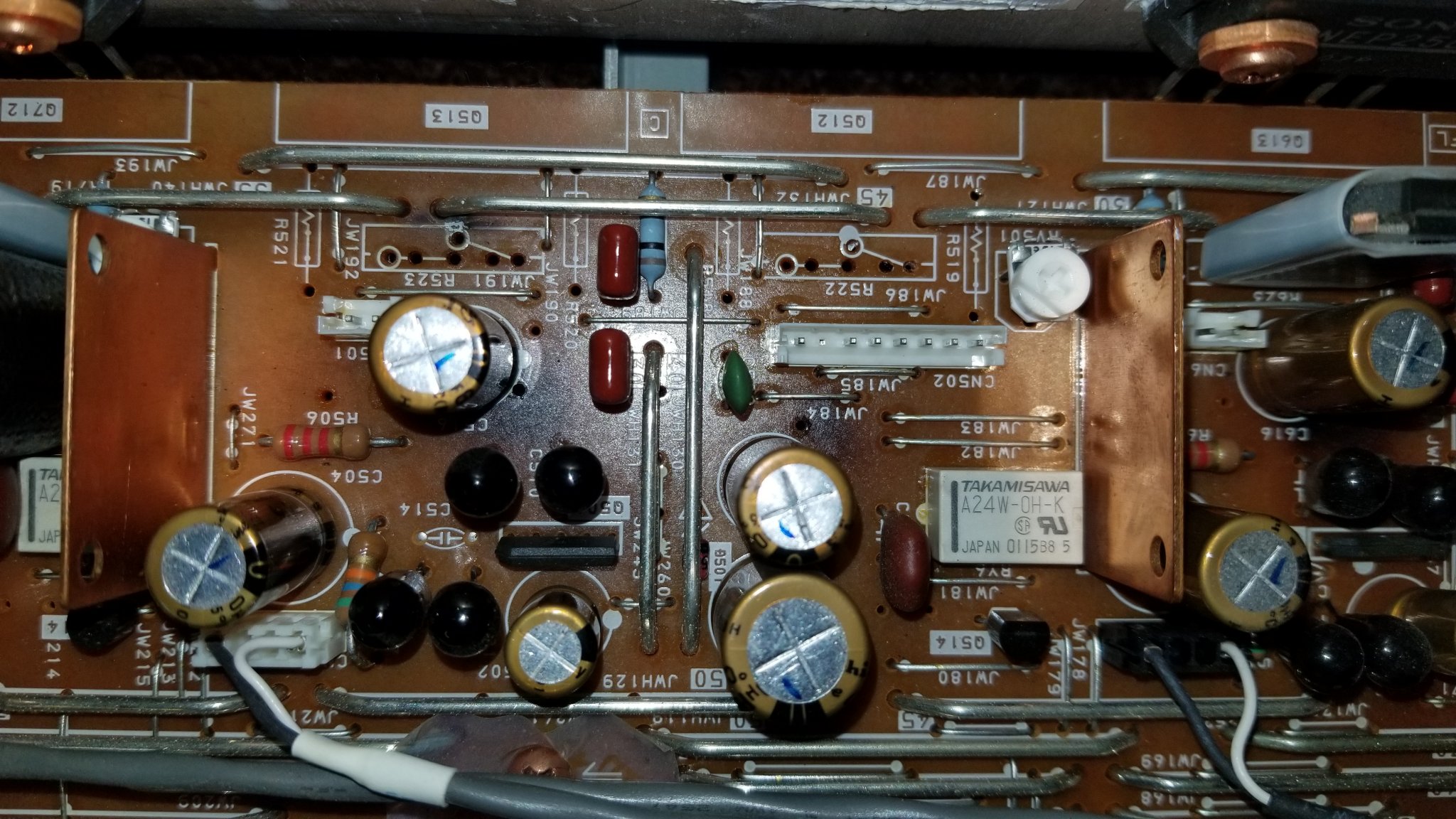

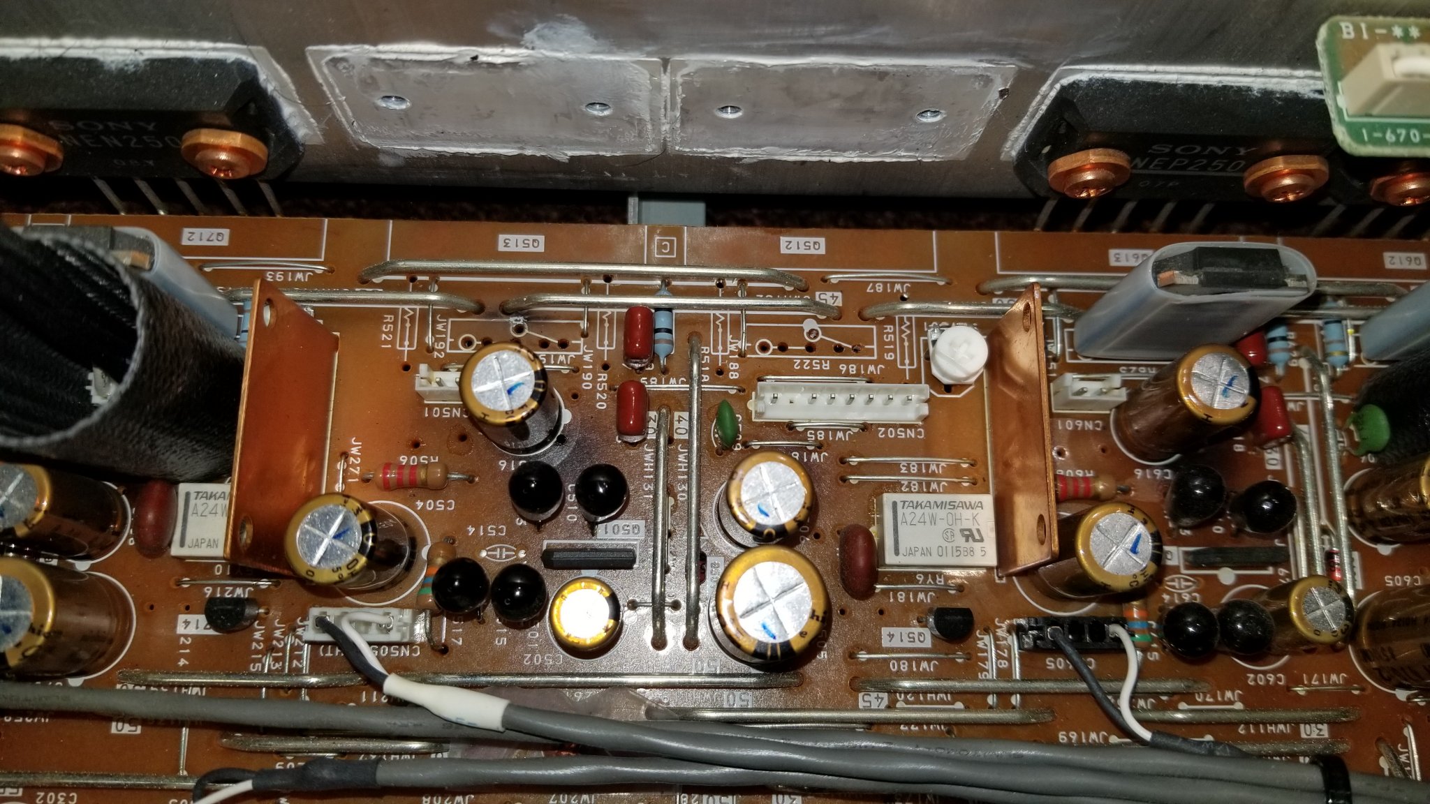

A few picture from the component side with removed failed components.

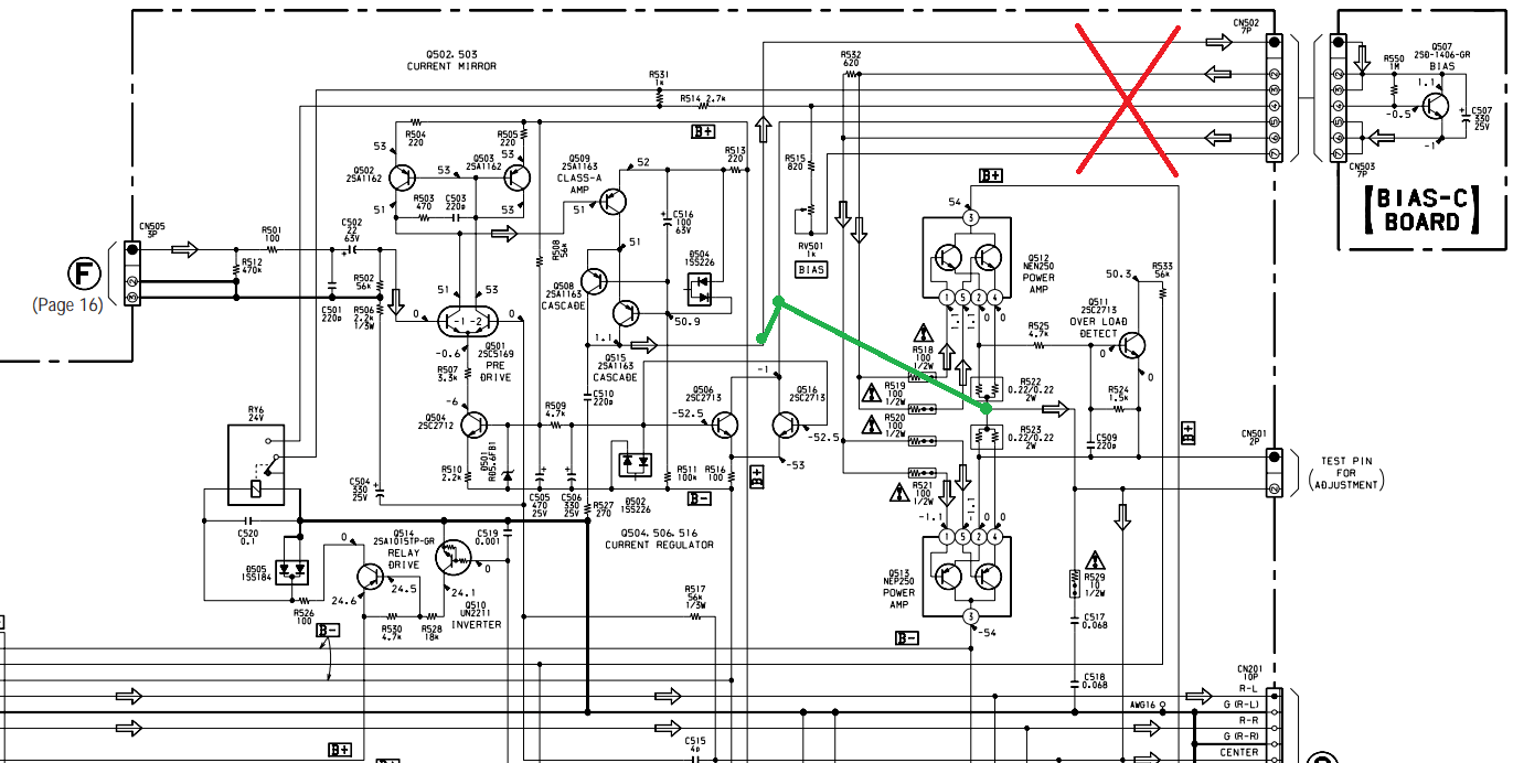

What would you think about doing something like that - disconnect the bios board, connect collectors Q508,515 and Q506,516 with the output to complete the feedback, and debug the channel with no output transistors. I am just brainstorming.

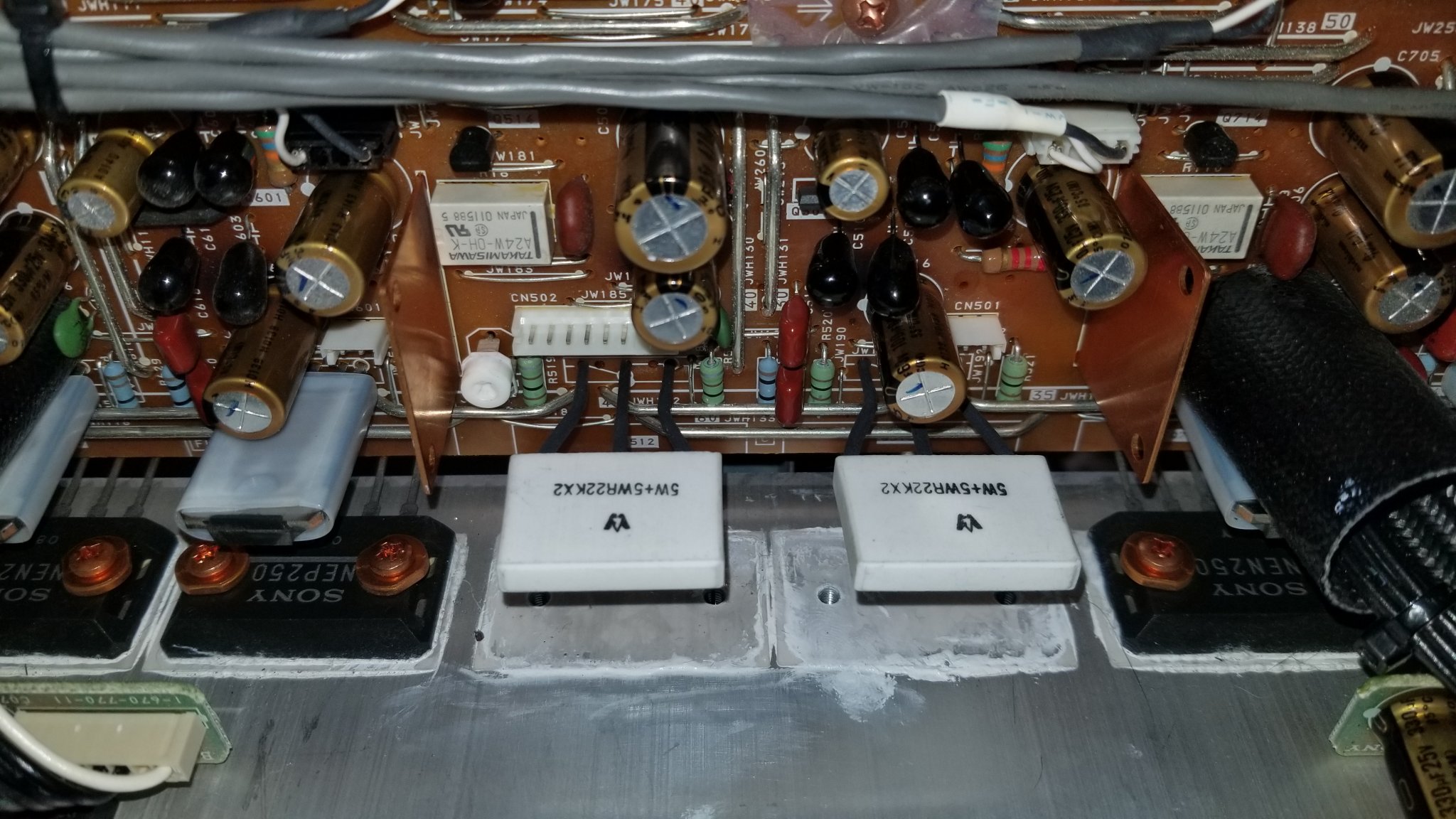

I have received all the parts ordered. Mounted output stage transistors, soldered in 2A fuses on B+ and B-. Double checked all elements and traces on the board. Used a bulb tester for start up. So far so good. Checked for bias in all channels on test pins - between 20 to 70 ma. Should be 11ma on 8 ohm load. Adjusted. Checked for DC offset - repaired channel 20 mv, all other between 1 to 5 mv. Definitely higher, however no adjustment on the board. Will concentrate on it.
Ended up replacing a differential pair Q501. The dc offset went down to 4.5 mv. Sounds way better. Now I have five channels with a dc offset between 0.5 to 4.5 mv. I would appreciate any opinions on that.
Can I modify an original design to implement a dc offset adjustment to get as close as possible to 0 v?

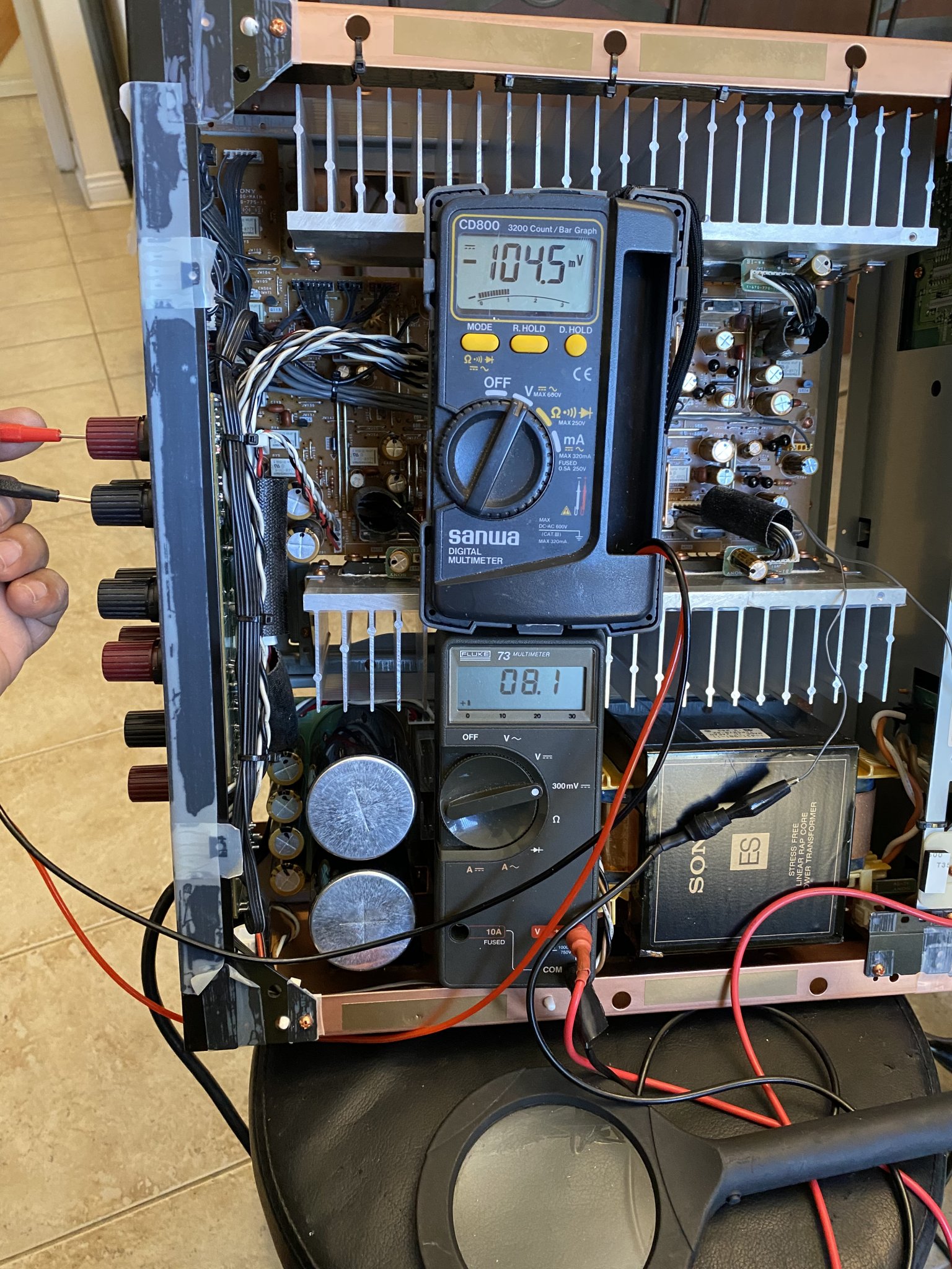

I adjusted the bias to 8mv for all 5 channels. I checked the dc offset on all 5 4 were within 5mv or less, but the Front right one was at 104mv.
I tested all the resistors,
transistors (diode test method) and diodes on the FR section and pulled Q701 2SC5169, tested on dca75 the center pin is the common emitter btw, it tested good like HFE for both was within 1%. Anyways I swapped it the one from Q501, same thing dc offset read at 90mv. It’s still safe for use but I’d rather get the dc offset of FR close to zero.
any ideas on which components I need to check and test?

Hello PineappleDave. 90 mv could be a little higher then desired. In my situation I have replaced every transistor and diode but Q507 - it tested good and it would not affect the dc offset. You mentioned that you tested all the resistors and continuity - done, swapped the diff pair - done. Testing transistors and diodes in diode test mode gives a good idea but they still could leak, and that will affect the dc offset. Faulty electrolytic capacitors could affect the dc offset too, in my opinion. At this point I would replace all the transistors, but power, and two diodes. They were very inexpensive to purchase and easy to replace. Swapping SMDs is a pain. Hopefully it will help. Please keep me posted.
