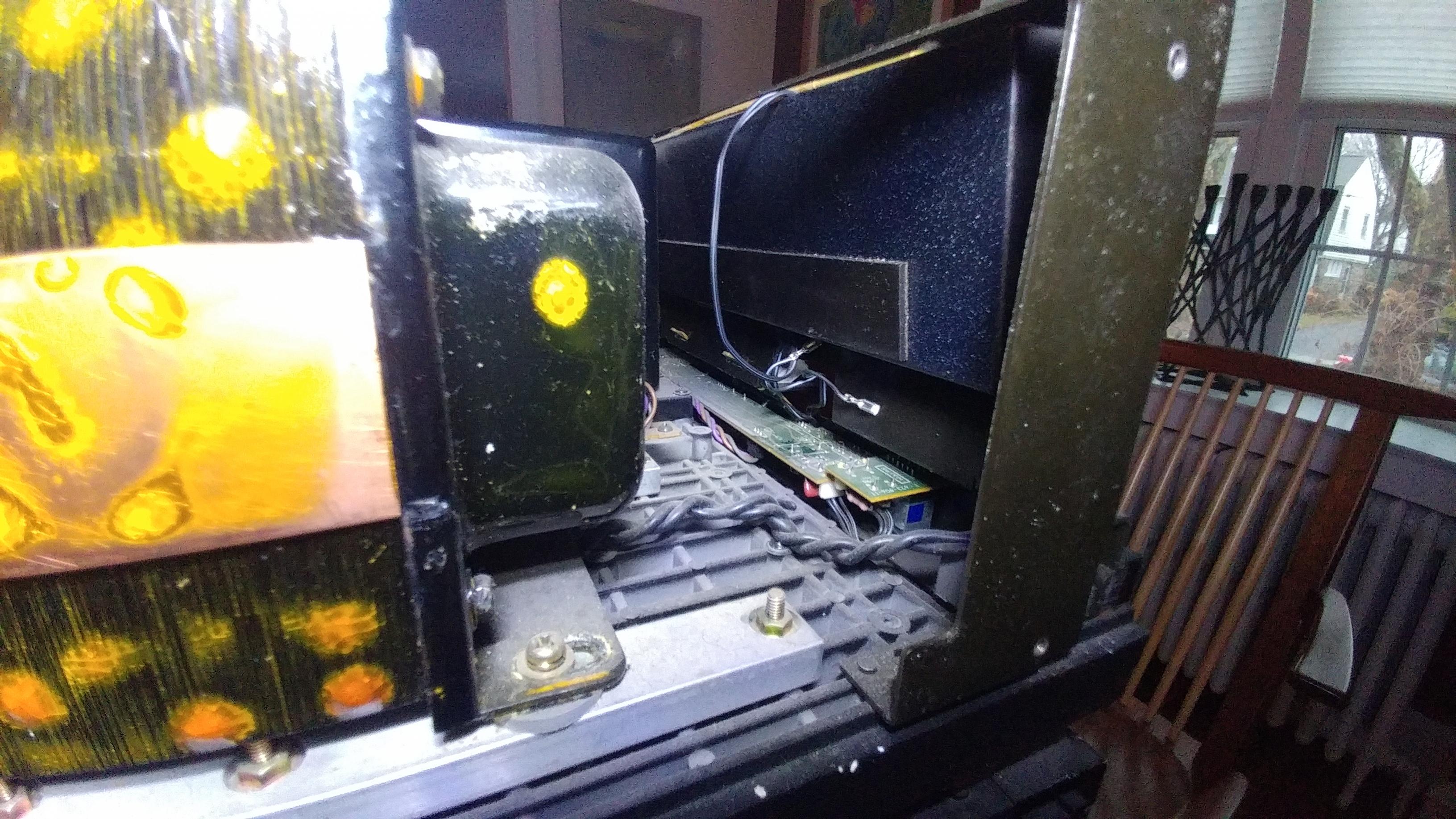

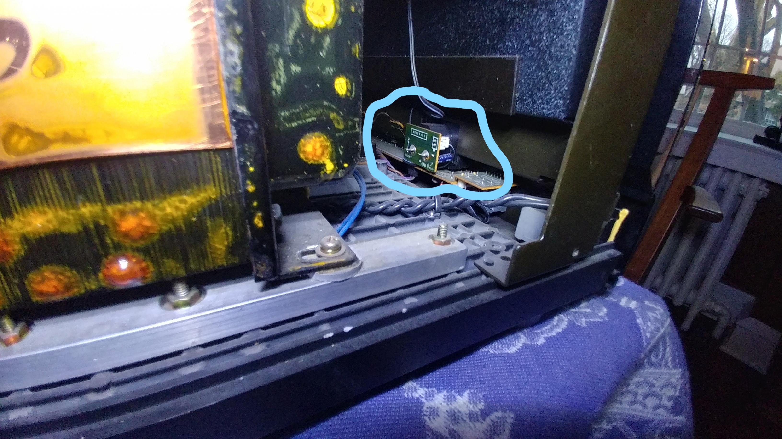

So I have two of these great amps, and I opened one up to replace the lamps. Lo and behold, there were two wire connections leading to nowhere. So I opened the other unit, which is working fine, only to see a daughter board that is missing from the first.
Does anyone have any ideas? If I need to replace this to get the lights working, anyone have a sense as to where to go?

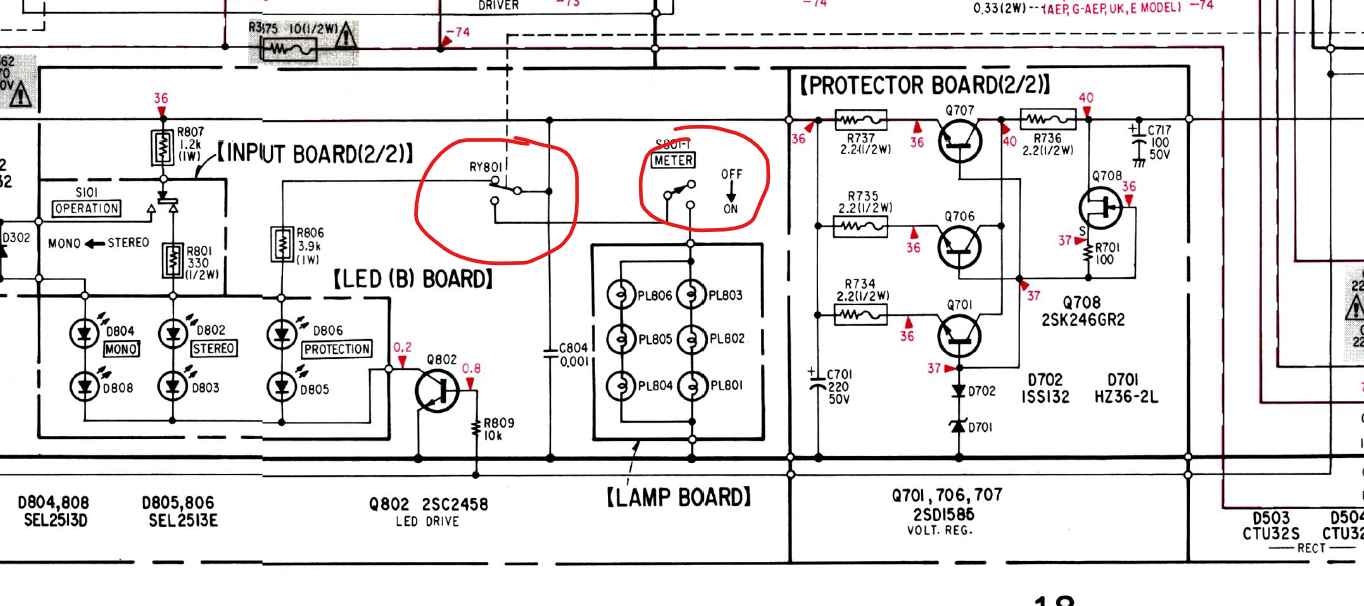

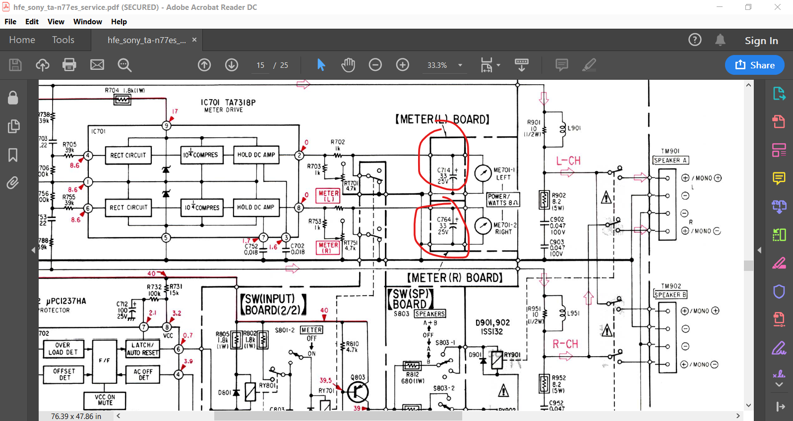

It seems to be a board holding just a single small electrolytic cap. Odd that it is missing though.

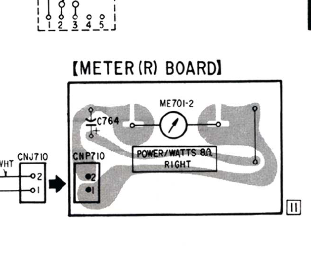

This is about the simplest circuit possible. First, you could extend the 2-wire lead plugs CNJ710 etc. direct to each meter's terminals using short lengths of solid wire that fit the connectors firmly for reliable contact. Follow this with connecting replacement capacitors across the meter terminals in the the same way. The caps will be polarized so follow the diagram showing where + goes, which appears to be the right side terminal as you view the meters and their (missing) boards from the rear. If the leads are long enough, you can wrap them around the meter terminal posts and clamp them with nuts/washers. Otherwise, solder the capacitor leads at the connector end where the leads are close together.
Replacement capacitor quality is unimportant here, so long as it's fresh stock, the 33uF capacitance rating matches well enough and the voltage rating is 25V or so. You can buy either radial or axial lead caps if they suit you better with their different lead spacings.
