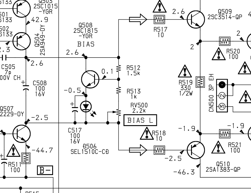

It is easy to tweak the bias generator but my worry would be thermal stability. Now if you deliberately run at a low bias then that might not be an issue.

The big giveaway would be a high Vgs (gate source voltage) needed to get the FET's to conduct compared to the originals.I'll do my best to see if I can identify the devices, my best bet might be to remove the devices on the working channel and use my basic automatic component tester (surprisingly good!) to see what it comes up with.

To get more bias voltage across R519 you would need to increase R512.
2k2 may be high enough or possibly 2k7. That will allow the voltage across R519 to reach the levels needed to bias common vertical FET's. 10mv across the test points is 100 milliamp bias current.
This is where it gets tricky because the bias current will tend to rise as the transistors warm and what you absolutely do not want is a situation where it starts to runaway drawing ever more current. Normally the bias generator transistor Q508 would be in thermal contact with the heatsink to compensate and reduce the bias voltage as the temperature rises. If you wanted to try with no thermal compensation then I would recommend setting the current lower so you have say just 2 millivolts across the test points. Then monitor the amp and get it hot (play loud) and check the current again.
Always always start with the preset turned to give minimum bias current.
I would also always recommend using a dbt (dim bulb tester) while initially experimenting to save any major disasters happening.

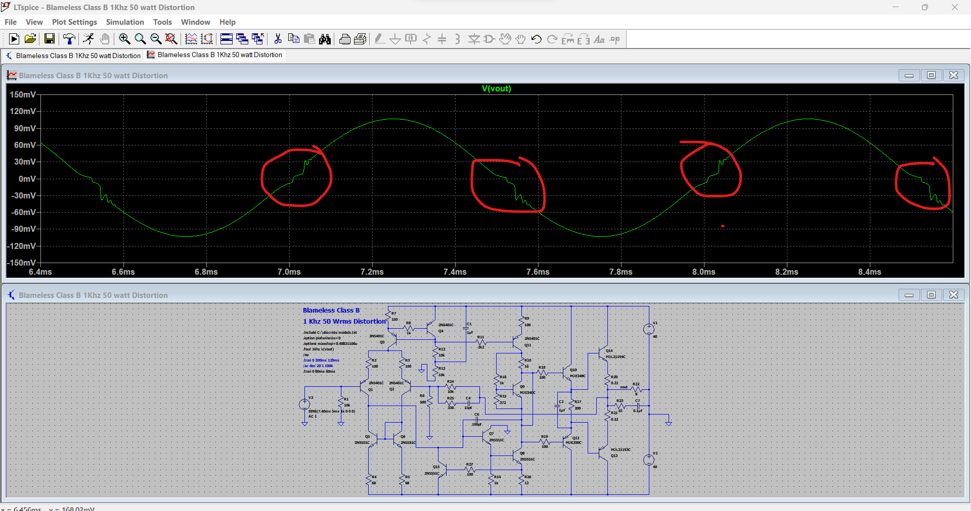

The voltage across the test points under load is just a reflection of the load current and so does not tell anything about the quiescent conditions.
It is worth doing the test with the 1kHz sine again but this time set the amplitude really really low, so just millivolts of signal across the load resistor. That is where the distortion would show.
This is just a simulation running zero bias. Look how low the signal is across the load. The distortion is always at the zero crossing point. Higher frequencies will show it better as well such as 5 or 10kHz.
You can also here surprisingly low levels of distortion on a sine (it must be a pure sine though, a function generator sine isn't good enough) and you will hear it as a rough edge to the tone. Again listen at the lowest possible levels to hear it.

Just out of interest, please could you explain the little bias circuit to me as I can't see how it can ever produce more than +/- 2.6V on the bases of Q509 & Q510 as that's the limit of the supply voltage isn't it?
The -/+2.6 volts are not a supply, added together (so 5.2 volts in total) it is the voltage dropped across the bias transistor. That voltage is determined by hard the transistor conducts and that is determined by the two resistors to the base. The curent flowing in Q508 is a constant and determined by Q507 which is a constant current generator. Fully conducting and the bias voltage (across Q508) is close to zero and then as we turn it off the voltage will get ever higher. We could go nearly as high as the main rails (so -/+44 v across Q508 ) with it fully off. That would let the magic smoke out 😉
You could also for example replace all that bit of circuitry with a single preset (although there would be no temperature compensation at all and the current is a little bit to high to put through a presets delicate wiper)
The LED gives a minimum bias voltage (say 2 volts) because it is in series with the transistor. It may also serve some form of temperature compensation for the original FET's but it should be nothing to worry over.
https://en.wikipedia.org/wiki/Rubber_diode

I tried the R512 change and fitting a 2k7 allows the bias 'voltage' to start coming up right near the top of the pot's range. Would a 3k3 be better here? I set it at 2mV initially (voltage across R519 now just over 7 Vdc) and then left the amp idling for an hour or so, still sat at 2mV, so ran a sine wave through it into the 8ohm resistor at about 15V RMS. Again no issues so checked around with my Flir (I'm a sparky so we do thermography on MCC's etc) and the only thing that stood out was the temperature of Q509 & Q510 was about 30C above the unmodified channel (85C vs 55C).
I presume this is an unavoidable side effect of modifying the bias circuit to increase the gate voltage? Is it worth fitting some small TO220 heatsinks or even moving these transistors onto the main heatsink?

I suppose ideally you would aim for the correct bias with the preset around the midpoint but it doesn't matter as long as you can achieve the value you want. Remember the actual bias current is the current flowing in the 0.1 ohm resistors. That is the value to check.
To get 7 volts across R519 takes I=V/R which is 7/330 which is 21 milliamps. Lets say Q509/510 have about 40 volts across them. That gives a power dissipation W=I*V which is 40*0.021 giving 0.84 watts each. So yes, a little bit of heat generation.
4 volts across R519 works out to a shade under 0.5 watt per driver transistor. So it might possibly be worth a very small heatsink. I wouldn't move the transistors off the board, that could bring other issues with stability due to adding wires. Other options (now we are down to real tweaking and modifying) would be to also raise the value R519. Higher value means less current for the same volt drop and that lowers the dissipation in the transistors.
Very small heatsinks are maybe the answer tbh.

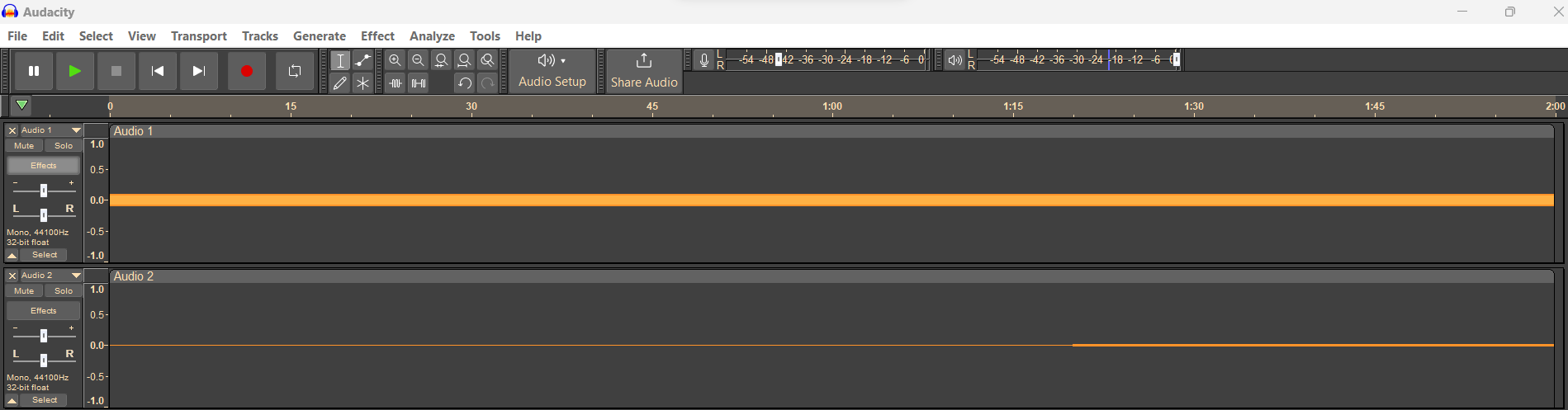

If you have a proper test CD with 1kHz sine then that should be a super low distortion source. If you listen at really low volume it should sound very pure with no harmonics.
The zipped folder has an MP3 track of 1kHz that also has increasing crossover distortion added. By the time you get to even a few seconds in the 'pure' tone has already been lost and you can hear the harsher harmonic in the background. Even playing on laptop speakers and the effect is clear. Play it and keep jumping back to the beginning as a reference of 'pure'.
With your speakers you do not ever want to hear that harsher tone (test with your CD playing). In practice even very low bias current totally remove any audible sound like that.
The image shows the base 1kHz tone at the top and the ever increasing lower level 3kHz tone at the bottom.
