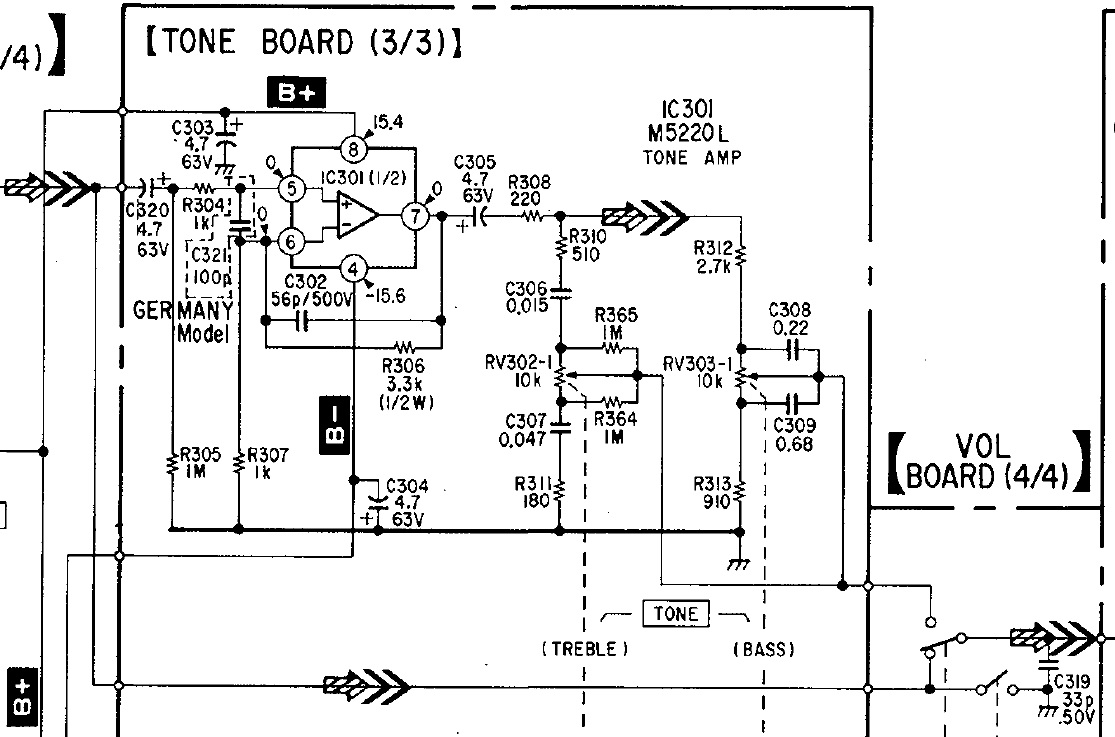

Here's the schematic for one channel :

Some more info that might help, touching both input or output caps makes the oscillation worse (especially the input cap). Oscillation is present also before the input cap but disappears when in source direct mode. I measure 0.5V at non inverted input and 2.6v at output on both channel when the manual indicates 0v on both. Also oscillation only appears on negative half of the sine wave.

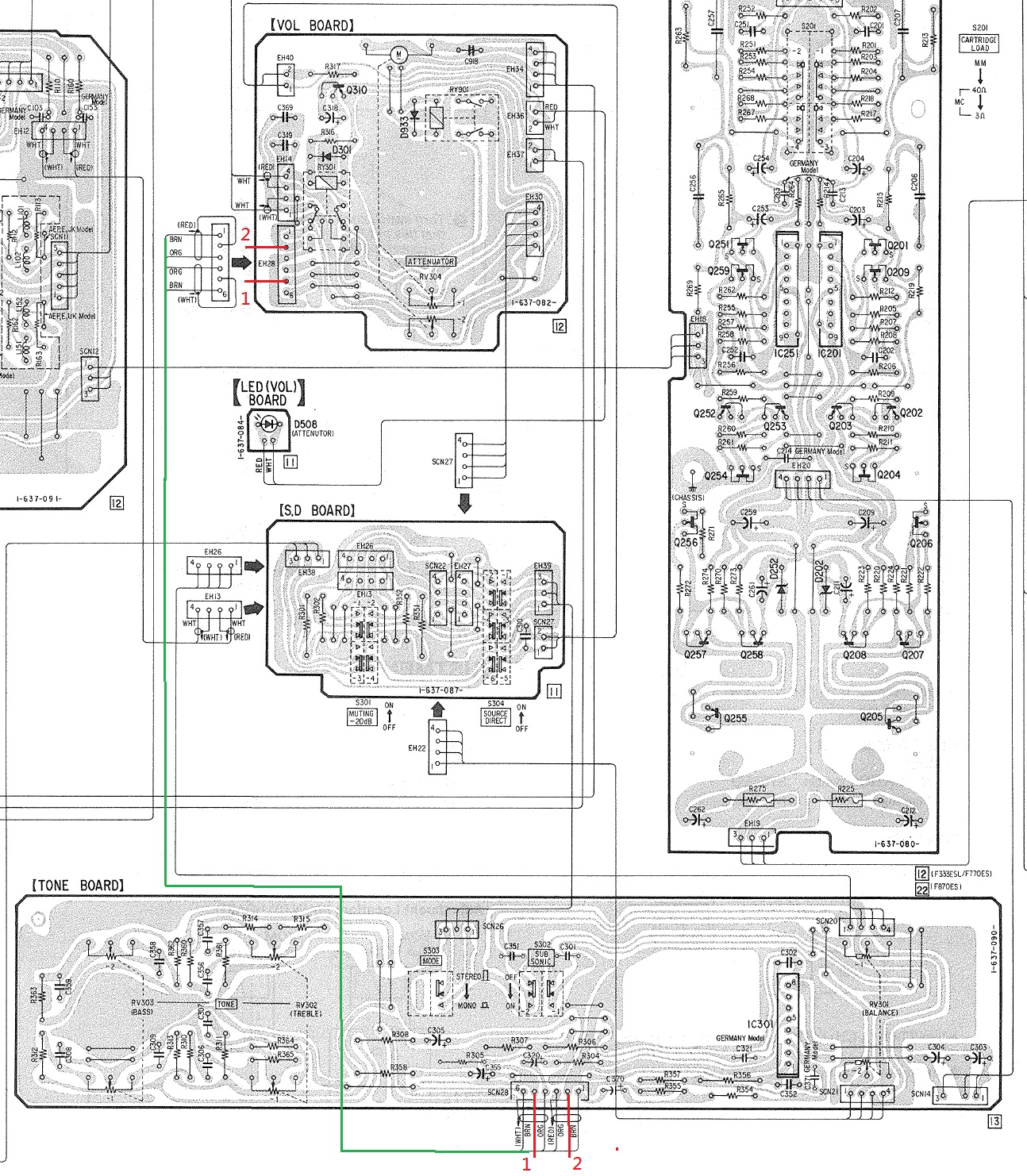

It's possible a disconnected ground line probelm, you measure the ground connections for points 1 and 2 between tone board and vol board(tone board PCB point 1 to vol board PCB point 1 etc)
If there is no ground line disconnected, then it is possible the op-amp problem

I'll verify tomorrow. I did check continuity from chassis to the different ground points on the tone control board and they seemed fine but I didn't trace them back to the volume board. I had a big oscillation problem at first with the treble all the way up even with no signal and that turned out to be one of the ground connections for the faceplate chassis. The sub chassis isn't metal and after some fiddling the screws didn't quite tighten the ground lugs down so I drilled a hole directly in the metal chassis and connected it there with a bolt which fixed that issue.

I would suggest checking power ground continuity at SCN14.
Could be a degraded opamp, too. If you can't find M5220L I imagine NJM4580L would make a good substitute.

Power ground return at scn14 and ground line between tone control board and volume board both check out. I noticed that it seems to be power dependant in that way that up to a certain point I can make the oscillation disappear by slightly decreasing the power output on the other channel with the balance knob (works for either one or the other channel). I checked the power supply rail to the tone control op amp and they stay perfectly stable.

I still suspect a ground problem because shorting a cap connected between the ground from the control circuit and chassis limits oscillation somewhat. Also connecting earth from scope probe to chassis (this amp has a 2 prong cable) changes the shape of the oscillation. I don't know if I mentioned this but without a load the amp doesn't oscillate even with volume at max.
This may be a valuable clue. Where could there be a shared ground return between the output and the preamp section? I don't think there would be too many options - I mean we're talking a rather high-current ground return path, that shouldn't be too long or complex. Gotta be somewhere between the output terminals and the filter caps.I don't know if I mentioned this but without a load the amp doesn't oscillate even with volume at max.
If only it was that simple... The schematic isn't clear at all about ground connections and they don't seem to correspond with what's actually in the amp. The only thing I see are the four heavy wires coming from the speaker terminal board back to the main amp not even passing close to the preamp. One thing I can see is that the relay command that also goes to the volume board and tone control section runs to the output relays that are on the speaker terminal board. I can try disconnecting those and scoping before the relays and see if that changes something.
