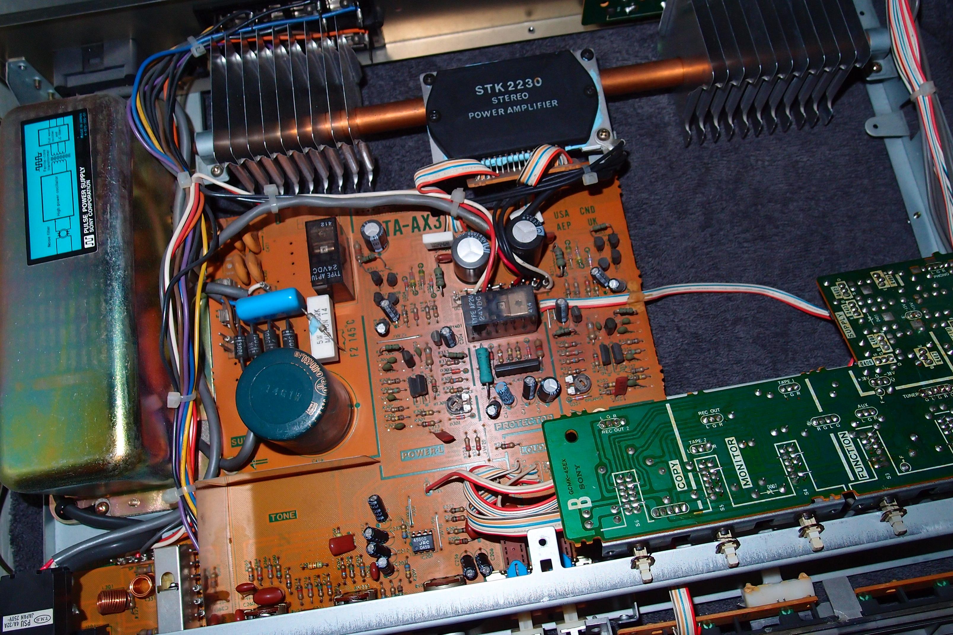

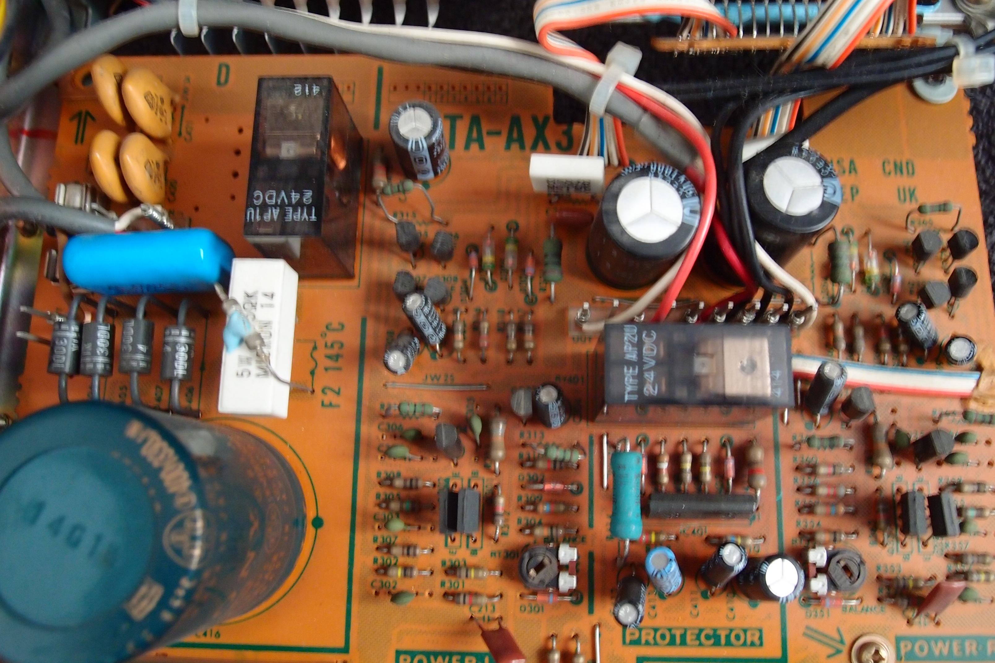

I have a Sony TA-AX3 with 2 problems.
One is noise I believe due to dirty switches and that's easy to fix.
But the other is that when I put the Bass control to the MAX level it stops working. When I put it back to the flat point it plays back again normally. It doesn't happen with Treble control. Is it any relay going in protection mode?
Some component out of specs? Pictures attached.
Thanks a lot.

Noise is most likely to be leaking capasitors.
Remember that when you put the bass-control fully clockwise, the power output in the bassregion is several times higher than the rest of the frequency range.
If the range of the bass control is around 12dB, the power output will be 16 times higher than the rest of the range. Given You have some subsonics too, the power will even go higher. Some depends on how the tone controls are made.
I guess it is the speaker-protection relay that makes the amp quit working?
All sound gone?

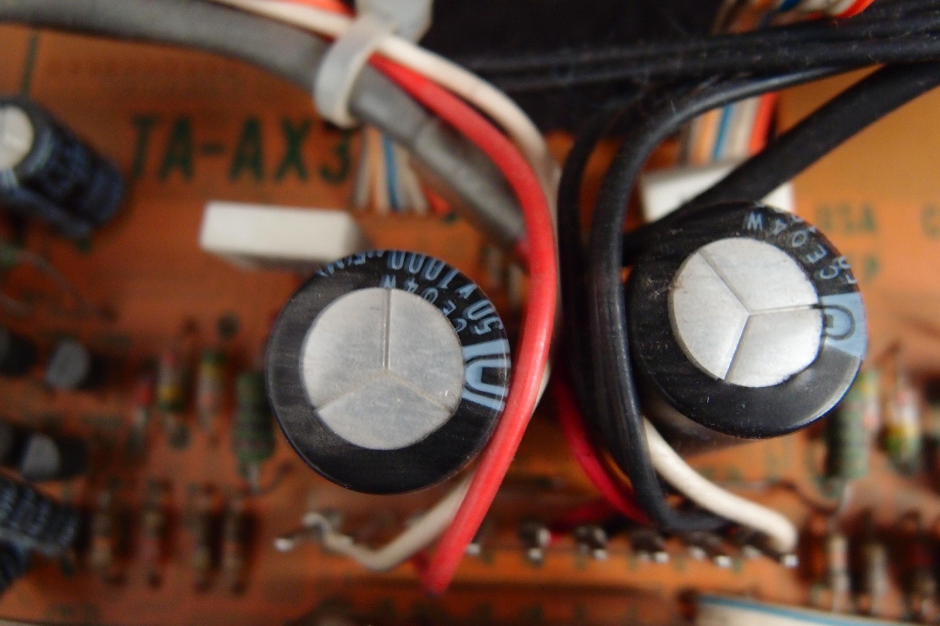

Single powersupply and outputs either brigded or with an output capacitor (The two a bit larger ones near the power module) I'll check whats for real.
A bit strange this one.
Depending of model there is two or four 220uF 50V caps in the power. Assisted by four inductors to smooth the rails.

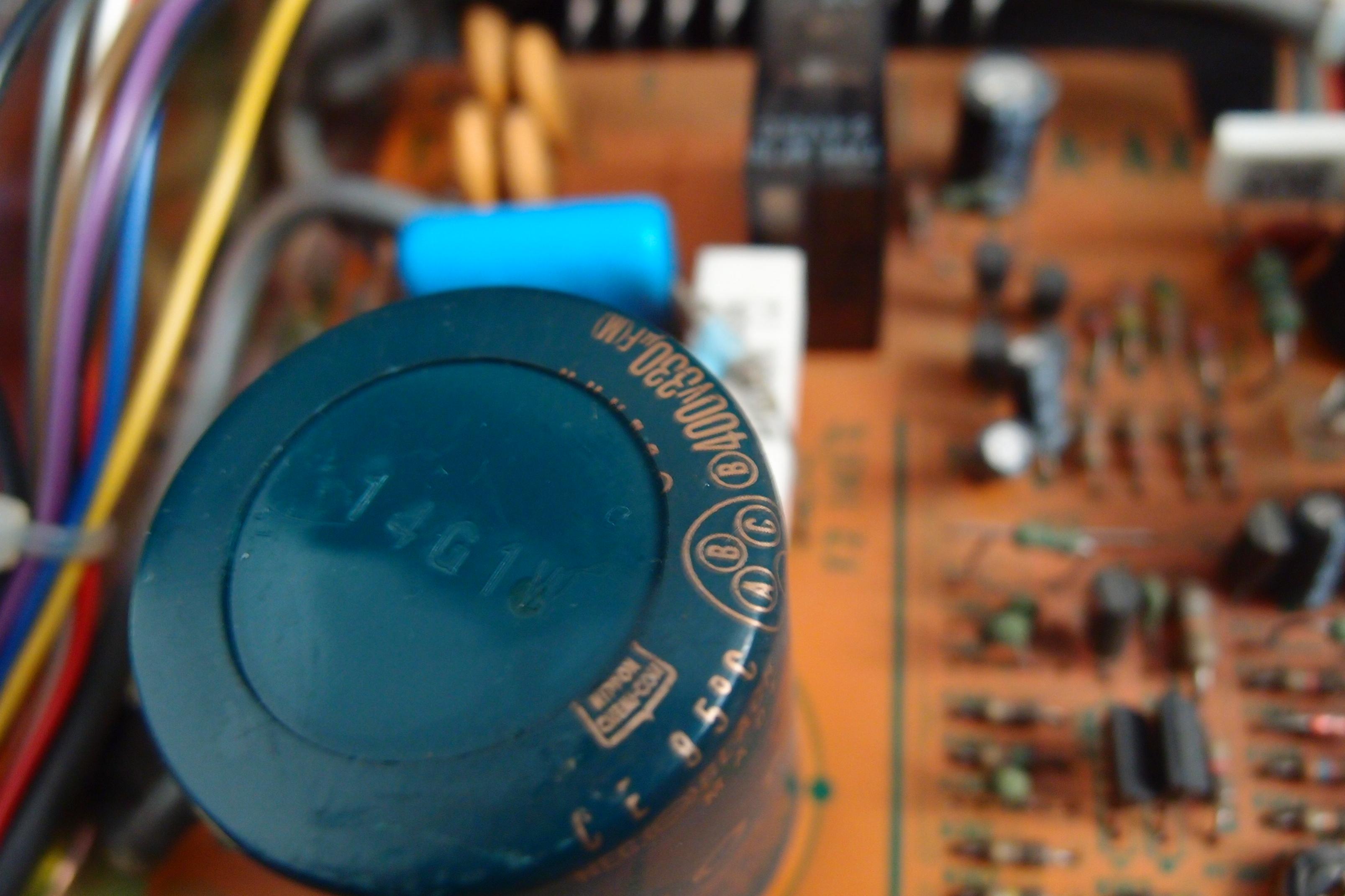

The big one next to the rectifier diodes is a 330uF 400V capacitor, wich is switched in via a relay after the amplifier has been started up.
And there they were. Two 1000uF 50V capacitors, the3 two ones near the powerblock.
But the relay isn't in the schematics, just on the drawings of the boards, likewise with the large cap near the rectifiers.
Must STILL look a bit more what they have done here.
Aha. The power is a SMPS. Thats why the 300uF 400V is there.
The schematics I have available is close to be unreadable in the powesupply areas.
Then the capacitors doesn't need to be as big either.
Explains a lot actually.

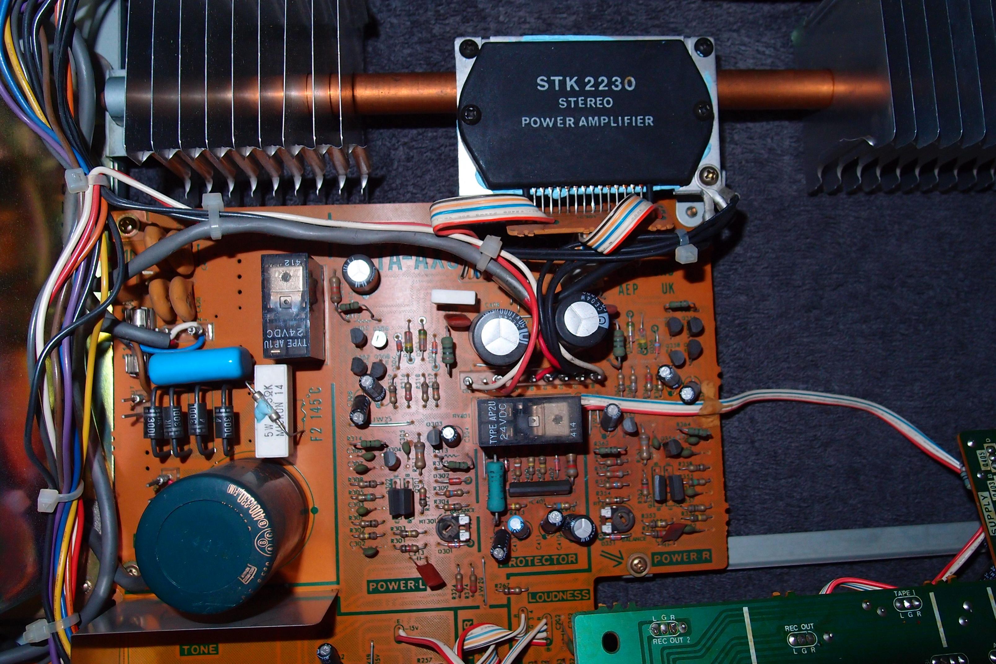

OCL-outputs with a +/-40V rail to the powerblock, giving 40 + 40 Watts output.
Want the schematics? Or do You have a copy yet?
The bass pot was completely opened and cleaned, de-oxided. I put it back and still it cuts the whole sound when I turn the bass control clockwise...
🙁 :boggled:

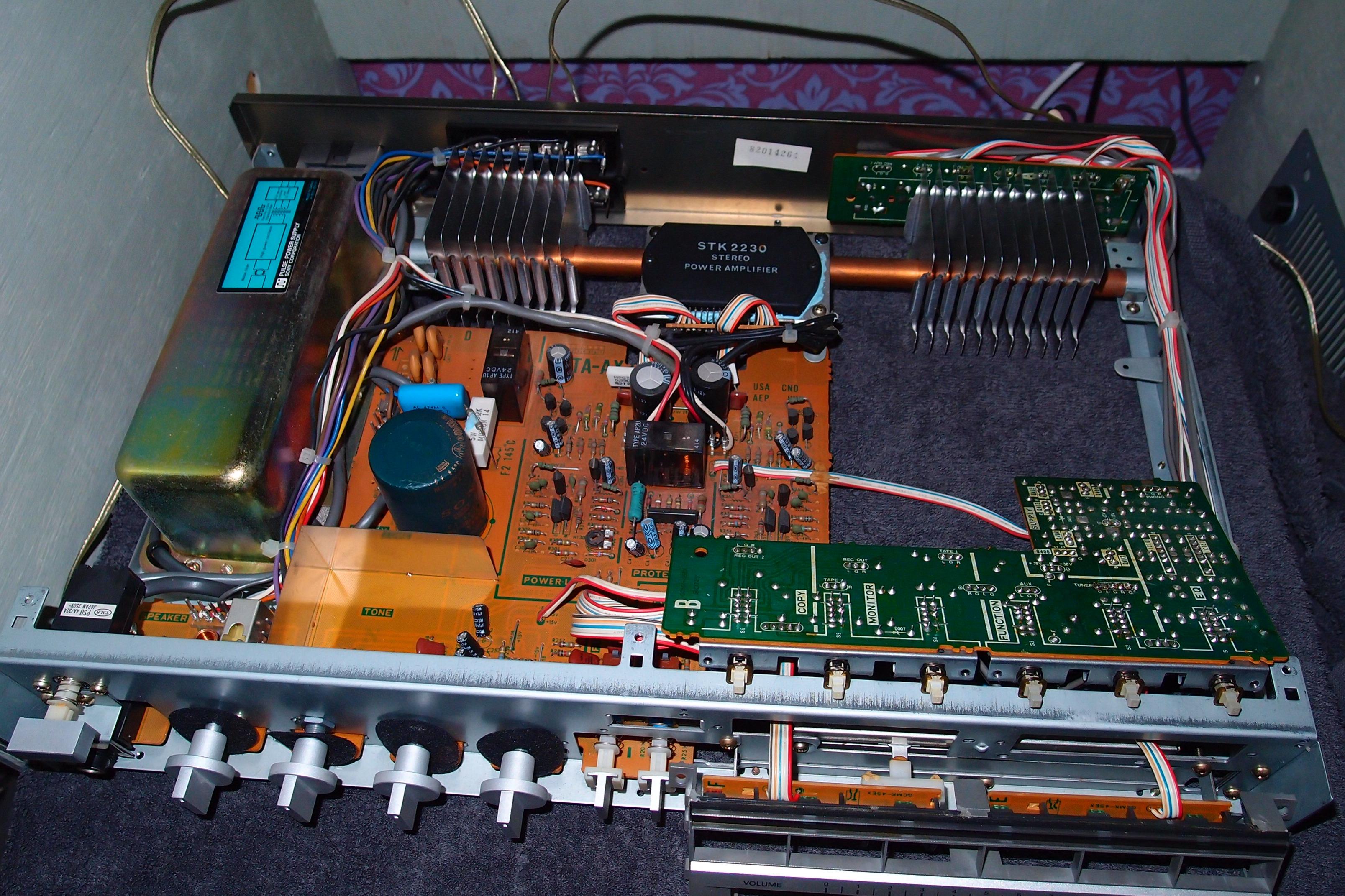

Yes, the schematics would be great. Maybe the Bias control are over limits and need to be re-adjusted??? I only need to know where can measure it (Bias/DC offset)...

Ok...
For this amp, I took the PHONO - TUNER - AUX switch out, cleaned really well, put it back and....... same thing! 🙁
Protector relay goes on when bass is up...
RT301 does not read well the 50mV for the left channel...
There's a general noise all over the sound. When I put the balance to one of the channels (left or right) it improves a bit the sound. Balance back to "center" and the noise returns... :dunno:
One more thing to add: it cannot handle the low frequencies. Distorts a lot. When a music goes to the end (fading), there's a little improvement...
