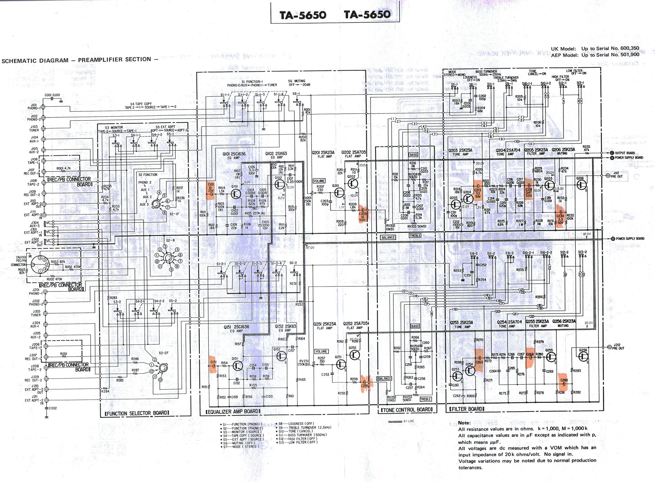

Not planning to redo all, but only the coupling caps in the signal path. In attached schematics I think I have identified the essential ones (orange).
I understand that the Panasonic FR-types may be a suitable choice. Available here: EEUFR1H100 - PANASONIC - CAPACITOR, RADIAL, 50V, 10UF | Farnell Nederland
So two questions: 1) did I pick the proper candidates and 2) did I pick a proper make?

With those values (0u47-10u) you've highlighted, I suggest using film capacitors instead for AC coupling. Film capacitors have practically zero DC leakage and much lower dissipation factor compared to aluminum electrolytic capacitors. Digikey carries the Kemet R82 series and Panasonic ECQ-V stacked metal films that are compact in size and reasonably priced. I don't know what is available in your area but you get the idea. Most aluminum electrolytic capacitors even low leakage types are poor choice for AC coupling anyway, they have significantly higher DC leakage (compared even to tantalums) that in time will make volume controls permanently scratchy.

Just looking at the circuit and I think you've missed a few out that are important audio-wise 🙂

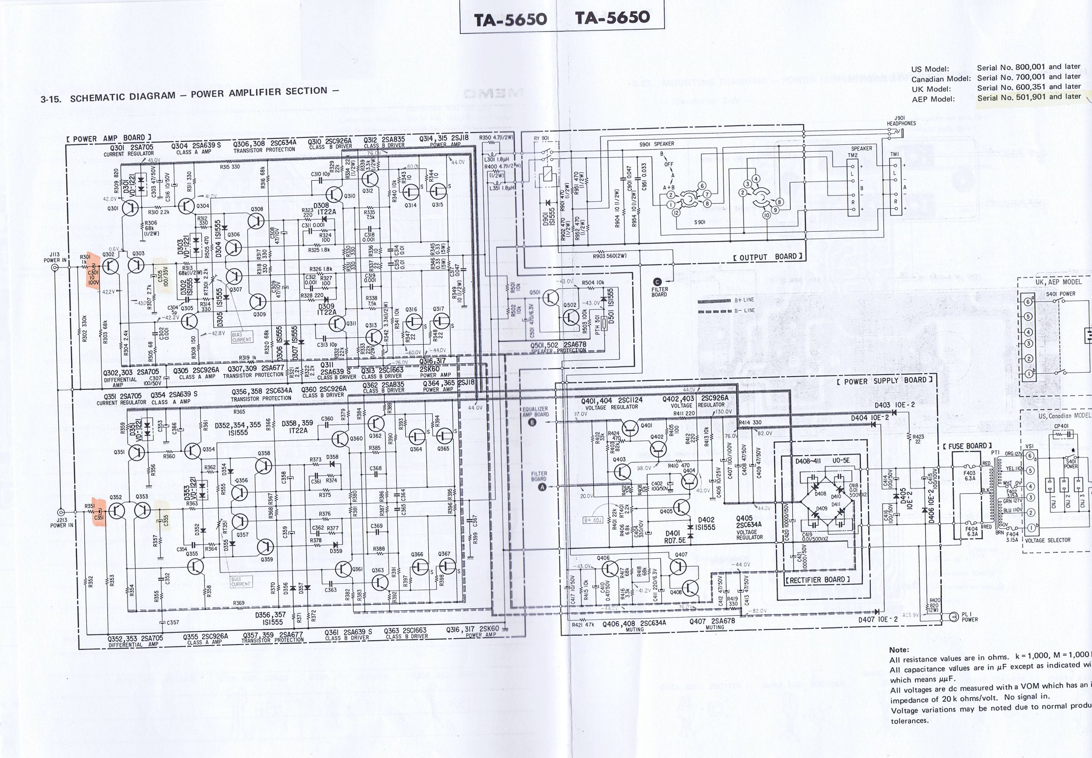

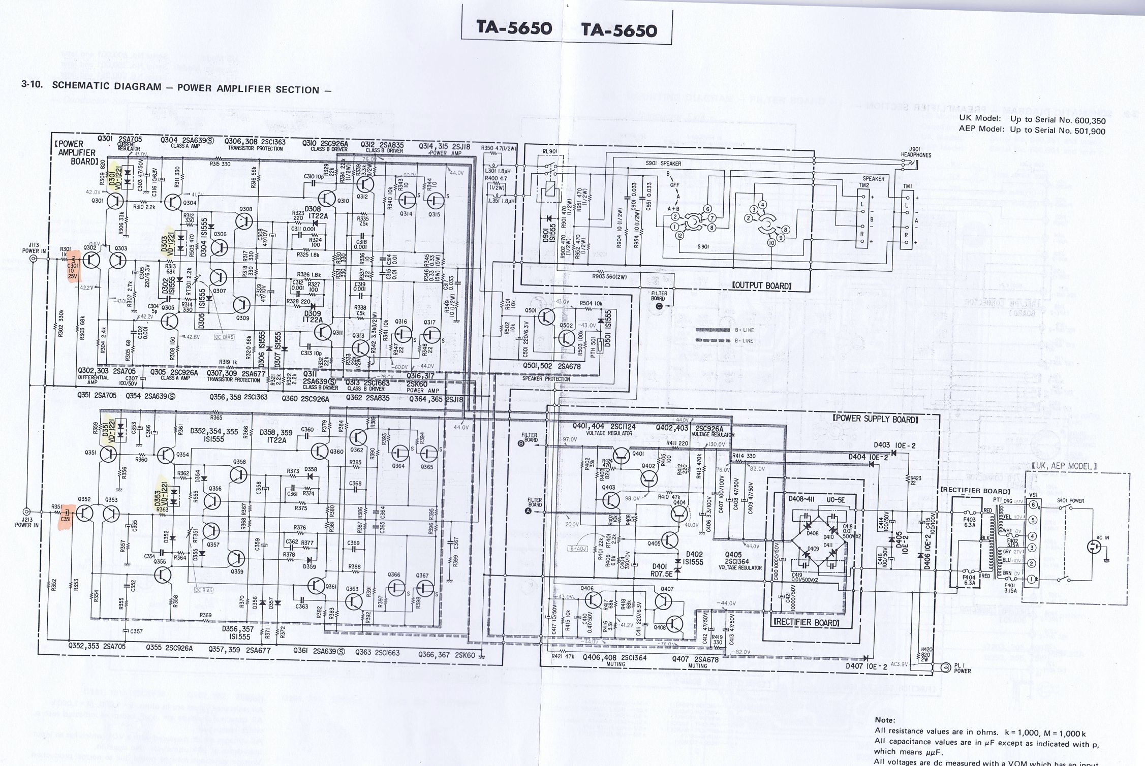

C103 and C212, both large electrolytics and both hugely important. C305 in the power amp is also just as important as any coupling cap.
Also C308/9, although not in the audio path could if they are degraded or gone high E.S.R. allow for premature and unpredicatable operation of the protection circuits.

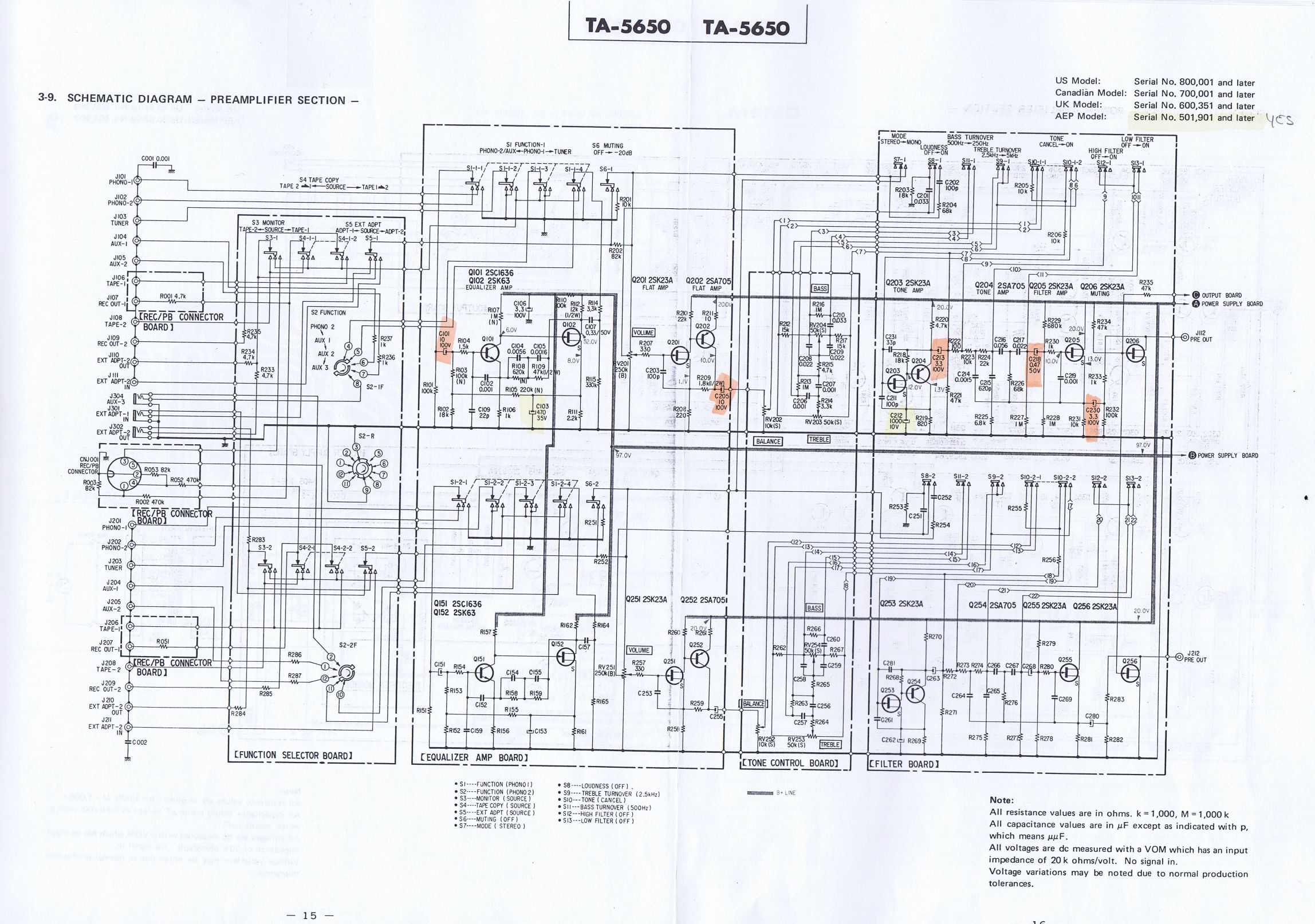

Sony changed the design...
Now here is where it gets interesting:
1) For serial nrs. over 501,900 Sony changed the values of C103 (from 2200 uF/10V to 470 uF/35V) and C305 (from 220 uF/6.3V to 100 uF/35V). C212 remained the same.
Now, why would they change the capacity? The surrounding resistors and operating voltages remained unchanged.
Where I am worried that my caps may not be the best type, imagine the effect of changing the capacity by a factor of 4 and 2...😱
2) Also Sony upped the voltage of most coupling caps (C101/C205/C213/C230/C315) from 25V or 50V all to 100V.
Why would they change the voltages? Again the test-voltages shown are identical with the previous design.
Changed schematics attached.
My serial is 506,585 so it would apply to mine, which means that I may have ordered wrong caps...
Could use some expert advice here!

1) C103 is an interesting one.. it could have just been a printing error on the schematic ? It is part of the phono input, so if you dont use that, you dont have to worry too much. My guess is the reduction to 470uF was so that part of the circuit (looks like a bootstrap) would stabilise quicker.
C305 was likely just because there was no loss of performance with it being 100uF, and they use 100uF @ 35v elsewhere. Larger will not hurt at this particular part of the circuit.
2) Well there is not 100V at those nodes, so dont panic. It was probably just to do with some manufacturing supply issue.

Both those caps have to have a value "large enough" such that they don't roll off the frequency response at the bottom end. Make them too large and the amp takes much longer to stabilise at power on.

C103: I think it was deliberate and not an error. The values are also shown on the PCB layouts. I do use the (V-fet powered) phono quite a lot actually. Speed could be a reason.
C305, assuming this was deliberate too, what would Sony want to achieve?
My electronics knowledge is limited, but I think this works as a low pass filter? So a reduction in capacity increases the frequency range at the low end to pass through to the amp?

The increase to 100V is probably simply that they had suitable 100V capacitors on the production line already, so they decided to use them. I really wouldn't worry about it.
You are right about C305, it is a filter so that the amplifier does not amplify any DC offset. It is common in a lot of power amp designs. It should be large enough that the low end frequency response is not excessively limited, but small enough that the turn-on thump is not excessive. The thump is mitigated by the output relay however.
