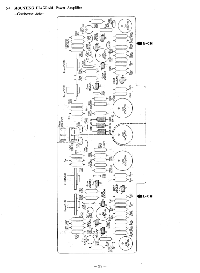

The problem I have is that my power amp board does not appear to be matching the schematics that are available online. For example, in my board C121 does not have its symmetrical for the right channel C221 and it's a 220uF cap instead of 100uF; C128 and 228 I guess are not on the board and have been changed in value (2200uF instead of 1000, and mounted on the front frame), and the overall layout of the components is quite different. However, my board appears to be the same of other units of which I found pictures online.
As I am learning electronics and troubleshooting, not having the right schematics makes all much more difficult. Does anyone happen to have the right schematics, or know what changes were made?

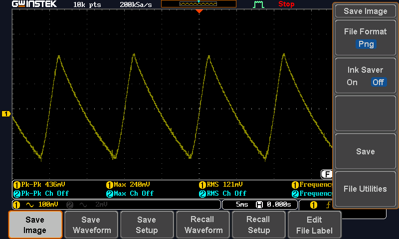

With a 1V peak to peak 1kHz signal, the output right channel shows at max volume a very noisy 400mV peak to peak sinewave. I can record that signal with my signal tracer as well, very very weak.
The left channel does not show anything apart from a weird 100 hZ oscillation regardless of the position of the volume knob.

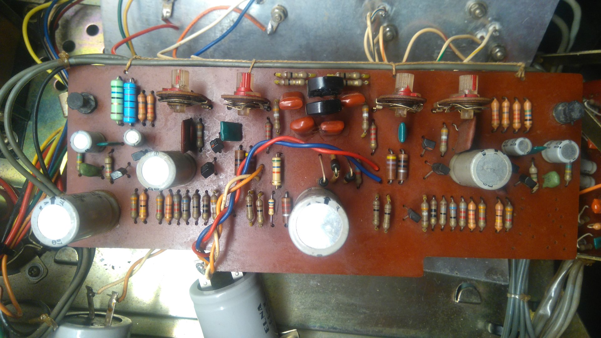

The layout of the board seem just different, I guess mine is a later version? Pictures online show a board that look like the one I have, and not the one in the schematics.
Interesting. Yes it does look like different in layout.
Although it makes things more difficult, it should still be possible to fault find on this as long as you take your time and are careful.

An oscilloscope is the correct tool for fault finding and tracing signals and levels. You should be able to pick up a clean signal on C120 and that should be amplified by the power amp section... which appears to have an extremely high gain by modern standards.
Sony always give dbm levels but they are of little use for faultfinding. A line input of around 150mv rms should be enough to fully drive the amplifier up to clipping.
And don't forget to use a bulb tester at all times, otherwise your replacement transistors could go the same way.

If you're in UK, the 100Hz 'oscillation' sounds like ripple on the power supply.
What's surprising about the 100Hz oscillation is that it shows only in the left channel and not in the right one.
I was already planning to replace all the electrolytic caps, still waiting for my order to be delivered.
You said Q109 is shorted - so 100Hz goes straight through the shorted C-E to the output.
yeah, that makes sense, I didn't see that.

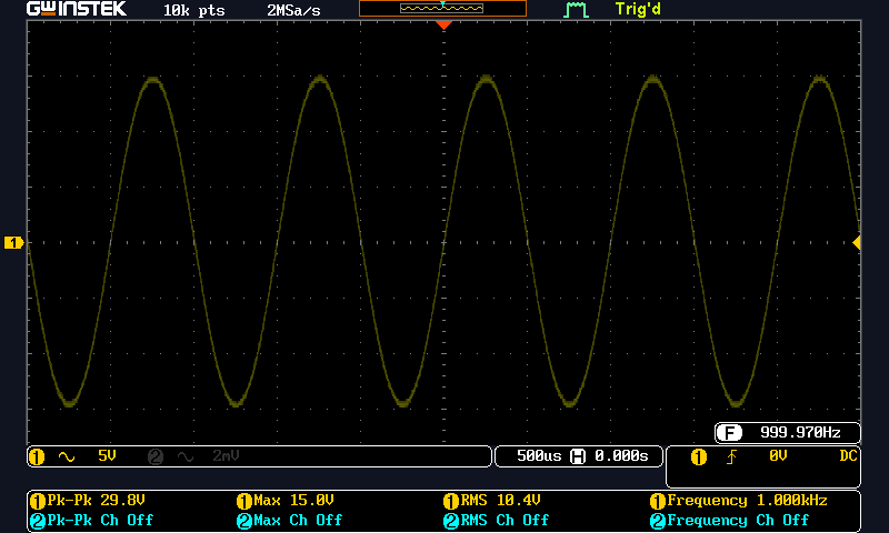

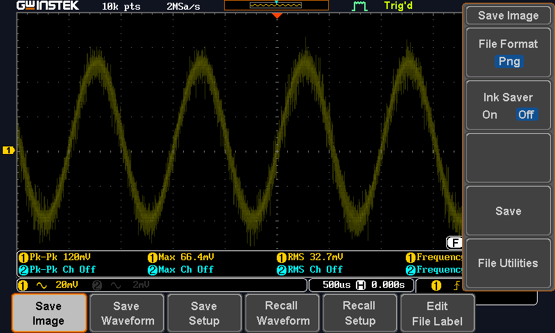

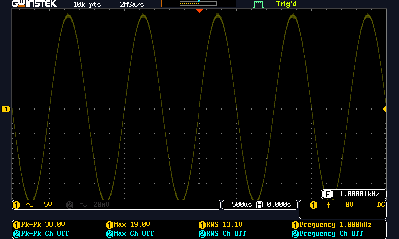

Here is the output on the oscilloscope from the right channel.
The signal at the output of the preamplifier is so weak that the oscilloscope registers mostly noise. I can however hear it very weakly using a signal tracer maxed out in volume.
At full volume on the amp, I get an output at the speaker terminals of 120mV pk to pk.
My input is a crazy 2V 1kHz sine wave, the output frequency is maintained at 1kHz

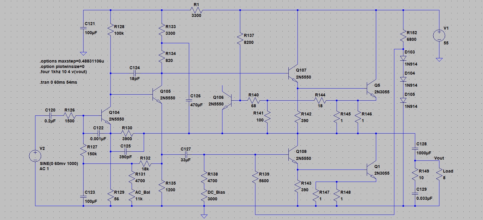

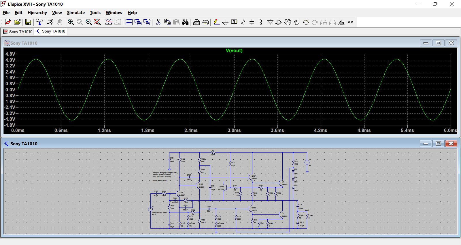

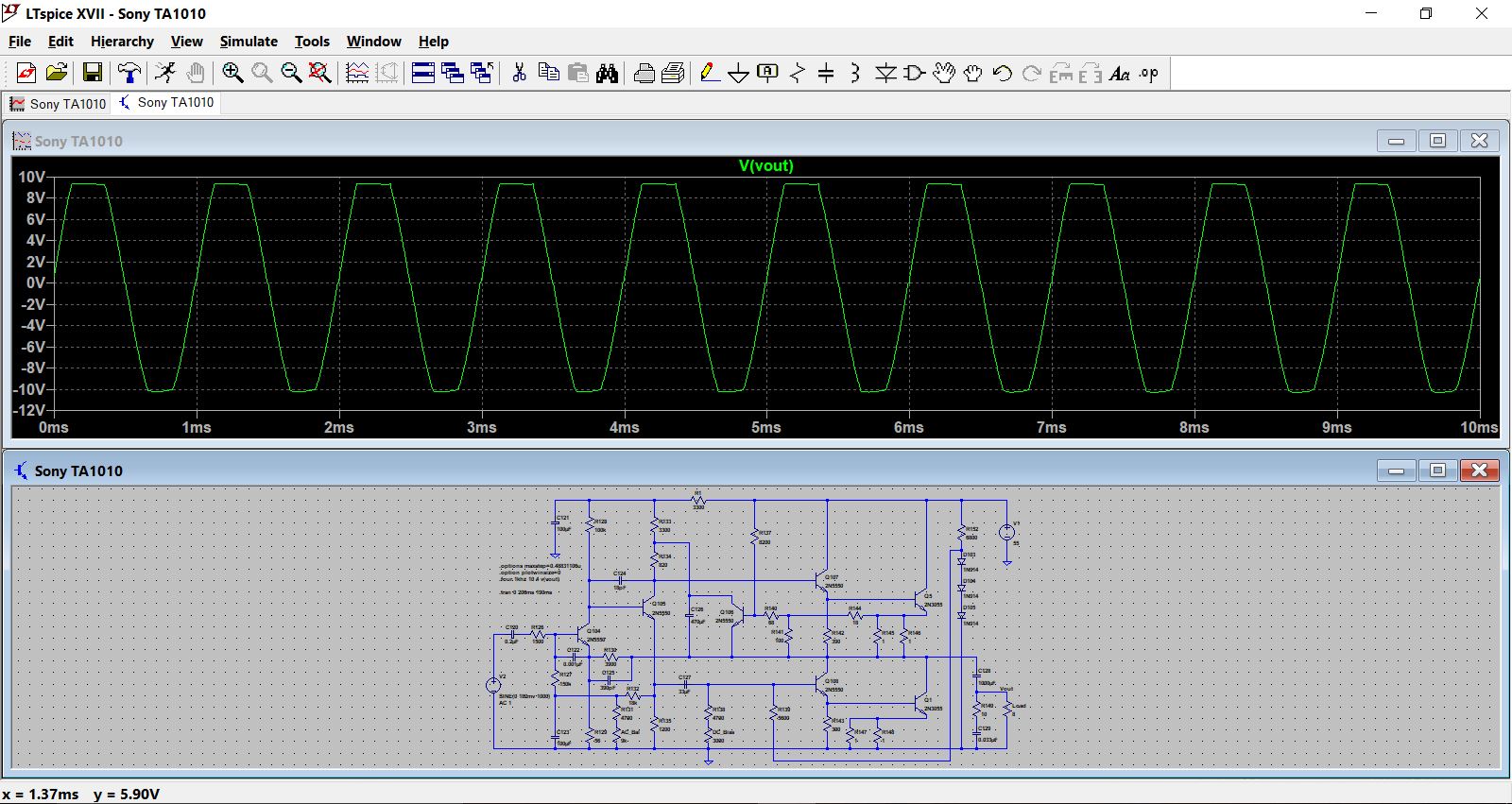

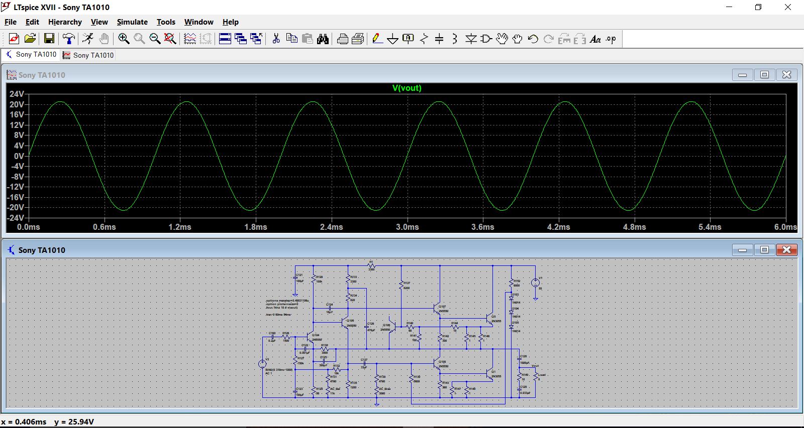

The lack of PNP devices makes this such an unusual amplifier that I decided to simulate it. (protection transistor disabled as I find it to aggressive. Probably differences in modern semi turn on volts... the resistor values would need tweaking)
I've attached the .asc file. Someone may find it useful at some point.
wow, thanks for doing that! 🙂
Update: tracing signals on the right channel made me get to the conclusion that the amplifier works, and the problem is just a malfunctioning source switch. Bypassing the switch completely, I managed to get a nice signal at the output speakers, that starts clipping at about 13.5W instead of the 15 that the amplifier is rated at.

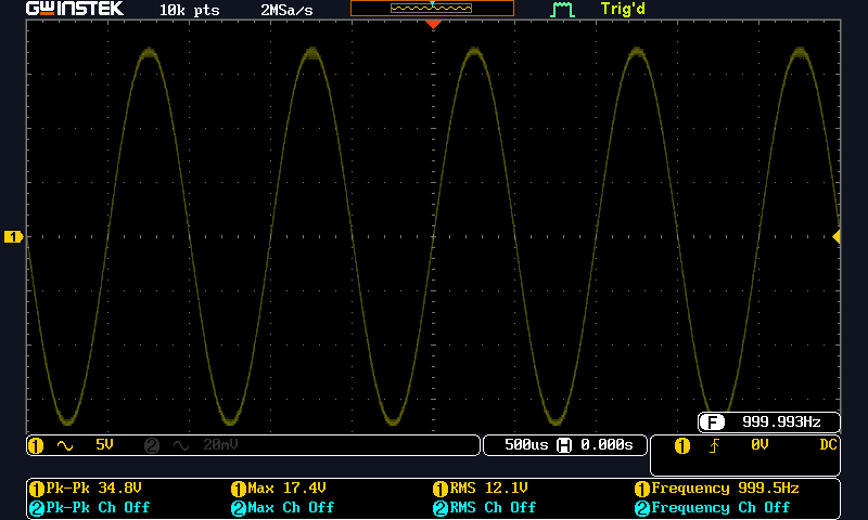

I matched the Q107 and Q108 with a curve tracer, and replaced all the electrolytic caps.
After adjusting the DC bias, it works like a charm, it outputs about 21.4W from the left channel (the one with the new 2SC1815), and 18.4W from the channel with the old transistors.

Even if the layout of the board is different than in the manual, the circuit is the exact same. The only difference I found was C121, 220uF in the board and 100uF in the schematics. I don't think anyone replaced it, it should have come out of the factory that way.
