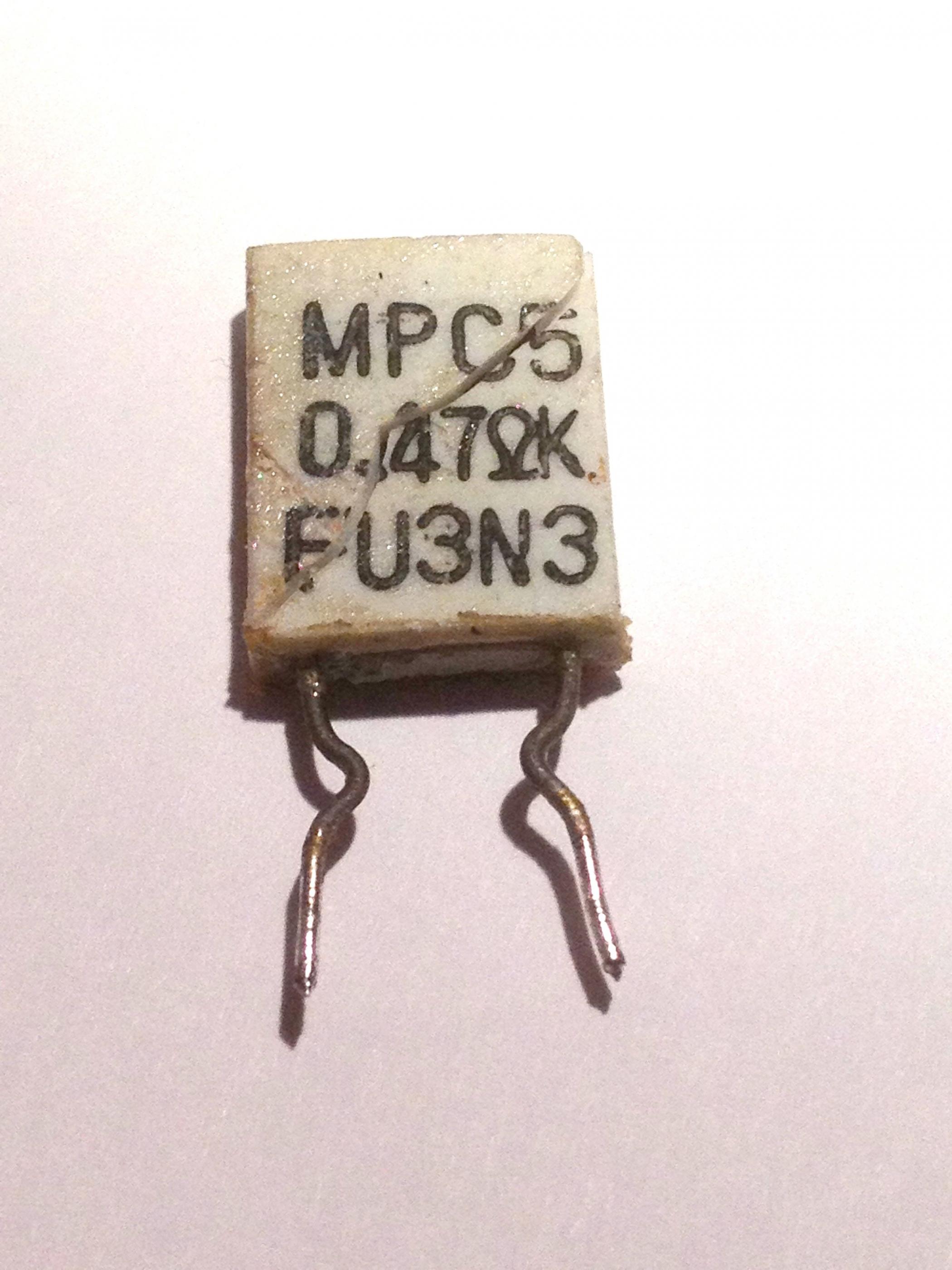

First, what Metal Oxide resistors attached to what 4 emitters were replaced? The four "metal strip" resistors (R718,9 and R768,9) are the emitter resistors of the output transistors which are used to measure and set bias. The procedure specifies reading across both 0R47 resistors in each channel to establish 50mV across the resistor pair (0.94 ohms total) which equates to to 0.05/0.94 or 53 mA bias current. Those resistors should have run cool at that current so what were you measuring and was it using the correct DC volts meter scale?

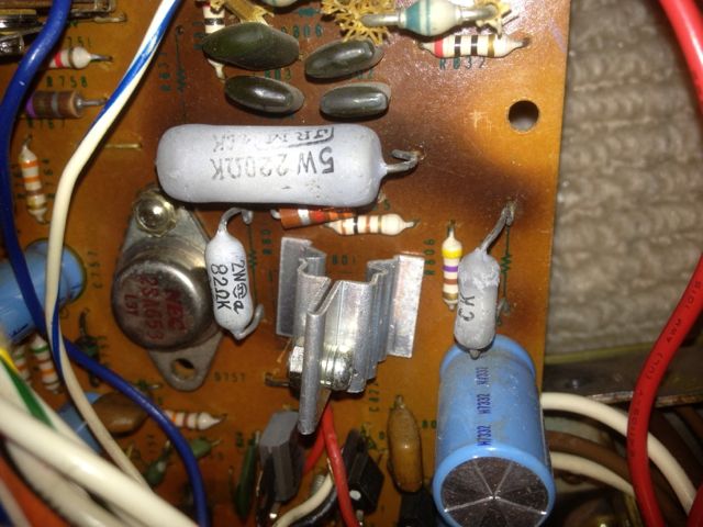

The image of 1 of the 4 resistors replaced with MO is attached. They were disintegrating. The other image is to illustrate the wire wound resistors I replaced. As stated earlier they had got very toasty. This is a common occurrence from what I can tell from other posts both here and on AK.

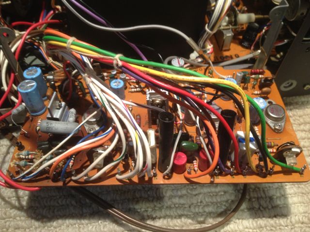

I also included a shot of the entire board for what it's worth. Lots of wires in the way, but will give an idea of the layout for discussion purposes.
OK, thanks. I see you were talking about the replacement types. Those other wirewounds are only powdering in the ceramic dip coating. They will still last another few decades with or without the coating so don't fuss over them. It's cosmetic, not functional. The parts to be more concerned about are discoloured film caps and electrolytics which are the sign of ageing plastics and may be more critical if that affects the component.
I couldn't find thin emitter resistors of values above 0.22R on the bay. It will likely be necessary to use standard, square 3 or 5W WW resistors which, below an ohm resitance will be low inductance anyway. Dont use round types unless clearly described as low inductance types. You can buy these anywhere and you don't really need 5W resistors until you get around 100W amplifiers. Smaller will be better, I think.
