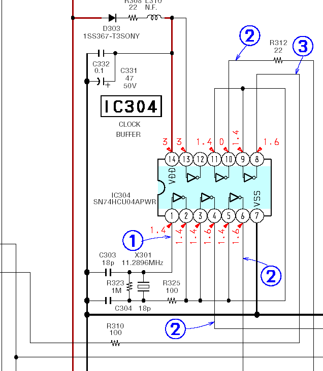

hi all,

Yuck !
TOO many inverters in the circuit, and they are in parallel .....
Yes, the crystal may be where it should be, the design however does not have low jitter in mind.
Get rid of them, as much as possible, and use the lowest nr of gates possible to distribute the clock
I myself never encountered an 04 based clock circuit that measured / sounded well, so throw it out
succes

I would leave IC304 in place for buffering clocks to distant / noisy circuitry, but wire the replacement oscillator's output directly to the DAC if possible. IC304 is inverting, so if you remove C303, R323 and X301, then inject your clock into IC304 pin 1, this will pretty closely preserve the clock timings and hopefully prevent problems. You can simply lift the IC304 pins which are outputs to the DACs, and instead wire those pads directly to the oscillator. A canned oscillator will probably do a fine job to test if it will work, and then I'd move to a more sophisticated oscillator later.

My oscillators drive 15 pF, that is 3 or 4 gates, assumed little wiring capacitance is present.
Good suggestion, directly drive the DAC where conversion takes place, distribute other clocked gates using buffers. I always advise the use of series resitors, by the way.
yes, good to damp the lines. here is one area where Sony appears to have really done their homework - you can't see them in the schematic but there are series resistors before all the clock lines to the DACs, and they are different values depending on the length of the line - 22, 33, and 47 ohms for the shortest to longest PCB traces. a nice touch.

In my humble opinion, they should be at the transmitting side, that is, if you only use one series resistor. Situation changes if you fully work with a characteristic system, but there is no need for that as long wiring is kept short.
Sony engineers are talented, but designing audio equipment requires a lot of skills, as most among us (including yself) find out in daily practice.......
enjoy
yes, the series resistors are near the HC04 chip, before the PCB traces to the DAC chips. i assume that's what you mean by transmitting side. i dunno if the values were chosen arbirtraily, or if the actually modelled the impedance of the board. would be impressed if it were the latter.

Then the Sony engineers did the right trick. I myself see 47 to 100 ohm a s a right value to start with. If you choose a too high value, the slope of the 0/1 transition will be to low, which might lead to jitter.
The final impedance is a tradeoff between
- slope
- RF current reduction alongside the board
The slope obviously is important wrt jitter, the current amplitude and frequency are too (lees obvious)
Currents across the PCB yield voltage build-up in th egroundplane, which in turn leads to induced jitter at the receiving end as well.
Looking at average PCB designs, with thin traces (heavy traffic....) board trace impedance might be something between 100 and 200 ohms

The 74HCU04 is a hex inverter, yes? How about replacing it with something else?
I wouldn't suggest an AHC, but I find that the VHCs (74VHCU04) usually sound better than the HCs.

Hi
There are 2 issues
- the fact that inverters are paralleled
- the family of logic
I do not like parallelling inverters for several reasons, so always try to use only 1. If you want the non-plus-ultra, just use picogates !
Yes, you are right about VHC or HCU logic, it is better than HC, but has lower fanout: no free lunch !

While my knowledge of digital audio is limited it seems like one thing that hasn't been mentioned is that most of the inverters that are run in parallel are for the six channel audio. If the CD player is going to be used for stereo the clock only needs to be sent to the DAC and Main board. I don't know if you would want an inveter for the line from the audio board to the main board, but that should be the only one you need...

Hi all
We need to discuss clock distribution here....
I'd suggest to
- Place the clock as close as possible to the DAC chips
- Directly feed the stereo channels
- Use 2 single inverter buffers (picogates) to drive the other 4 channels
Th measter clock here needs to feed 4 gates, which is feasable to my practice
