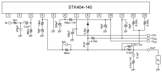

This is the application suggestion, the origional has a diode on point8 whitch the Sony does not have. What would that diode do ?

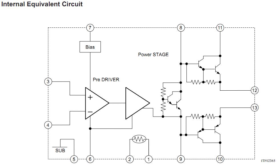

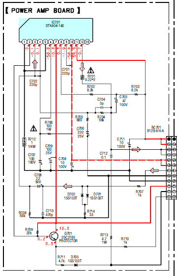

Inside the IC. Am I correct when I say that if R712 is blown then the thermal protection will not work ? Normally the amp will work without R712 but there will be no thermal protection. So amp overheats and blows every time ?😕

R712 appears to tie the substrate of the chip to ground. It looks to be one of those components that a manufacturer may include for safety, or to minimise damage when (or if) the chip fails.
The bias is set internally within the chip and looks to be a conventional vbe multiplier (connected to pin 8). Its fixed, nothing you can do can alter that.
The diode I wouldn't like to say. It may help with switch on/off behaviour in the basic circuit, something that perhaps isn't a concern if the Sony has a speaker relay circuit to eliminate noise at power on/off.

Yes it has dc offset protection and I see there are a lot of fusible resistors. I will check them all out and the caps on the amp board. I have ordered another IC and if it fails again I will put a class d amp in or just fix it and sell it so another person can swear at it !😀
