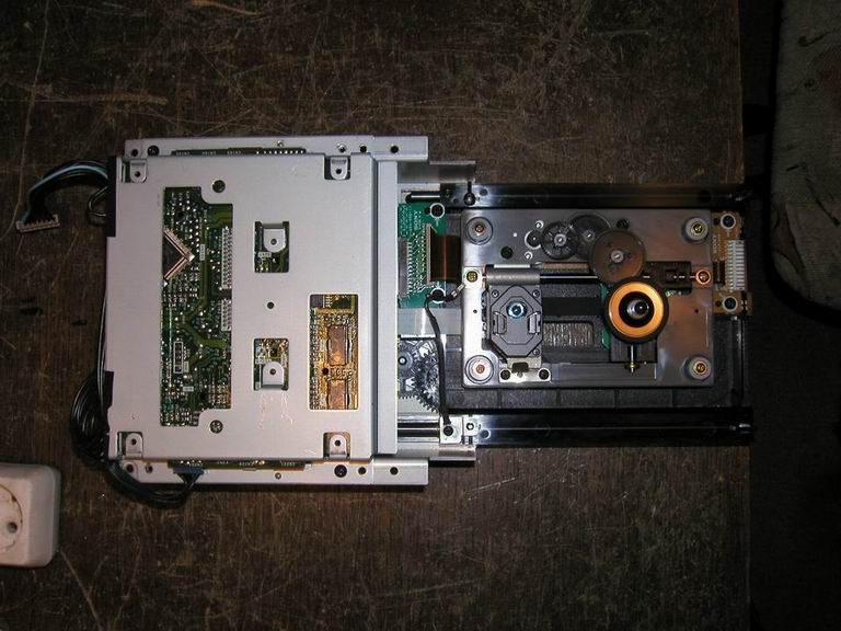

Hello, I'm a newcomer. I have CDP XA 7 ES . Could you help me to find out .Is there any replacement for KSS-273 A ?
They say that CDP XA 55 EX has this pick-up but the other source says that it has KSS 273 B. What is the difference between these optical units?
Other words Is it possible to replace 273 A to 273 B?

Not the KSS-273 but when sont used the KSS-210 and KSS-212 the difference between A and B was negligable. One was designed more for portable devices but both would work in either.
I think 273 B is the latest model than 273 A. But do not know are there any changes in this modification.
Looking for an answer for my Q in other forums I have find out that 273A can be replace with 273B.
But there are 3 part # of KSS-273B: 882001402, 882001413
and 882001414.
Does anybody know what does it mean and are there any difference between them?

in this case this thread could be of interest (include a little gallery and some schematic samples):
http://www.diyaudio.com/forums/digi...ailable-optical-pickups-sonys-kss-series.html

Excellent video! That point of view is not usually possible. I've been wondering why Sony mechs can have fits of noisiness and periods of calm.
At 3:10 on the video, the focus motor is very busy bobbing the head up and down, but later on without the disk being touched, it is motionless whilst reading the same part of the disc. It looks like the CD can be tilted by the jogging of the sled.
The relationship between the two radial drives, sled and head, is quite entertaining. A similar view of a sled with a linear motor would be good. Viewed from underneath, they go through episodes of wobbling for no apparent reason, but I can't see the disk or the laser head at the same time...infuriating. An endoscope would be useful...
