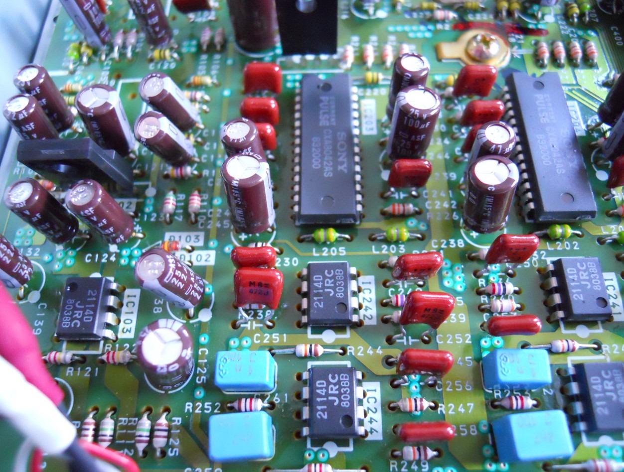

Twin pulse DAC's on this one and JRC2114 opamps which are similar to (but a slightly higher spec) 5532

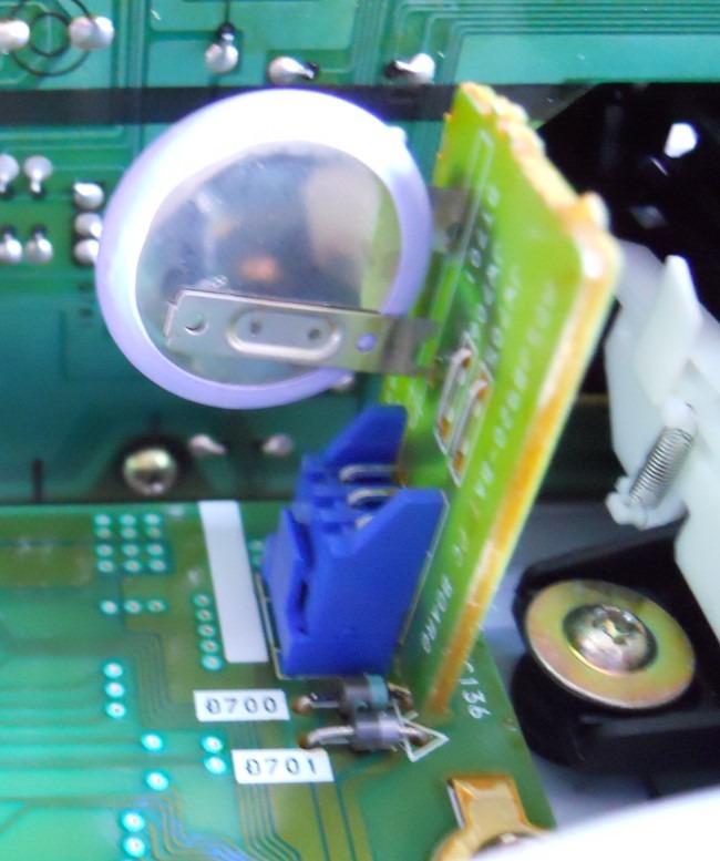

This models have one unusual circuit design feature in that they use a rechargeable lithium coin cell for retaining the real time clock and any user data if it is used to do a timer recording. Its reading around 2.8 volts but I guess it may have been unplugged for a while. I think I might replace that. Rather thoughtfully it is mounted on a plug in removable 'battery' PCB containing just the battery.
This is the original battery. I replaced it with a Panasonic VL2020.

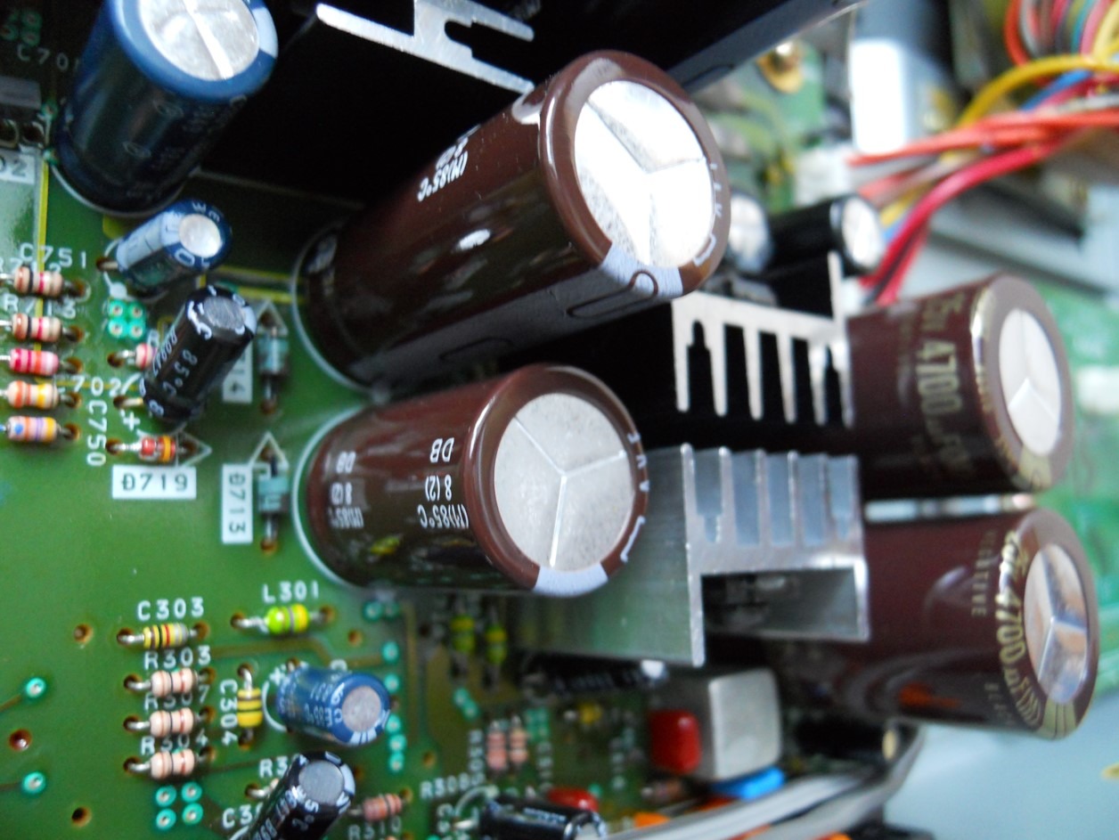

The PSU has some rather nice caps in there. Given my experiences of Sony gear I don't think this will need any replacements yet.

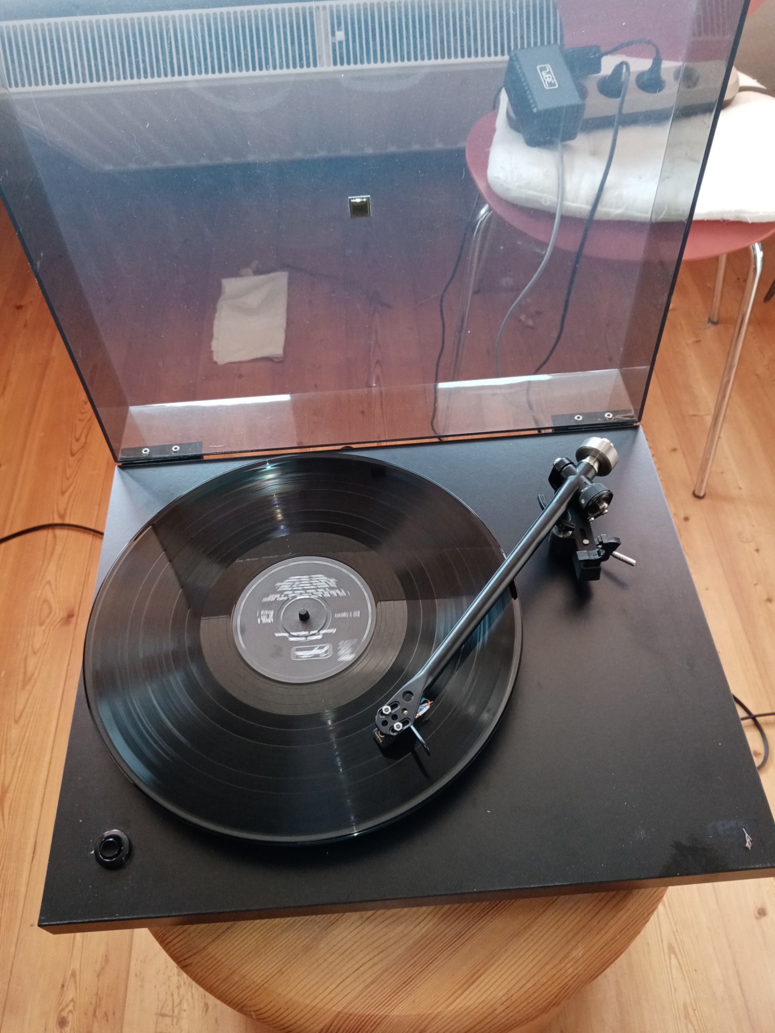

Technically the work with tapes was outdated but lastly I got nostalgic and revived my Rega planar 3 with 1042 goldring stylus.
