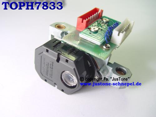

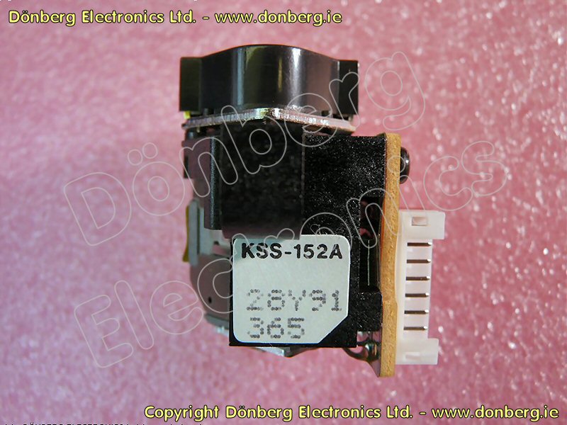

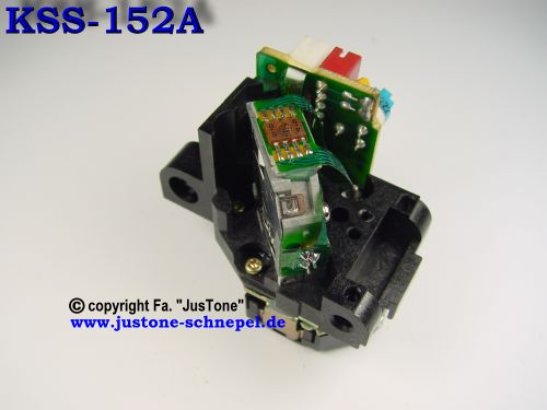

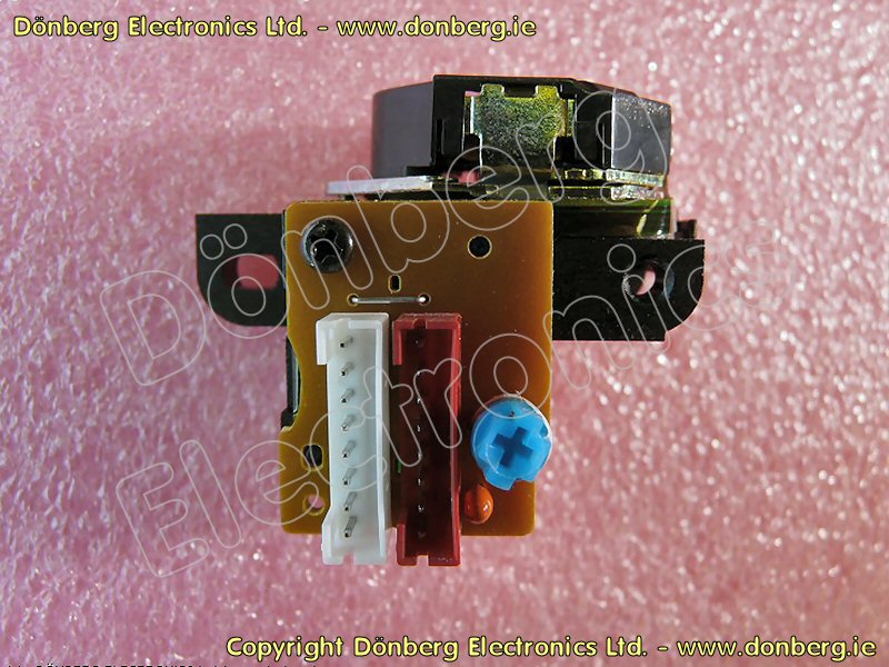

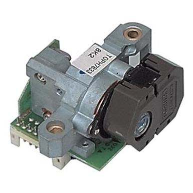

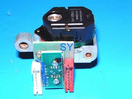

From SONY's KSS-152A itself exist two different versions and additional there are three compatible optical pick up's:
1) Toshiba TOPH7833 (TOPH-7833)
2) Samsung SOH-OT3 (SOHOT3)
3) Olympus/Mitsubishi TAOHS-MR (TAOHSMR) or TAOHS-BR (TAOHSBR - no images available)
used in ONKYO DX-150 - go to
Onkyo DX-150 zum Leben erwecken ., Hifi-Klassiker - HIFI-FORUM
and also in follow models:
KENWOOD DP-990SG 2 x PCM56P-K – SM5804D Kenwood J91-0341-05 / TAOHS-
KENWOOD DP-1100SG 2 x PCM56P-K – SM5804D Kenwood J91-0341-05 / TAOHS-
No 2) and 3) are hard to find, but both TOPH7833 and KSS152A are not hard to find parts.

I had the misfortune of doing Luxman warranty service when they were owned by Alpine, and can tell you that the laser used in most of their players at that time, which I am pretty darn sure was the Toshiba, were monstrously unreliable. Can't count how many I replaced in just a 3 or 4 year period. Later they changed to the KSS152, but most of the Lux models listed as KSS152 actually started out with the Toshiba, and either got 152's in warranty service or were later production. Can't recall ever seeing the Olympus version anywhere.
I am still looking for a KSS-152A replacement in a version with higher reliability. Are there a compatible model from Victor (JVC, Optima series) ?
