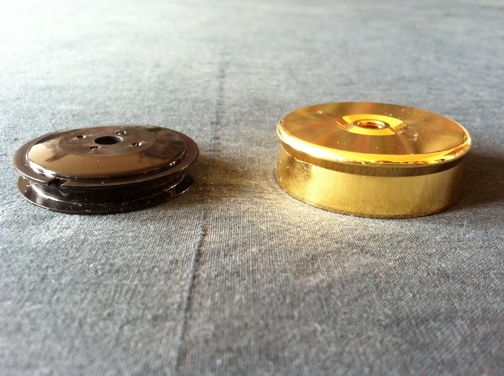

Yesterday I replaced the brass puck with a very old plastic puck from a 1984 Second generation Toshiba XR-Z70.
The puck is basically two plasic shells with a magnet inside, part of the clamping mechanisme hidden inside the player.
It took me some time to drill a centered precise hole 6mm in diameter which has no play.
Using a 6mm drill would give too much play, I used a 5.8mm and polished the hole until it reached 6mm.
But it worked!
The weight of the modified must be about one fifth of the original brass puck The pressure is now obtained by the magnet and not by weight -
like in 99% of all CD/DVD/Blu-Ray players and computer drives out there.
My X5000 works flawlessy. Pressing the the "Stop" button makes the CD stop in a fraction of a second.
But I will also have a lighter puck milled from aluminium and POM, using magnets as well.
Maybe DIYers want to step in?
I will post a first draft of the design tomorrow, along with a photos of the
mod with the Toshiba plastic puck.

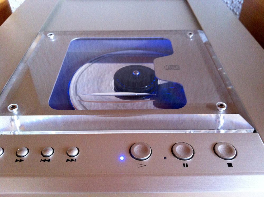

Here are the photos of the mod:
The original brass pulley and the preliminary replacement in action.

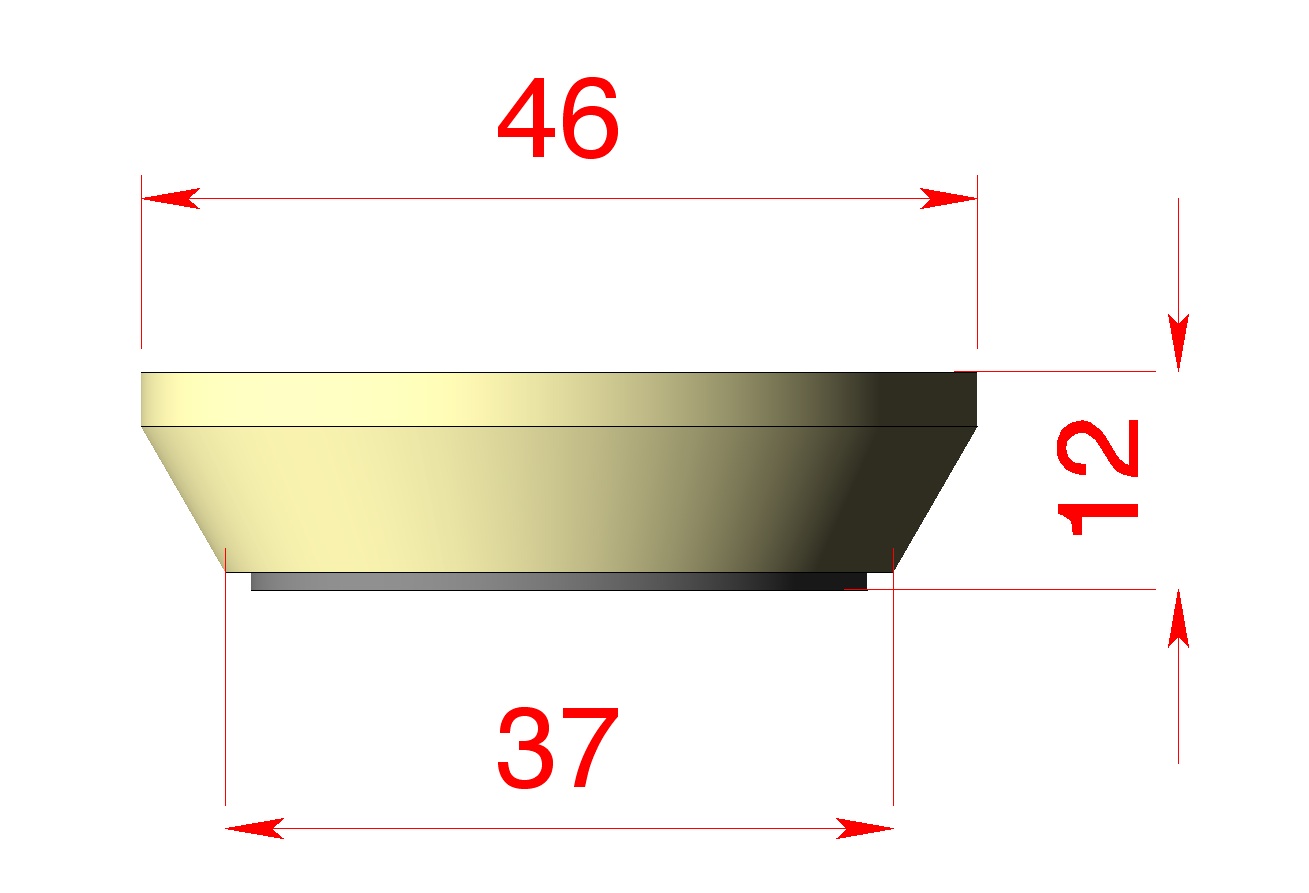

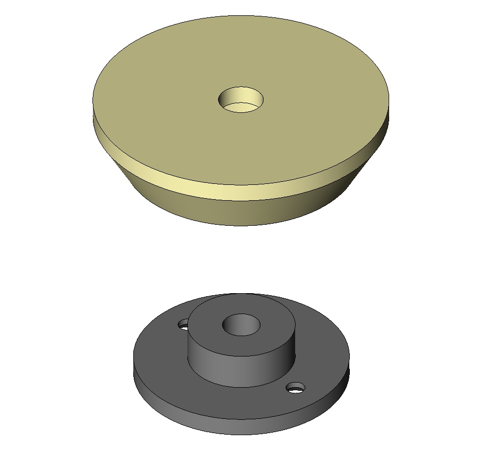

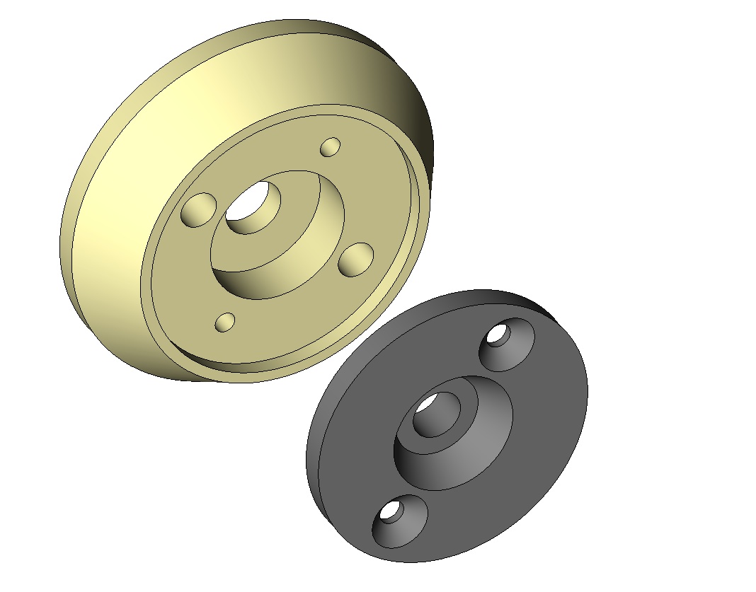

The drawings are the final replacement, made of sandblasted anodized aluminium, (yellow) holding two Neodyme magnets (not shown) and a Polyoxymethylene base (black).
It weights a third of the original brass pulley! Still the Neodyme magnets provide enough clamping force.
Having a larger quantity milled and anodized would not be very expensive; most of the cost goes into preparing the CNC machines.
So everyone using a fixed pickup player is invited to step in!

I finally ended up in making the stabilizer linked below.
This aluminium stabilizer became bigger for better damping but still
weights half of the original brass stabilizer pictured before.
The final version has a center bearing from Iglidur
for better fit. The milling tolerance is 0,01mm.
The surface is sandblasted (using glass pearls) with a 25µm
thick anodizing layer. The temper of the layer is comparable
to corundum. The bottom is covered with 0,5mm
velvet to protect the label side of the disc.
