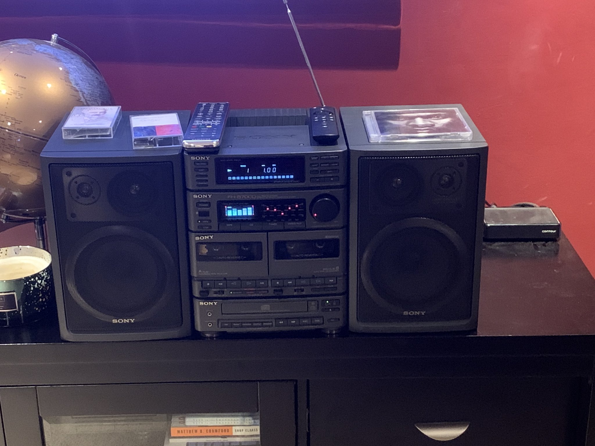

Dear Anatech (Chris),…Actually, you aren't. What you are going through might well help someone else.
I’ve just purchased a replacement to my lost Sony FH-B7CD with a FH-B70CD. Appears to look exactly like the other except for the speakers.
I just bought it off eBay with the excitement that everything works, and it actually does. There’s one hiccup, the CD will skip if there’s any shake or vibration around the unit. plays great otherwise.
I wanted to know my options with this unit. I’ve looked forward over a decade for a replacement system and wanted to know what I’m dealing with and my options; if I need to replace the optical head, repair it.
Also wanted to know if you still do repairs.
thanks,
Johnny
Hi Johnny,
Well, that is what is called a "lifestyle" product. They are more difficult to work on as a rule. Often the components need the rest of the system or main unit for them to work if you take it in to service.
Your issue might be caused by the laser head assembly, but it may also have cracked guides that would tend to throw out the alignment of the laser beam. By now the bearings on the disc motor might be worn and if you replace the head I would recommend the disc motor should be done as well.
I still do service, thank you. If you bring it in I wouldn't want the speakers. Most techs would advise the same as we have bench speakers for that purpose.
Thank you for your quick reply, but I’m going to have to mail it to you since I’m about 500 miles away. Could you let me know what it would cost wc scenario? Just want to budget in the shipping as well.

Thanks Chris, that’s what I figured. Maybe my next trip to Michigan, I’ll detour over to your area. The CD works for now.
Another thing I forgot is that there’s no battery, or capacitor, to save the memory of the radio stations you enter when you unplug it from power. I moved it to the garage to listen while working on the car and all 26 stations I saved went,… “poof!” 😂
Hi Johnny,
Okay, that might work. If you control how it crosses the border it would be a great deal less expensive for you. It just drives me nuts when outsiders add to the cost of getting a simple job done. It isn't fair, and it isn't right. Getting taxes and duties back like they say you can is a crap shoot. It takes time, effort and at least 50% of the time you don't get the money back. I don't mind paying taxes and duties on things that come in to stay, but for a repair that is leaving the country again it is just plain wrong. Mind you, I have a massive issue with paying tax on used equipment since governments have already received their cut when it was purchased new.
Your memory issue should be repairable. It's either a lithium cell, or chemical capacitor that needs replacement.

Your statement is true of any fault in any unit using smd caps. Amplifiers or anything. In fact, leaky caps (smd or leaded or with terminals) can cause any number of faults in any type of electronic circuit. Your comment isn't especially helpful.

47uf 4v..on the CD decoder board there are 3 of them hope that helps, heat them up with a soldering iron if they smell bad replace
Can also damage the traces inder the decoder ICs
Also if the unit uses a green multi pin flex strip be very careful when removing they can lose continuity again common fault in sony Cd units

Thanks, much better info. I'm always on the lookout for leaky capacitors. This is an issue with leaded and surface mount parts. Very familiar with "that smell" and it's problems. Cleaning conductive residue is a big pain. That residue is invisible unless you see corrosion damage (then it's bad). It isn't unusual to have to depopulate a PCB in the area of one of these capacitors in order to clean that stuff up.
Sony flex PCBs are famous. I hate them with a passion.
