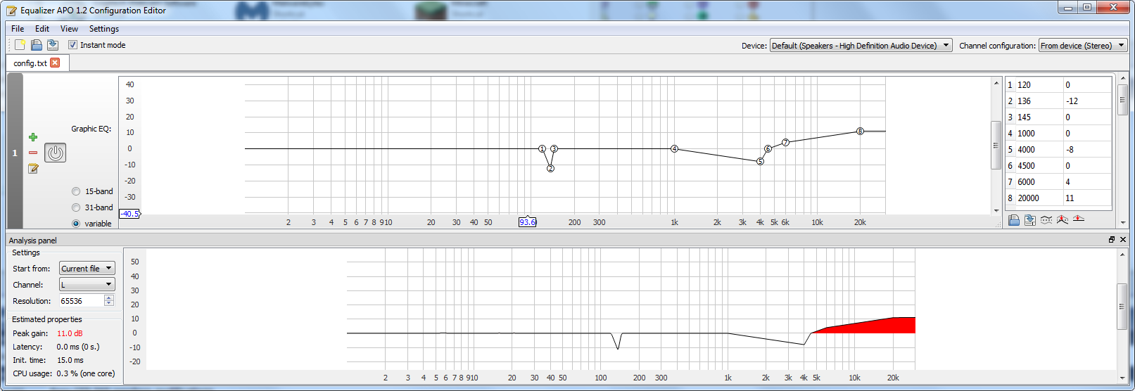

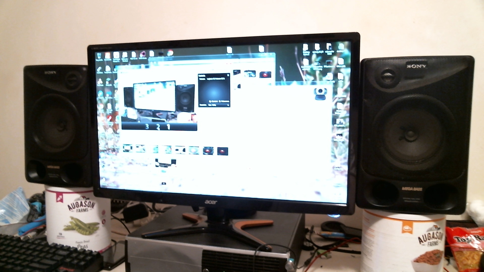

got some sony CFD 560 "dual cone integral mega bass" speakers
They came in ok-ish condition. working. just needed some touch ups
I decided to open them both up clean them out and put some acoustic stuffing in to dampen the vibrations.
I then applied a custom EQ tweaking it to sound as flat as possible and balanced. reducing any peaks (only major peak is around 137hz because of room gain really)
tweaked the midrange and highs a little and now they sound very crisp and way better than without an EQ
I also super-glued a small square of cardboard on the inside of both speakers on one of the "bass ports" on both speakers lowering the tuning significantly.
reducing the boominess and improving the bass massively around 50hz they actually produce clean bass enough to really hear it audibly and it doesnt just sound like a bunch of overtone boominess anymore.

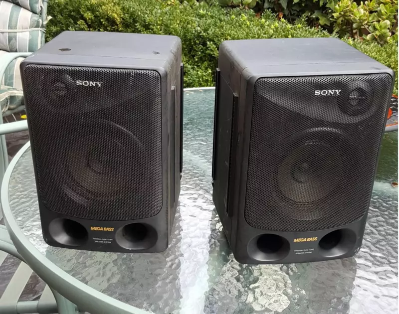

the speakers look like these
not the exact pair I have. don't have any personal pics of them yet but this is the same model as what I have

The little tweeters on the top on these speakers are as good as fake sadly they produce almost no sound at all. they are just terrible low output piezos. Also I dont have any measurements but I'm pretty sure these have a decent to alright frequency response after setting my custom EQ up. I dont hear any bad peaks or dips when running through the frequencies with
Online Tone Generator - generate pure tones of any frequency
it sounds pretty flat and good to my ears.
I'm not sure how you could set up a crossover with these. theres not really any ideal way of replacing the piezo with a proper tweeter of any sort without some modifications to the speaker cabinets.
otherwise just having an custom equalizer seems to work perfectly.
