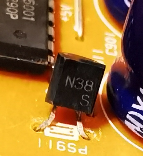

Annnd I almost killed it.
I must have shorted +5V with ground while preparing for the adjustments. It went flat out and after some tracing it became evident that the microfuses need replacement.

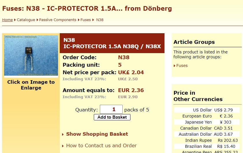

The afflicted ones are definitely PS901 and PS911 (PN 1-532-675-00). Do you guys know where to find a pair?
Thanks!
JZ
Oh dear... be careful what you are doing.

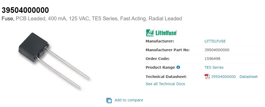

Do you know the current rating of them? What are the numbers on them? For a lot of these you multiply the number by 40 to get the milliamp rating so a T10 would be a 400ma time delay, an F10 would be 400ma fast.
These things were common as a spares item years ago but I can't find any listed now. There are alternatives that might fit.
Wickman fuses also might fit if the leads were long enough. You could try fusible resistors as well.

It's breathing again, with both PS901 and PS911 replaced by N38s with same current rating. Thanks for the references.

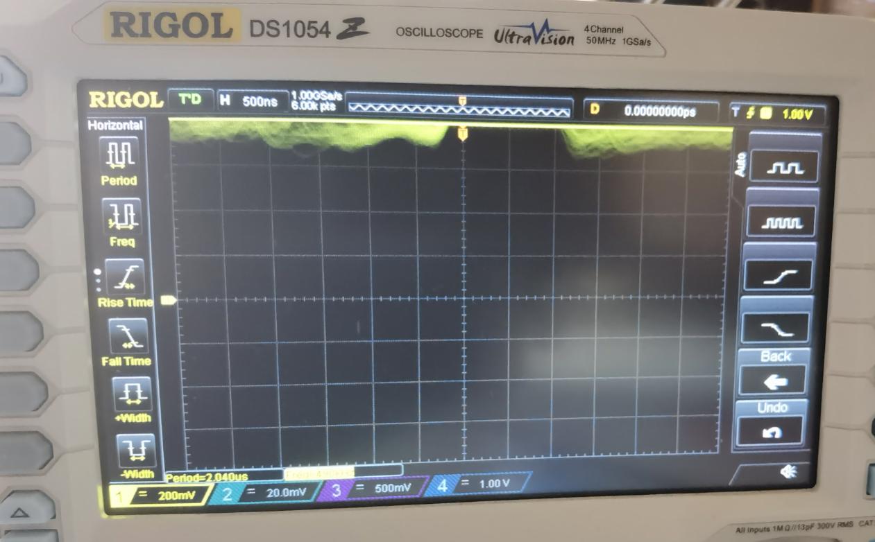

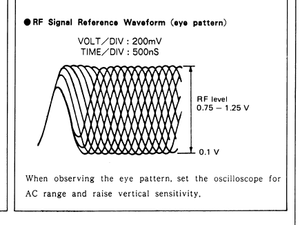

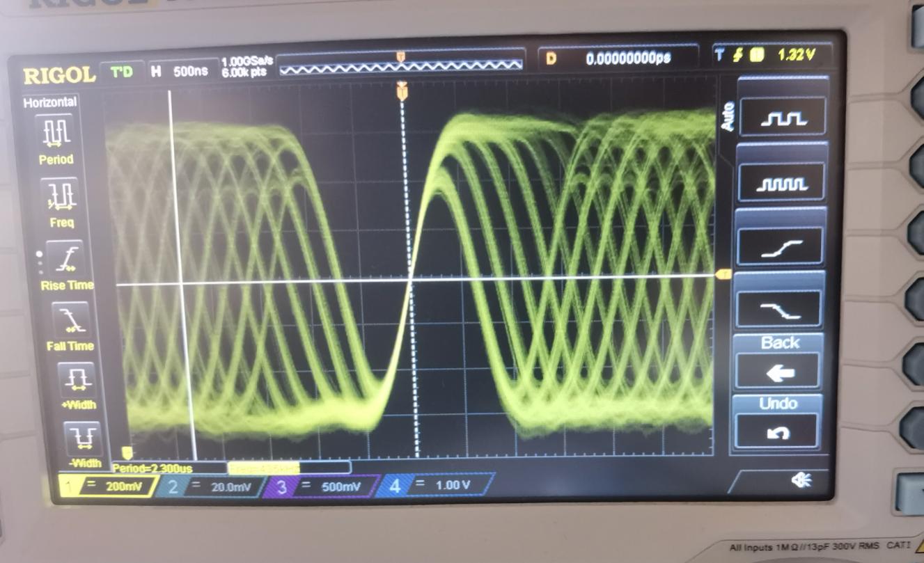

The E-F didn't require any adjustment. Nice, symmetrical waveform at 2Vpp. The eye adjustment did yield some improvement (eye got bigger) while the "RF level" held steadily a little under 1.25V, just as required. Something however left me wondering.
From the manual, it seems the pattern should have a 0.1V DC component. Mine does have a DC component, but about 0.8V instead.
cdp-m97 eye.jpg cdp-m97, dc component in eye.jpg cdp-m97, eye pattern, manual.png
It plays flawlessly, regardless. Should anything be done about it?

I wouldn't worry over that either. The so called 'ground' referred to in some of the manuals for RF measurements is in fact a virtual ground (going from memory) that is really floating at 2.5V above the normal zero volt line ground. A real problem with using such a virtual ground is that the test equipment can create shorts via the probe ground leads, particularly if you have a mains grounded scope and player.
I always AC couple the scope when viewing the RF and simply use a more convenient conventional ground tbh.
There's a specific RF ground test point which was used instead of the chassis ground.

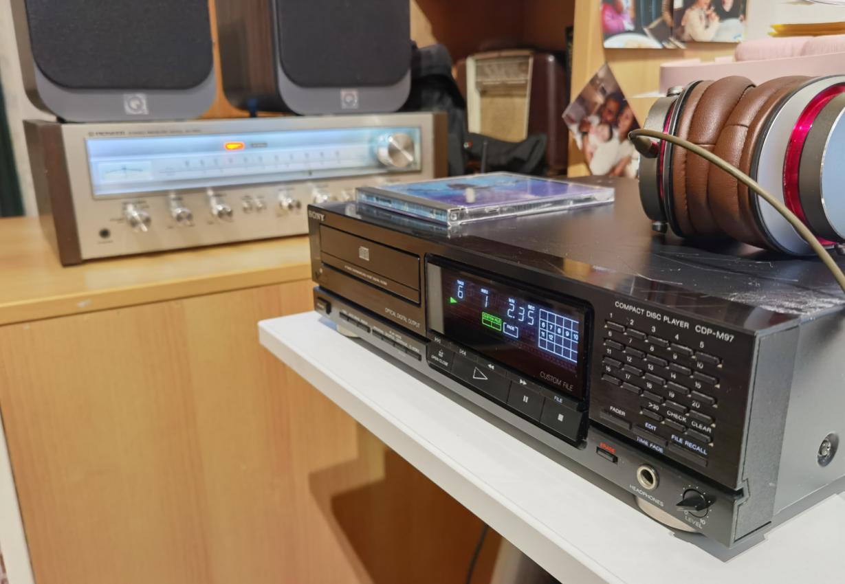

Here she is in all her glory. The face plate is in mint condition, although the metal cover shows some serious wear and tear as it was the bottom element of a Hi-Fi stack. I'll probably address that later with black matte spray paint.
A big THANK YOU for all for the great insight on CDs, expertise sharing and guidance.

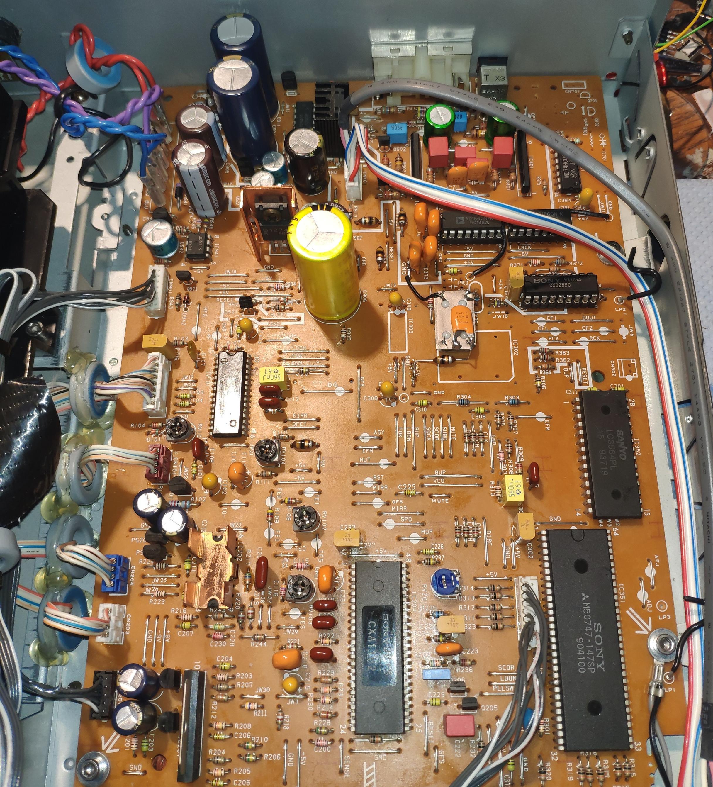

I try to hook up onto this thread with my "problem" - I've recently got hold to a almost vanilla M97.
While it works really fine and is in superb condition, I recognized one problem with the error correction. After recovering from shocks, the sound changes significantly permanently, at one time it behaves like a lowpass, the other time more like a highpass. What the hell is going on in the Sony IC's?
AD1860 (CXD2550 configured to 18bit frame size)
replaced most of the 'lytics as well as some film caps (Philips SAL ftw!)
dedicated osc
general design not very good given the one-for-all +-5V regulator, and no RC-low-pass filter as compared to the Philips CDPs, every ICs 5V is running straight from the regulator 5V, no R, no L.
Nevertheless, a nice unit.

Sounds a very strange problem. Hard to say without actually hearing it for real but the first thing I would do is hook it up the audio outputs to a dual trace scope and see if anything obvious is going on. Use test discs of frequency sweeps.
Are you sure it is not something like a dry on the output sockets causing some out of phase effects as a connection goes open circuit.
Well, it was some kind of intermittant contact. Also, I noticed the remote control didn't work at times. Since I disassembled the whole unit and refitted it, the symptoms disappeared. Apart from the DACs and the XO, this was a "L" and "C" job only, Opamps and the usage of the DAC internal I/V remain. It is a fun machine compared to the Philips CDPs I'm usually into. Disassembly and testing is way more comfortable vs. Philips.
I'm still intrigued to replace the CXD2550 with something like a SM5813. Anyway, it's now out to be compared to a CDP-X505ES by a friend.
