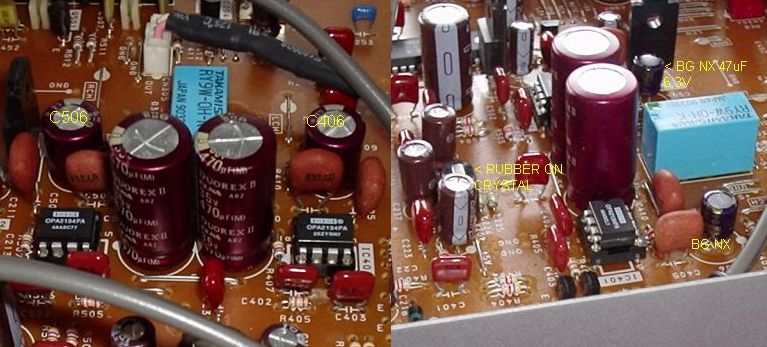

Have a look at changing the output caps C406, C506 (non US model only where IC203 is CXD2552Q) to Blackgate NX 47uF 6.3V. I've also used Nichicon ES 47uF 50V with very good results.

Meanwhile, I'm thinking of the cap replacement you recommended:
Attached is picture, can you please verify that the C406 and C506 we see there are the ones you mean? They are right after the op-amps so it would seem logical 🙂
Have a look at these pics. The first shows the original caps which are 47uF 63V Duorex and the second shows Blackgate NX in position.

Thanks, yes, they are the same that I thought of.
