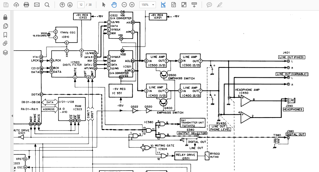

I think a lot of Sony's have separate Analogue and Digital Mute Lines.
The Analogue Mute will still be working but the Digital one (if you've bypassed the Digital Filter) won't.
You will need to make the Digital Mute line also activate the Analogue Mute Transistors/Relay. I am just working out how to do this on a Sony CDP-227ES.

The Analogue Mute from the System Control IC301 Drives IC940 then Q521 and then the Mute Transistors themselves.
The Digital Mute comes from the System Control IC301 and feeds the Digtal Filter on Pin 9 but won't have any effect if you've bypassed the Filter.
You should be able to use the DMUTE feed though to also drive the Muting Transistors using another Transistor, it may need inverting but should be possible.
It'll be the DMUTE that mutes during Skip etc.
P.
P.

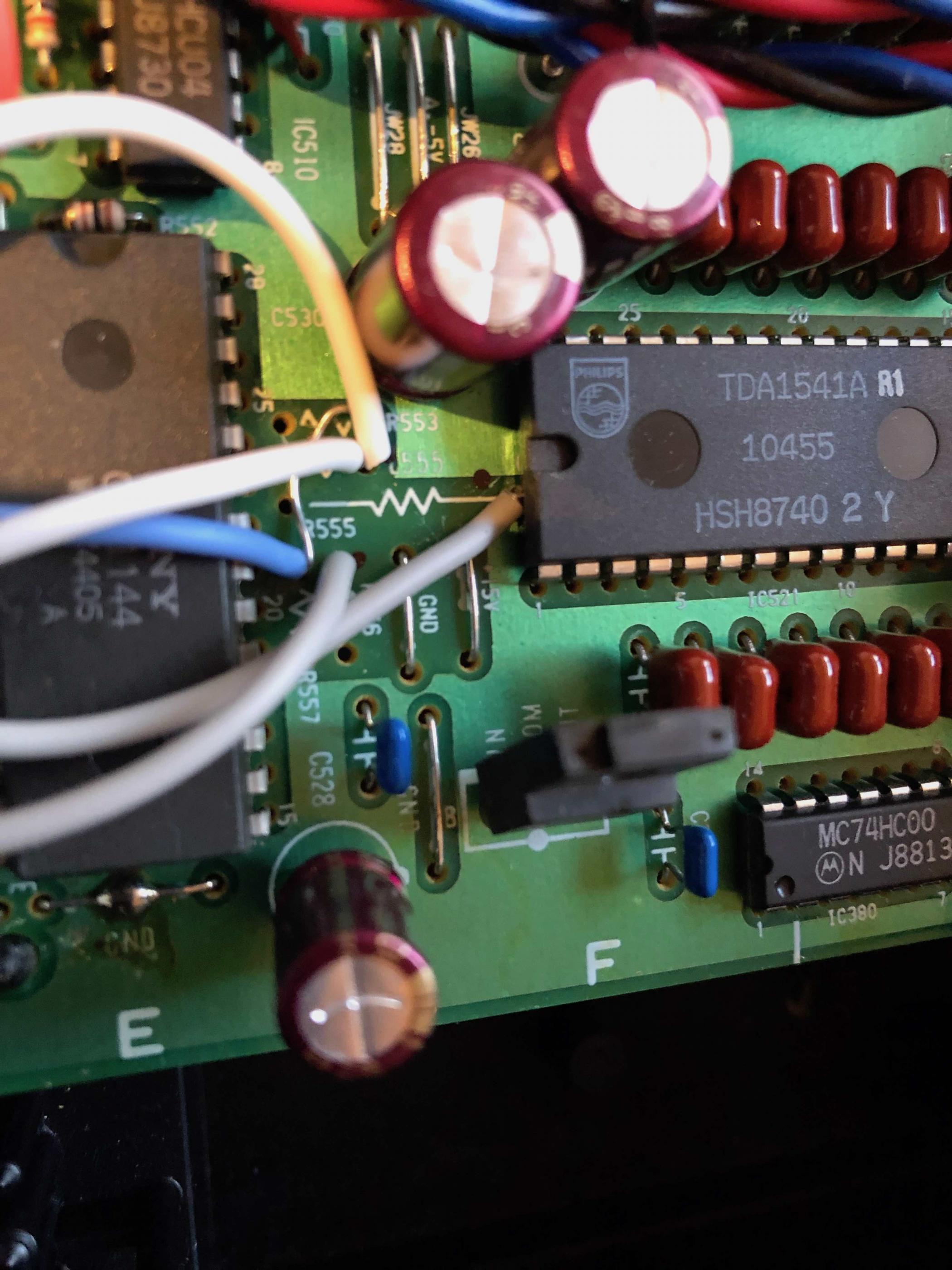

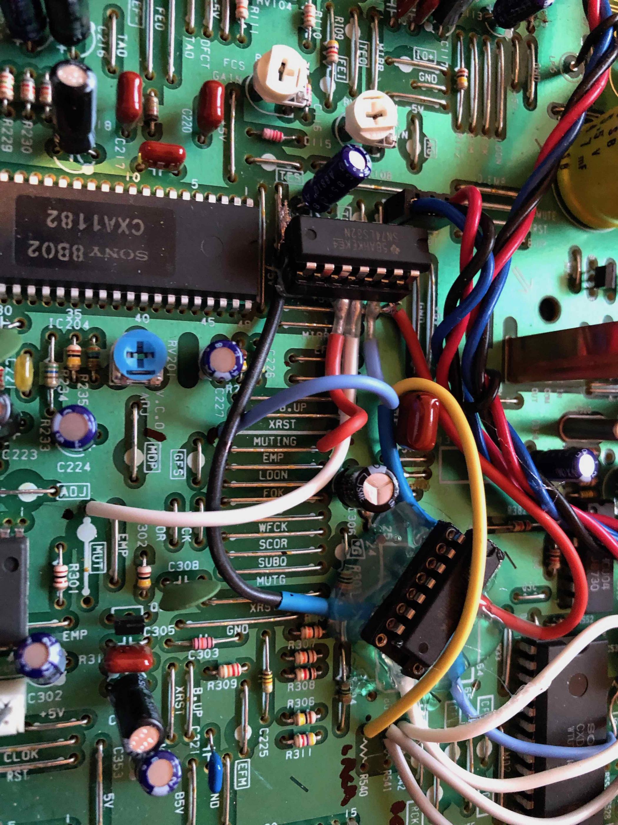

Hello everybody.
I have been working in avoiding the noise when skip forward or back a track in a NOS sony 227ESD using the method on the lampizator webpage. The key point is, as Percival007 said before, the DMUTE line. I have solved the problem using a 74LS32N (OR GATES). You have to find the Analog mute line and D mute line, make the OR operation with the 74LS32N and then connect the output of OR opertion to the input of the 74HC02P that control de activation of the mute relay. I have done the MOD removing two bridges in the board. If anyone is interested I can post photos of the MOD.
Please post photos of the mod
How can upload images?, I am trying to make and album in my profile and there is no option 'Add album'.. Any suggestion to upload the photosP?
You have to upload the images as attachments.
Click the 'Go Advanced' button when replying to the thread and attach the image files, which will upload them from your computer. Once they are uploaded they will appear as attachments, as below.
Thank you...

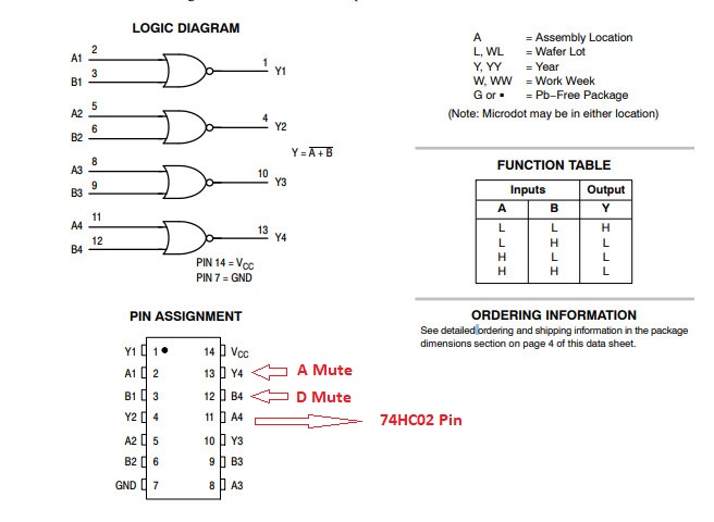

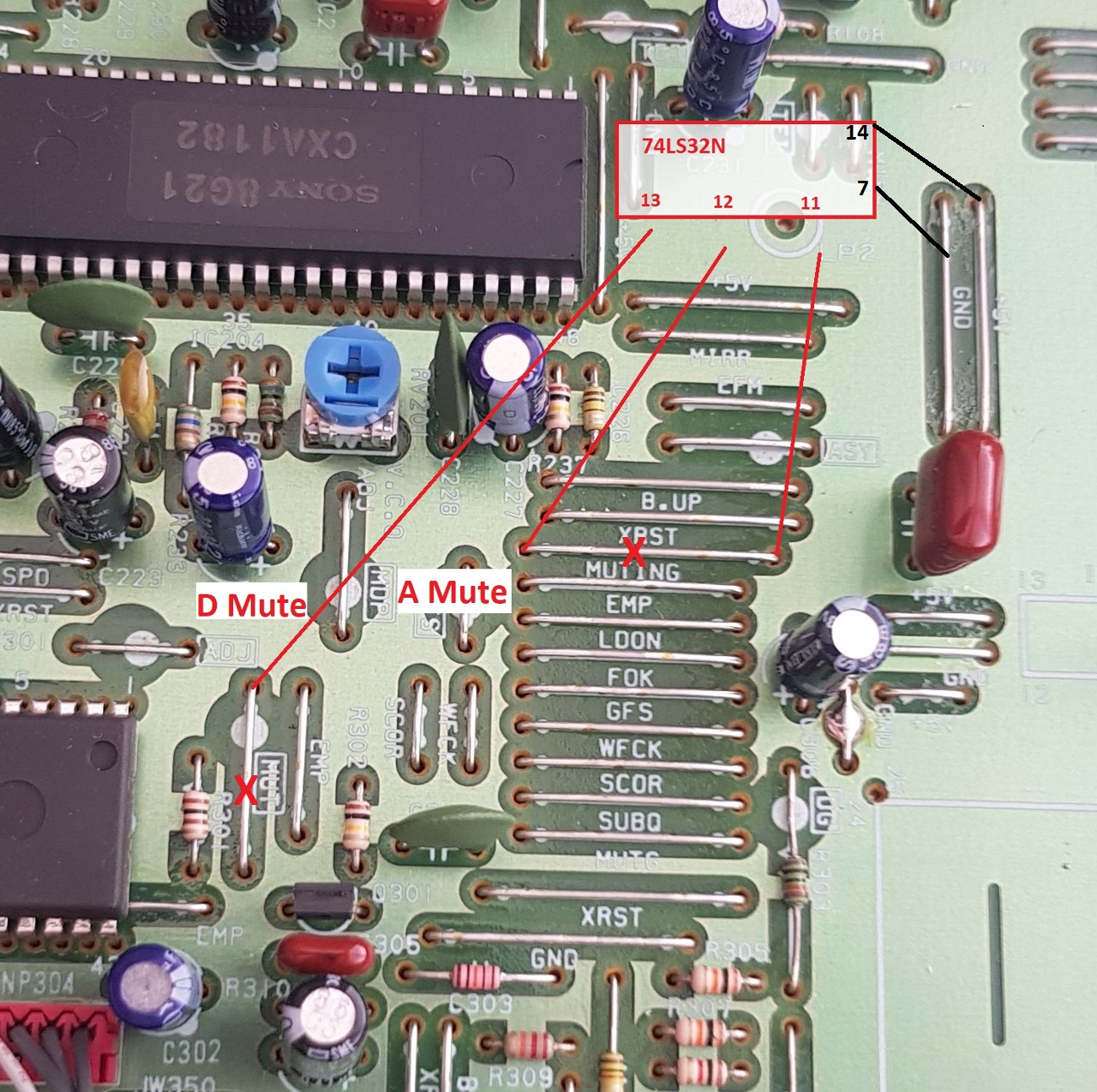

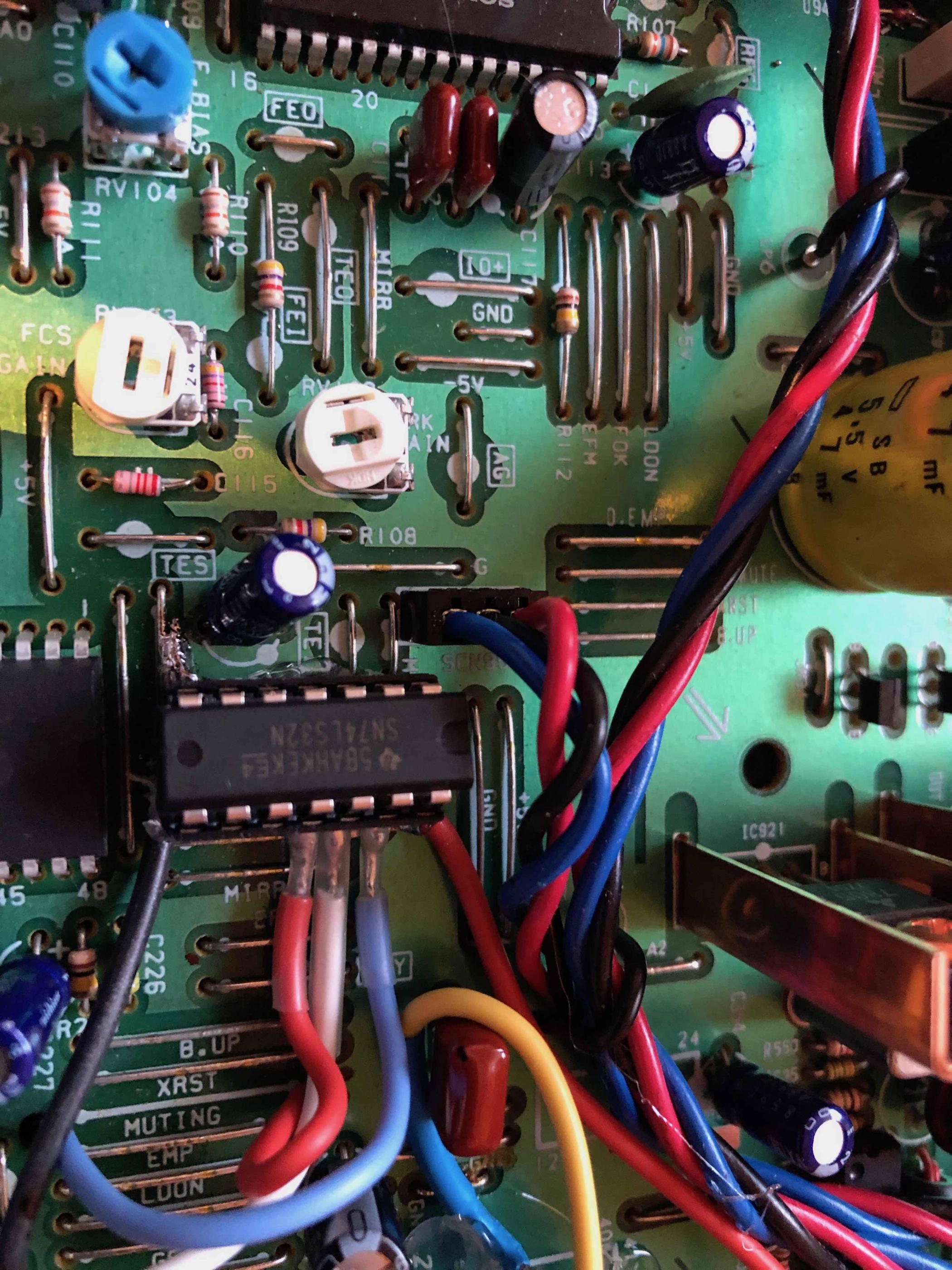

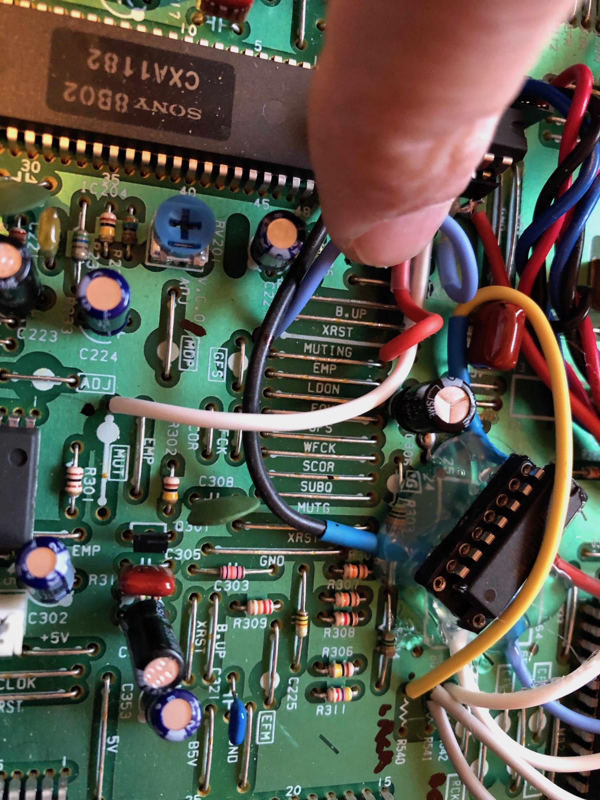

This is the 74LS32N (Or gates), I have just used one gate (pin 13 A Mute, 12 D Mute, 11 output to 74HC02).
Blue wire A Mute
White wire D Mute
Red wire, AMute OR DMUTE, to 74HC02 that drive the mute relay
Pin 14 5V
Pin 7 GND

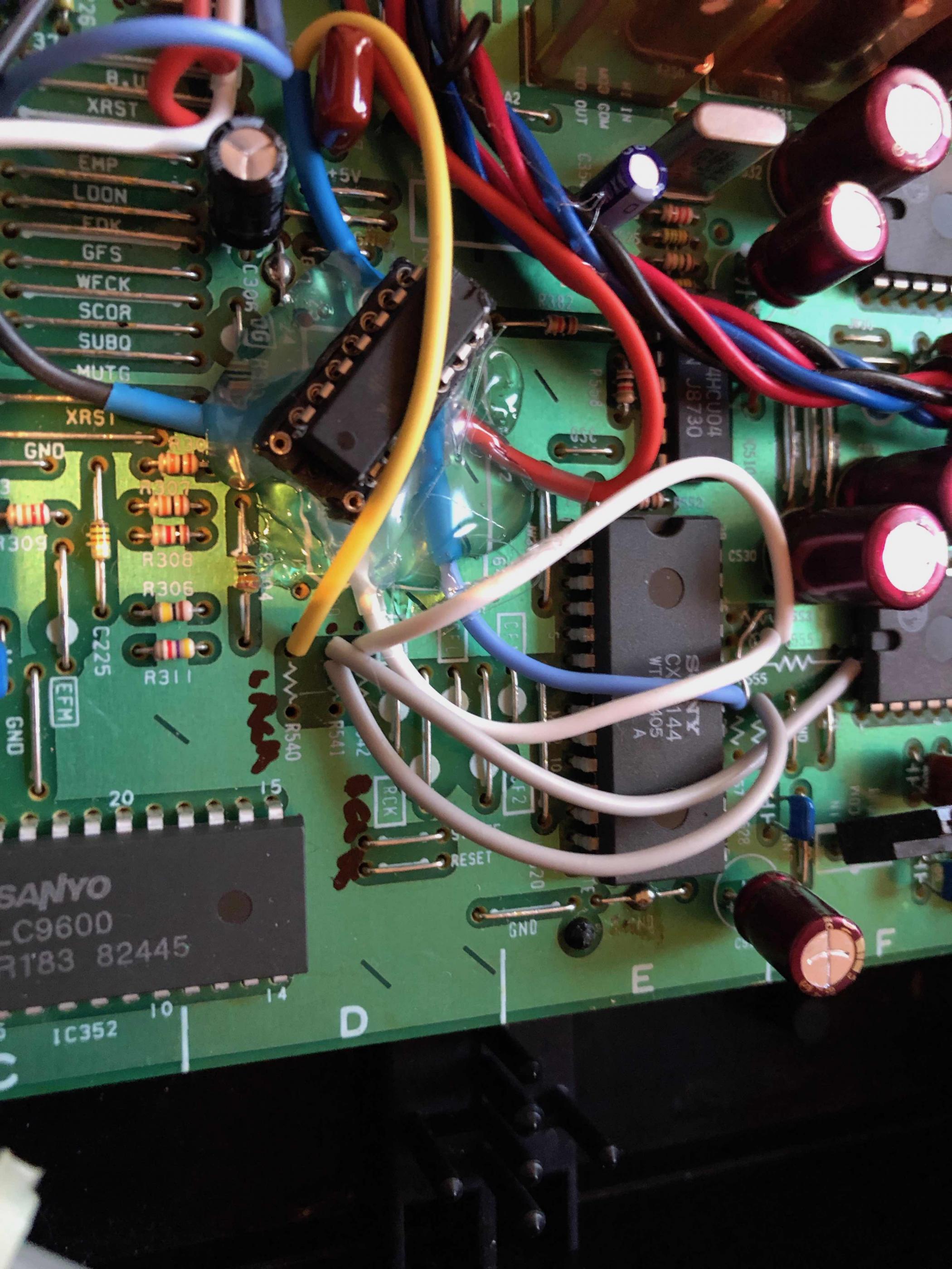

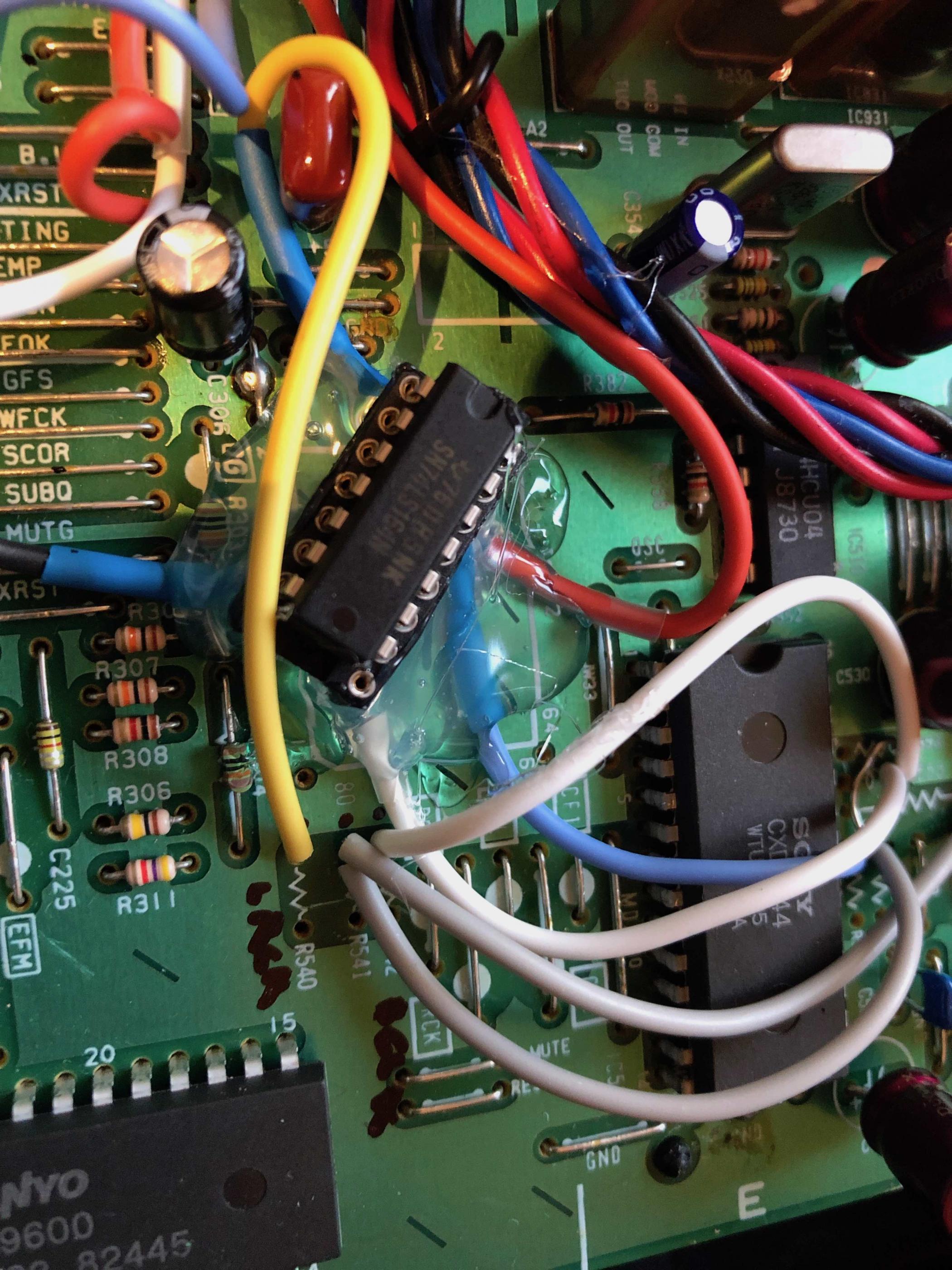

I have removed two bridges, where the white wire is connected and when the red and blue wires are connected.
From the first bridge, I take the D mute signal (white) that goes to filter (that is unused with oversampling).
From the second bridge I take the A mute signal (blue), and the second point goes to 74HC02 that drives the mute relay.
It is easiest to do that explain it!

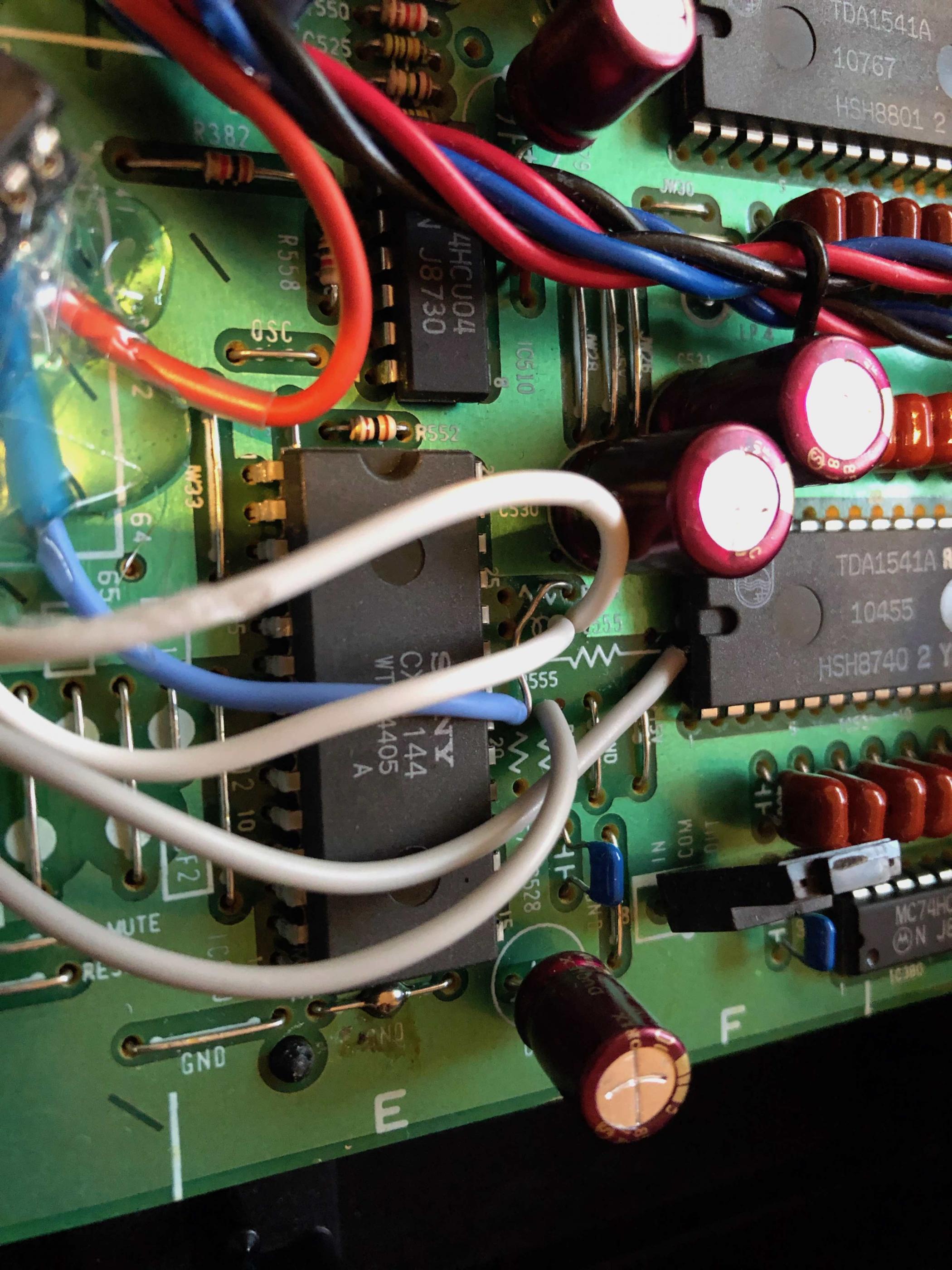

These other photos are related to NOS mod based on lampizator webpage (but removing the resistors that are unused...) in my 227ESD.
Exellent! Something similar can be done with the 950.. I will try it in the 950 when I receive it (some days ago I bought one on eBay)The main diference is that there is no relay, bit muting transistors.. I’ll post the MOD if I get it!
Oh, yes I forgot that difference. I'll wait to see how you get on with a solution for the CDP-950 before breaking out the soldering iron
