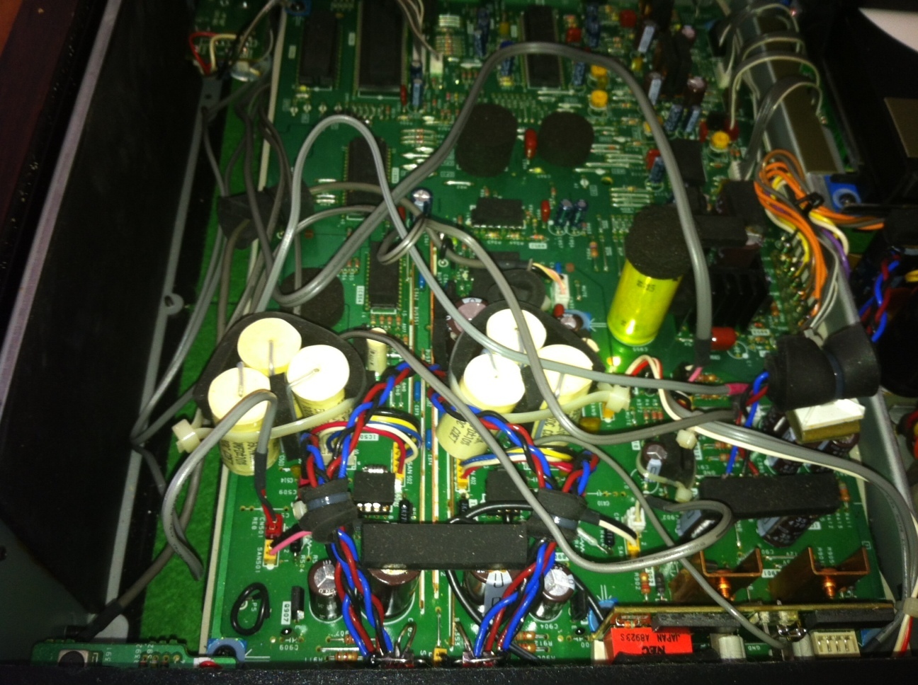

I recently picked up a Sony CDP 707ESD at a good price in pristine condition. The player has a very odd but appealing and indescribable character -- like no other player I've heard. It's extremely detailed (maybe the most) but also presents music in a very laid back manner. It's not very dynamic I guess. The bass and weight of the notes are tremendous however. It seems almost contradictory however that's what I'm hearing.
I like it when it's playing well however theres a very glaring flaw that I'm hoping can be alleviated. On certain tracks (usually where there's lots going on or higher than normal dynamic swings) there's some very audible distortion and the player seems to lose control a bit. It weird however because some cds play through perfectly with no issues. It's not recorded distortion as I've tested other players and they've rendered the same passages with clarity.
I've read (on here) another member describing similar issues. One thing that alleviated the problem to a degree is switching the input from "fixed" to "variable" line. The problem here is that to get the player up to desirable levels you're increasing the output impedance from an already high 200ohms.
I'm wondering if there's a known fix for the issue. I'm considering replacing the clock, and certain key caps (not sure which ones would help if any).
Info or details on the issue would be greatly appreciated. Thanks in advance.

It's possible you are hearing the ill effects of the horrible GIC filter used for low-pass. You can find out quite easily by simply removing opamps IC413 & IC513. There will be plenty enough passive low pass elements leftover that there's no worries about leaving it that way permanently, if you like the sound better, which I am sure you will.
There is NOTHING in the signal path that should be coming anywhere close to clipping/distorting on even the highest level peaks, so if there is distortion, there is something wrong with the unit. Normally, the symptom indicates bad output muting transistors, but this player thankfully does not use any. Depending on exactly the nature of the distortion, it is somewhat possible that you could simply have alignment issue, which would be indicated if similar material/levels distort with one cd and not on another.

It's an epic machine, and worth fixing I think. If it has a glaring flaw there's probably a fault.
The variable output is simply the fixed one, after the volume control pot, and before the headphone amp. If the pot is set to maximum, then there should be no difference between the two outputs. If the problem reduces when the pot is adjusted, and compensated for with the amp's volume control, then that narrows down the problem to the output op-amps, your cables, and your amp's inputs.
Are your cables and amp inputs normal?
Is the problem the same on both channels?
What measuring equipment do you have?
It's a particularly complicated circuit. It would be worth finding the fault before you start swapping parts.

A scope check would be useful here.
Have you tried a test disc disc recorded at 0db to see if that sounds clipped ?
A scope check of the front end (RF) wouldn't go amiss either. Some players can sound distorted when the RF is marginal and things get "busy" on the disc.

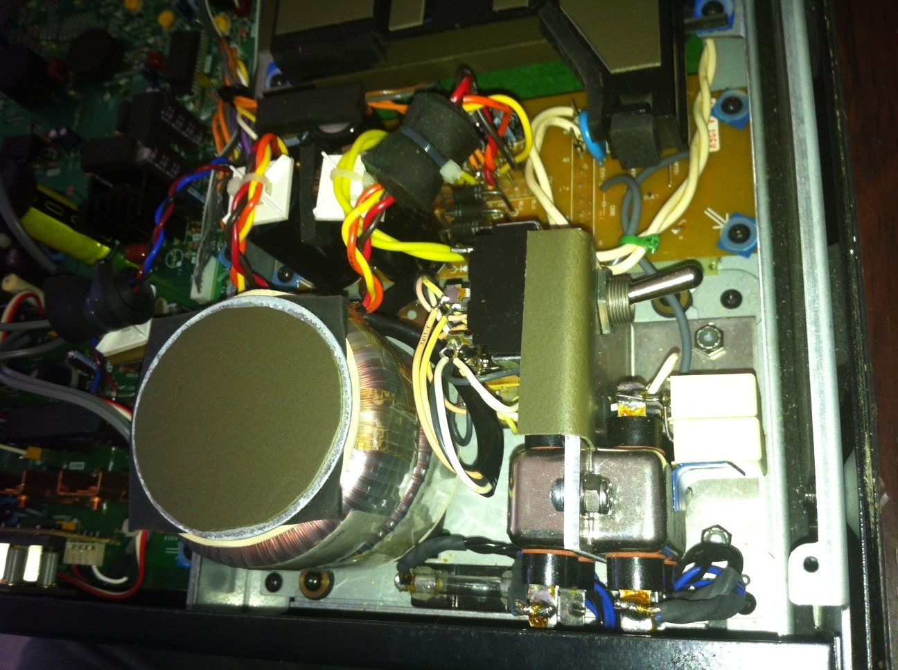

I brought one of these new when the first came out and one night I notice my tweeter quietly singing away to itself with nothing playing, got out my lowly scope and low and behold 5mV of 5MHz (from memory) on all the outputs, even without a disc inserted, sent it to Sony Service and they said it was acceptable. Eventually both tweeters failed
I think the ground is contaminated. One of the jumper connections seen here carries what I think is the offending signal.
Never did fix(?) this as when I changed amps, it stopped, my Hiraga 30W Class A amps didn't care about the RF unlike the Onkyo I used previously?

Appreciate all the suggestions and information. Seems like some opposing opinions here. Part of me doesn't want to open the thing up as it's so well built. That being said, if there's a known fix for issue I describe I'd happily do it.
In my observations, what I'm hearing doesn't like a ground issue but rather distortion (low headroom due to crappy opamps). There's no real "noise" except during crowded/dynamic passages on certain cds. I hear nothing coming through my amp/speaker/tweeter though I'm also using a class A tube amp. I've read that the analogue section in these models can be improved. I'll likely try removing the opamps described. Are there any others that should be swapped out? Furthermore is there a likelihood that replacing the caps help the issue? Lastly I'm wondering if maybe there's a issue which could be alleviated by recalibrating it.
I don't have a working scope at the moment but will look into getting one. I'm in no rush to start bastardizing the player though I do agree it's worth investigating and being patient with. Any other suggestions are much appreciated. Thank you.

I saw & passed over that 608ESD, as my professional opinion is that the mods looks rather scary, ill-conceived & a bit dangerous. There was never any valid reason to replace the stock transformer, and stacked toroidals is a really BAD thing to do, electromagnetically speaking. Also, the very strange choice of two power cords was done with absolutely no protection from the cables scraping against the chassis opening, which is a bit dicey. And the "upgrade work" in the actual circuitry looks like very little was actually done, and was done in a very sloppy manner. And all of those black foam-looking blocks stuck onto the tops of chips and things are absolutely useless crap. The "upgrader" who did this was a hack & total amateur.
I am going on about this, as the 608ESD is, IMO, a superior player to the 707ESD. With proper upgrading, the PCM58 is just a better sounding dac chip than the PCM64, and it really pained me to see one butchered like this. Sorry you stuck yourself with it.
