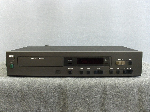

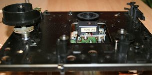

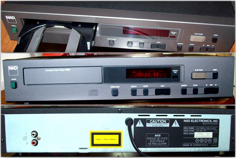

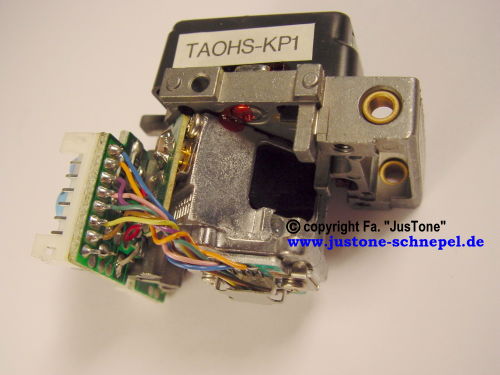

You are right - I was also amazed about the quality of this SANYO DAC, which is also inside in NAD 5320 and 5325 (optical pickup here: Olympus TAOHS series)

From the cheap compact disc players for me that one with best sound, realibility and life time.
