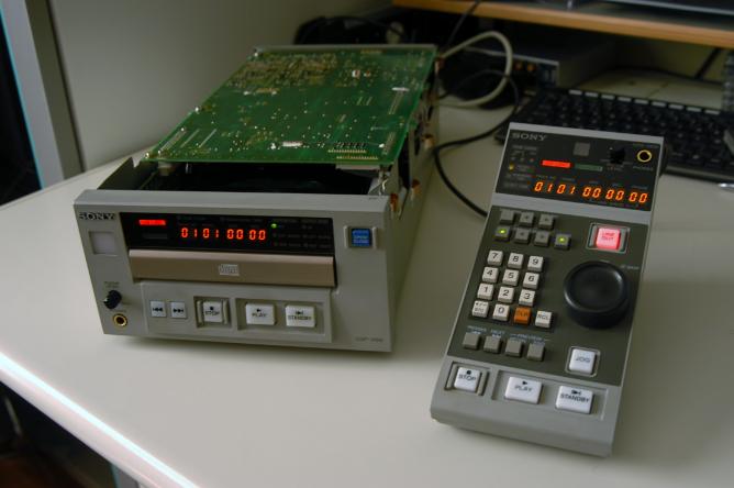

Forgot the picture from the unit, here it is...

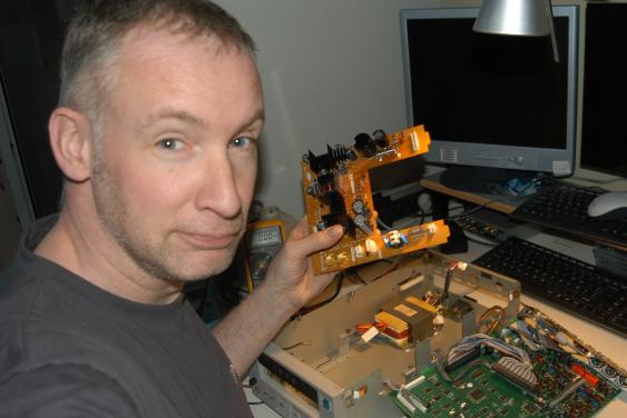

Hello Mooly thanks for reply,
Yes indeed it has to do with the power supply, I warmed it up the laser with hearddryer [not to close ofcourse] and the problem after colt start-up was still there. So I headed up the complete laser deck or Mecha-deck in Sony words. Totaly no result, the cd spins 10 times and stops. The displays says "no disk" Just for sure I wait 1 hour again to do a second test. I pull out the complete Mecha-deck so I can hear the power supply only. Okee I headed it up for 1 minute so all alu-coolers and components are warmed up, not overheaded just good on temp.
I start the unit again, surprise the Mega-deck detect the cd directly and after 15 seconds it plays normaly the tracks. Now by accident with measuring I blow 1 fuse N25 special fuse. Anyway that is not the end of the world because I can still order these. Now I'm not sure but I think like you said that possible the cabs/condensers are bad after 20 jears that is possible. I will replace them all I think to get sure the problem is fixed. After I placed them I can see with a scope if the is no hum on the DC Maybe is this the problem and get's the Mega-deck a bad DC on his input.
Unfurtunality the power supply is just a nightmare to get there, you must strip-down the whole unit, nice built but not nice for maintenance😉
