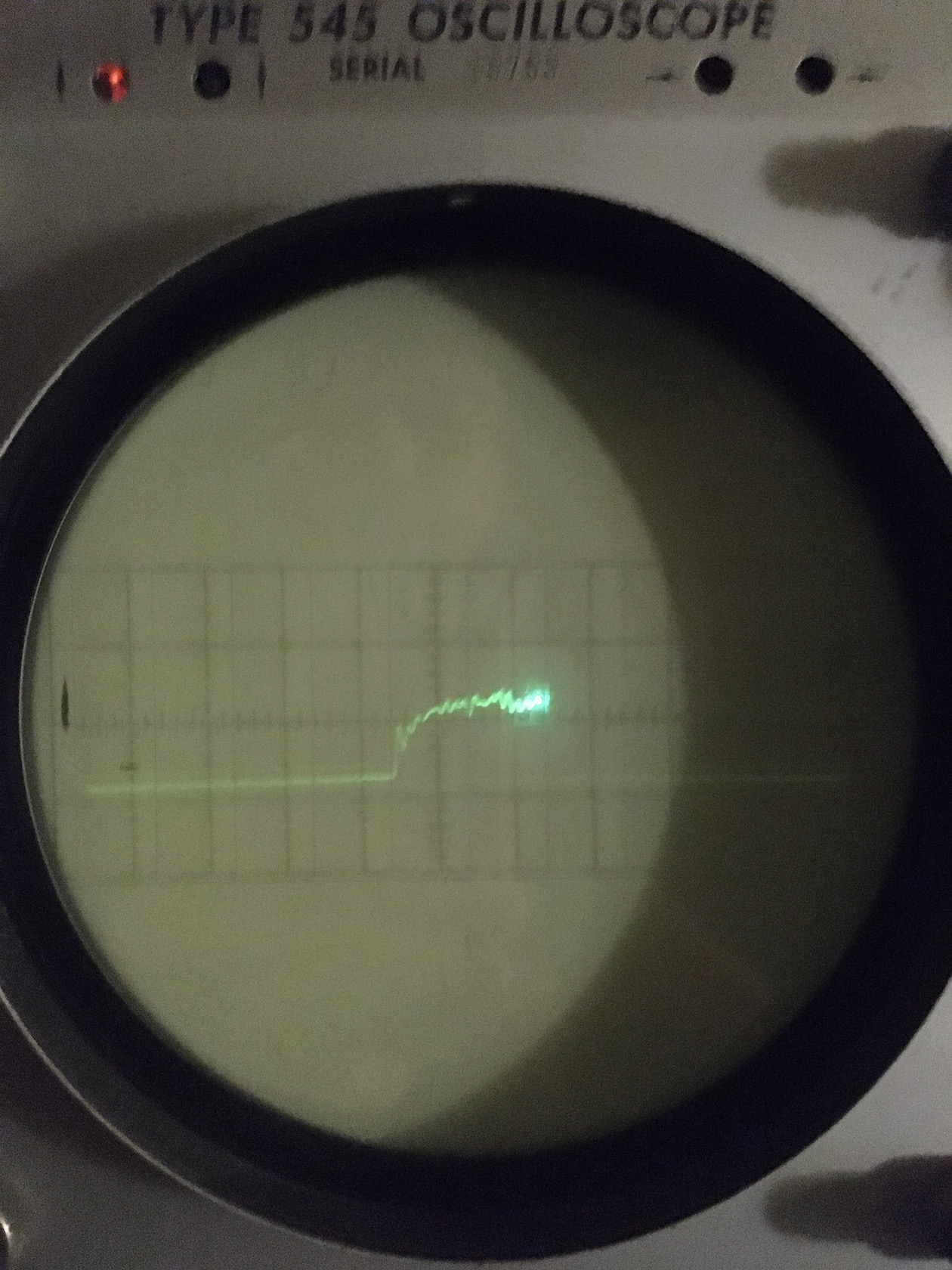

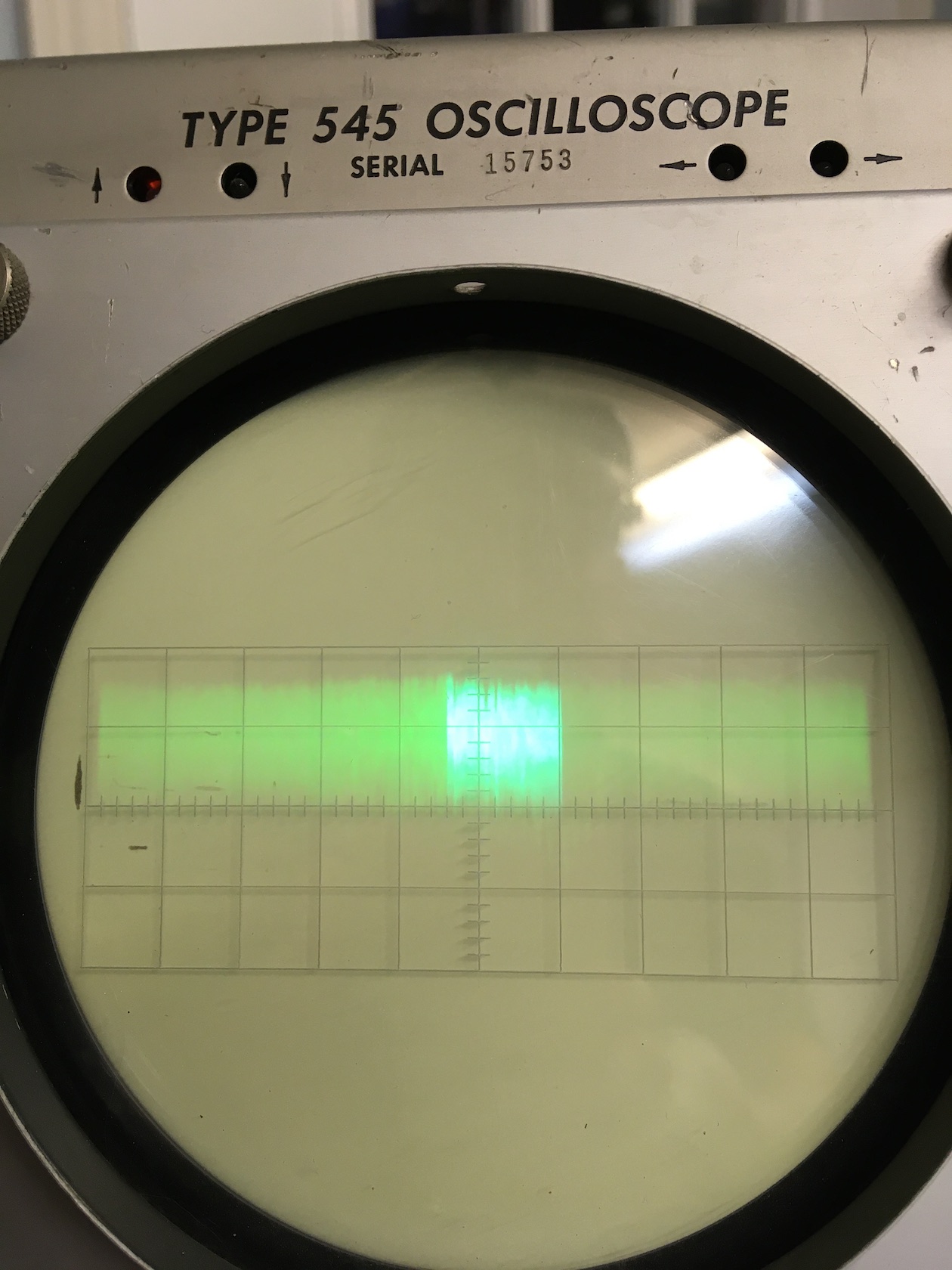

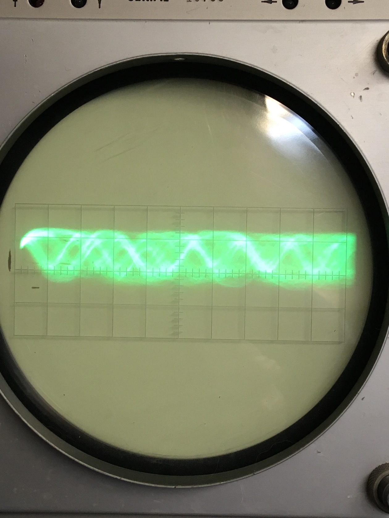

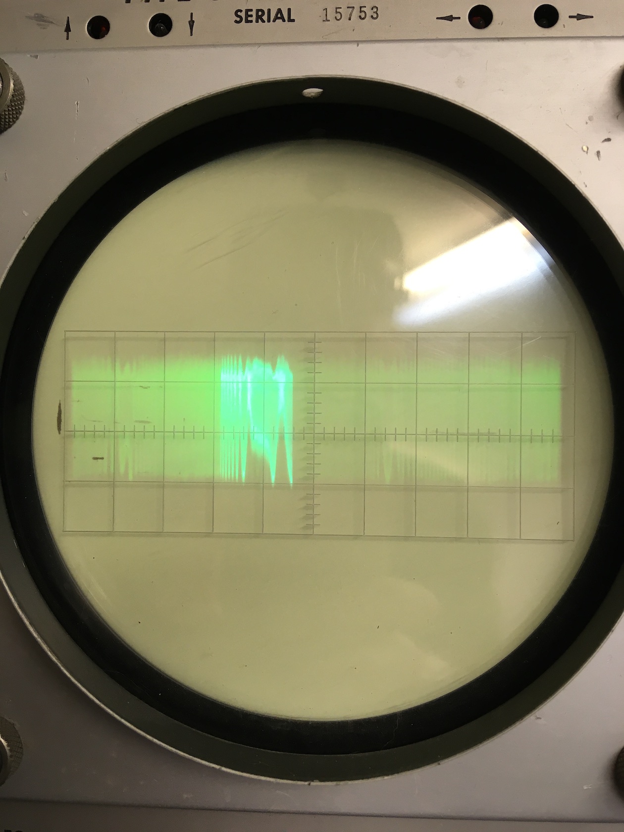

I whipped off some scope traces this morning before work. Didn't have time to check the sled.
VCO lock-in is obvious. With TP5 ASY grounded, the frequency is 4.22MHz. (I didn't photograph that.) With ASY open and tray open, f is 4.68MHz. With and disc spinning steadily, it's 4.32-4.33MHz. (The discriminator output is inverted.)
The manual's EF Balance procedure just has you open the loop (by grounding the slider of the gain pot) and adjust RV101 for waveform centered on 0V. TE gets smaller when the loop is closed. These traces are unfiltered and polluted with HF content. I'll try again tonight with a LPF in series.
Then I scoped RF, first at a slow sweep to show dropouts, then fast to show we don't get an eye. But note how the amplitude drops when I close the tracking loop. It shouldn't do that, and to the best of my understanding, only a misaligned grating can cause it. Please correct me if there are other suspects.

I wanted to show the tracking coil voltage ramping up smoothly for some seconds then skipping, but I didn't see it this morning. I'll revisit this weekend.

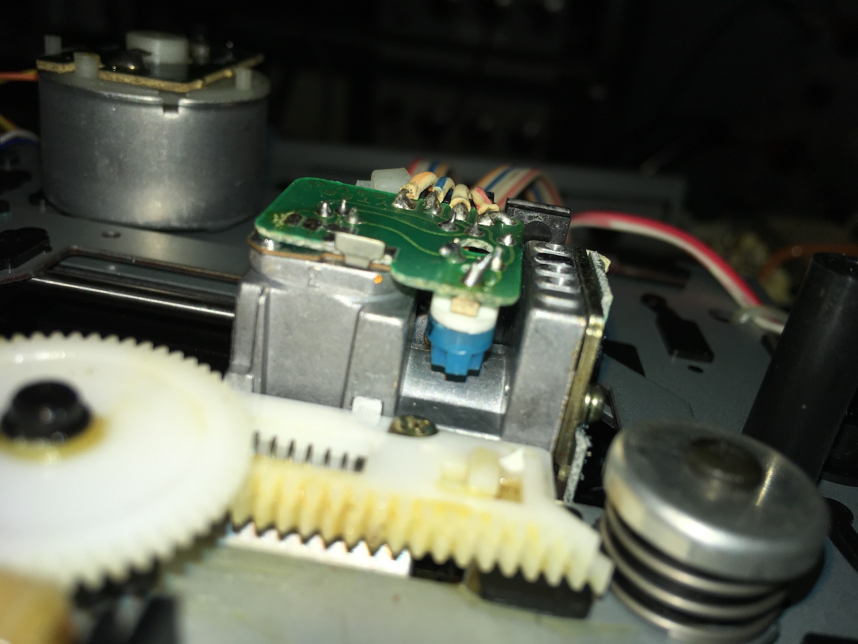

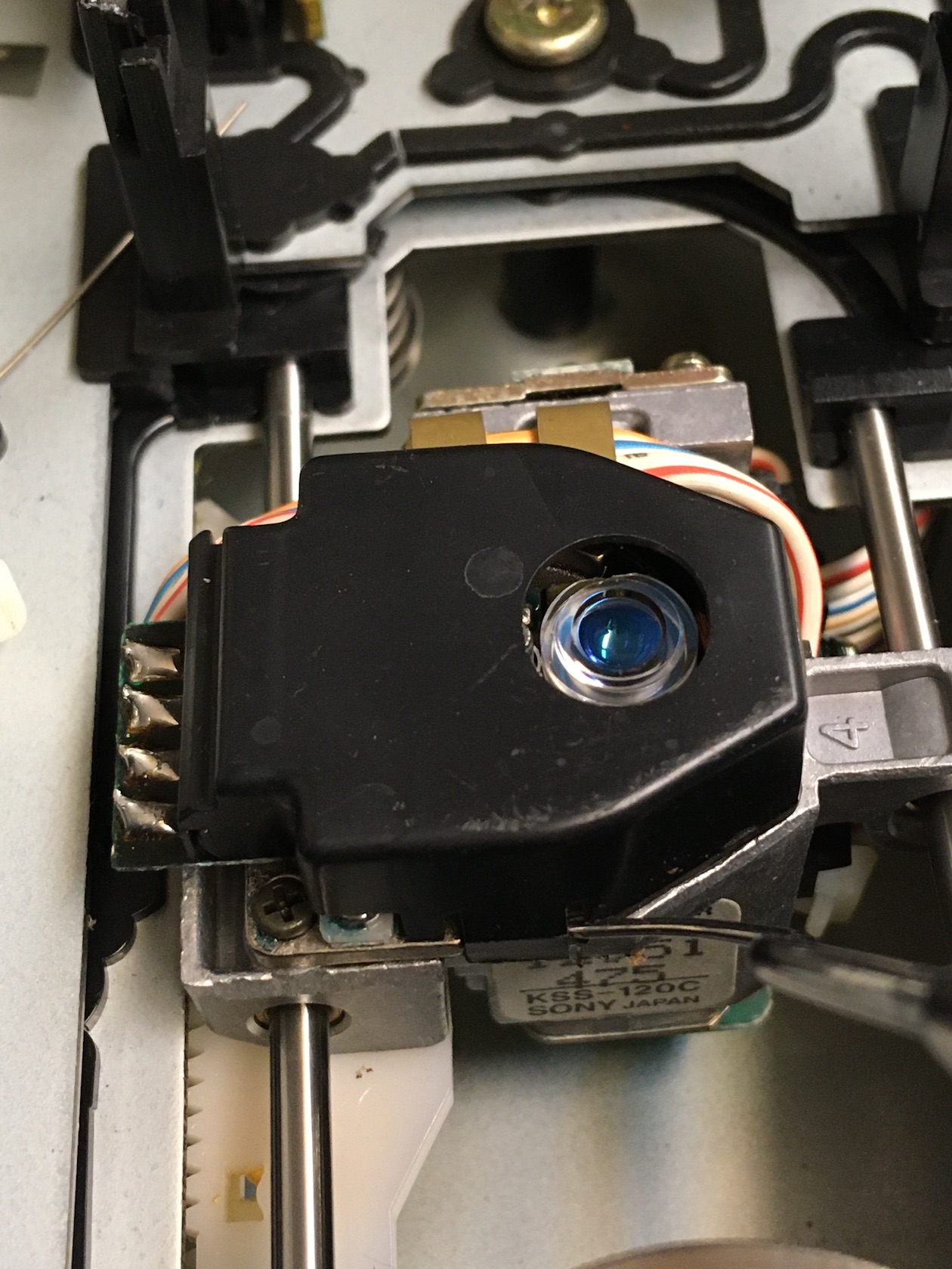

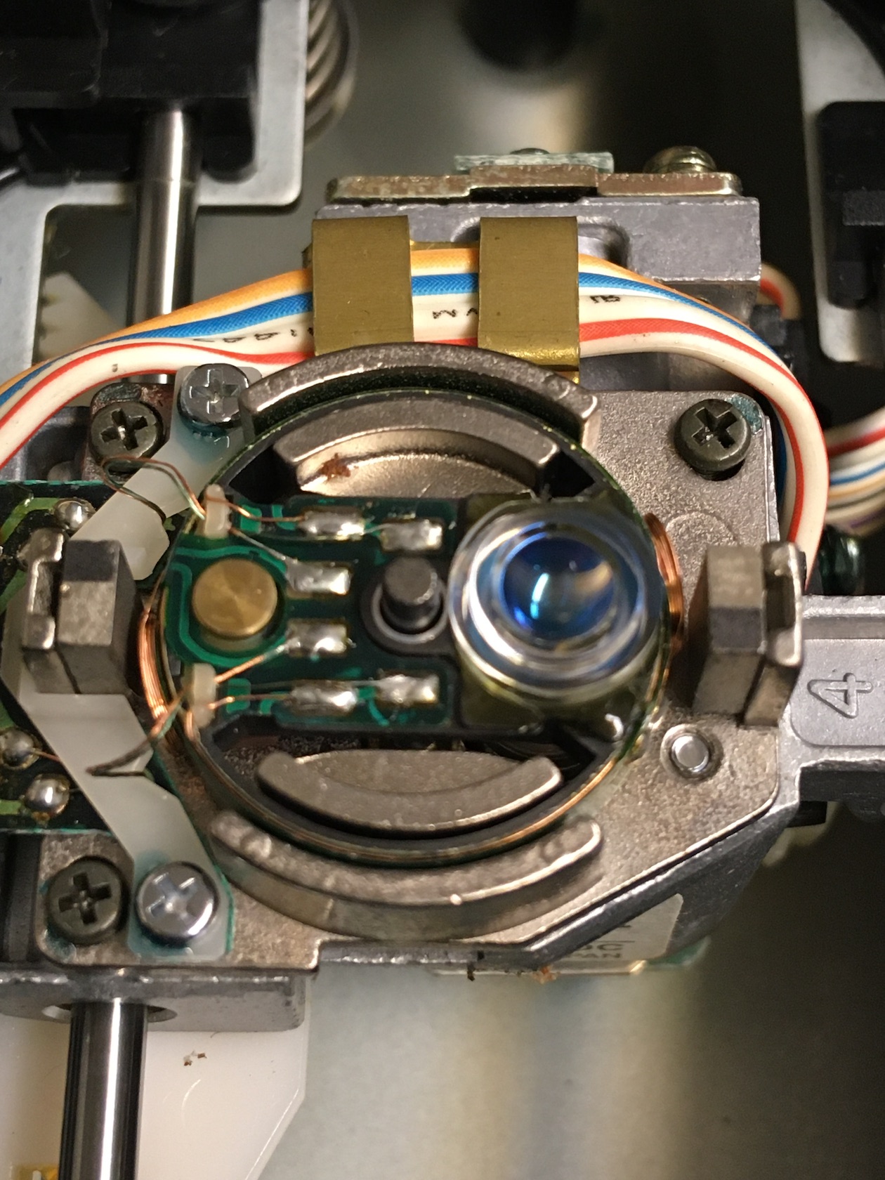

Four more pictures. I reach in with a dental pick to pry off the cover and show what's inside. The collimator lens looked perfectly clean so I didn't try to clean it. No plastic hinges here, it's a voice coil that rotates on a guide pin. The tracking coils are at 2 and 8 o'clock. It's not obvious in the picture but there's a half-covered hole at the bottom of the label that might be grating access. I'll know more when I look at the bottom. If there are tangential and radial adjustments, I figure they're the screws. I'm not getting into that.
The RF shows just a hint of an eye when it's at its best. I think this model's firmware doesn't hook the sled to TE until the TOC has been read. While looking for TOC, all tracking is handled by the coil - after all, we're supposed to be positioned at TOC anyway, right? (I think the limit switch is dirty and I will look into it. Once in a while we get positioned inwards of the TOC and wind up reading mirror or the human-readable text some pressed CD's have. That stuff really confuses the CLV servo and will overheat the transistors if prolonged.)
While looking for TOC, we track with the tracking coil to the end of servo range, then jump back and start over. As we traverse the range, RF starts out a jumble then gets better and better. (Relatively speaking.) The picture is when it's at its best, right at the end of servo range before it skips back. It is still weak and covered in jitter but you can sort of recognize an eye.
I am more convinced that the grating has rotated. Unless I see how to adjust it, I'm setting this player aside hoping I'll find a pickup someday.

That lens arrangement reminds me of the D50 actually.
If so then there could well be a 'rubber band' (some neoprene type material) spring at the rear and that exerts a downward pull on the lens once it is away from its lowest rest point. I once had one where the lens was sticky on that pivot point.
The eye pattern looks just like RF without tracking lock to me... which isn't much help 🙂
The voice coil assembly slides smooth on the guide pin. It looks like gravity is all that pulls it down.
The RF picture looks worse than the human eye and brain see it in person. You really can tell there's an eye, behind all the jitter. I previously attached a picture showing RF with TE open loop. That one's a solid blur; in addition it's almost twice as loud, around 1.7V peak to peak vs 0.7V when locked. You can also tell the difference between music and TOC, the latter looks less cluttered.

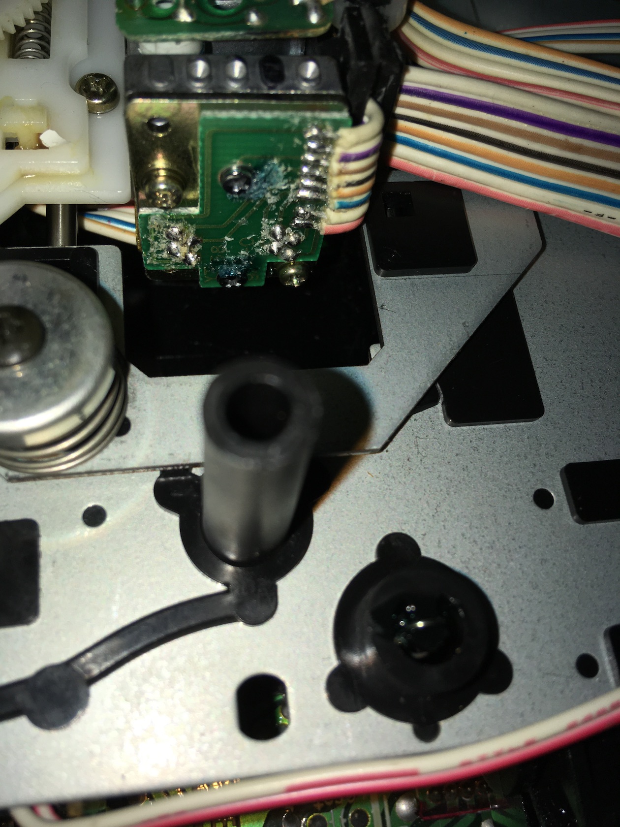

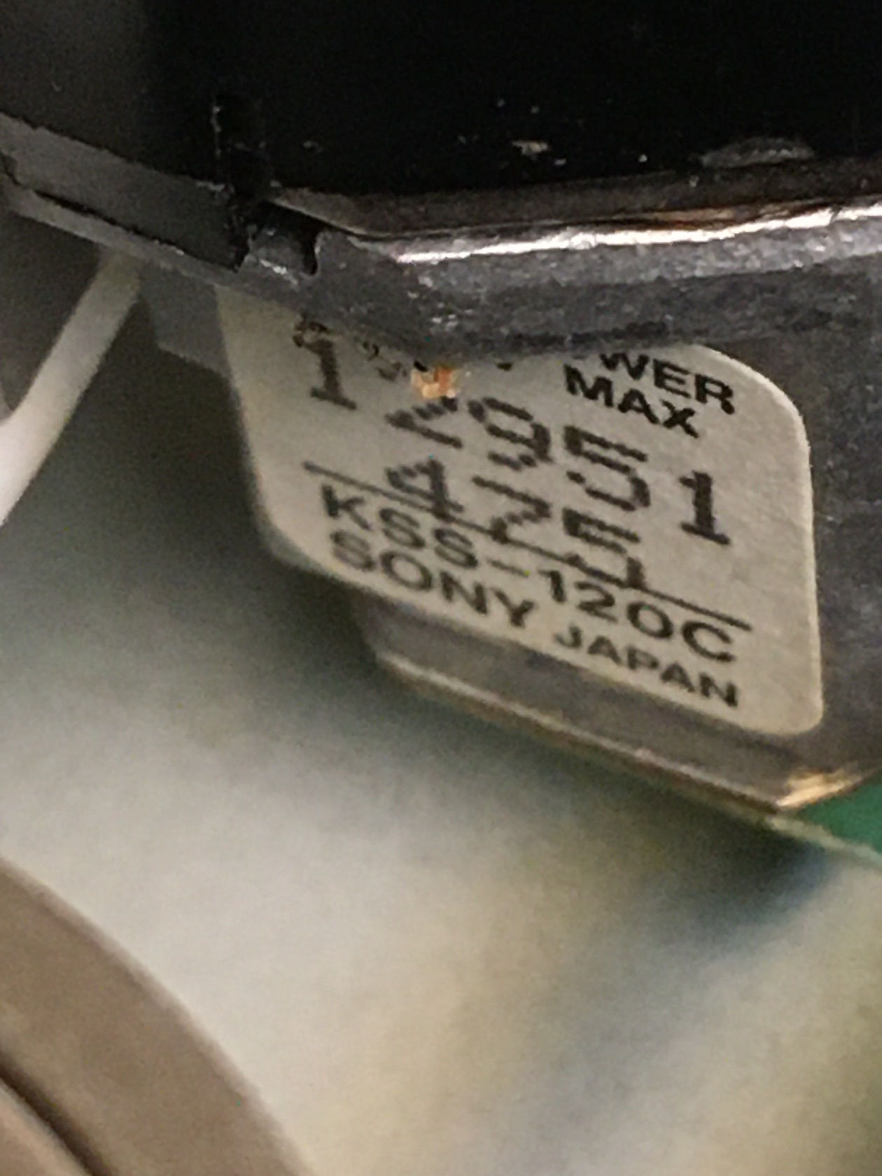

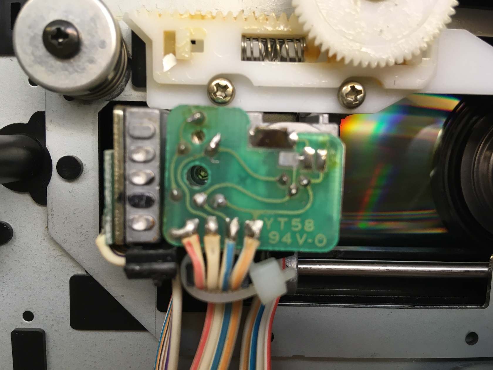

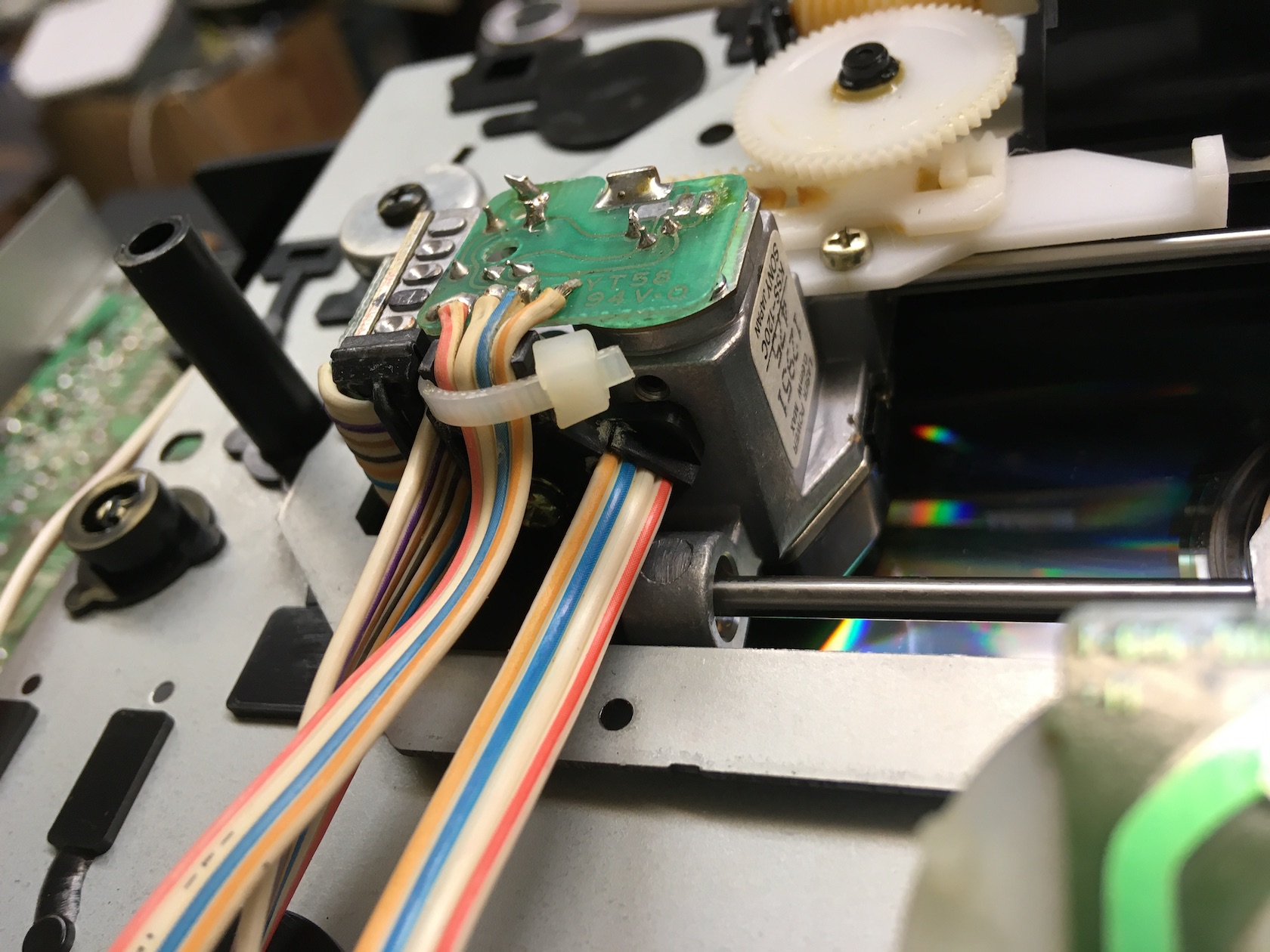

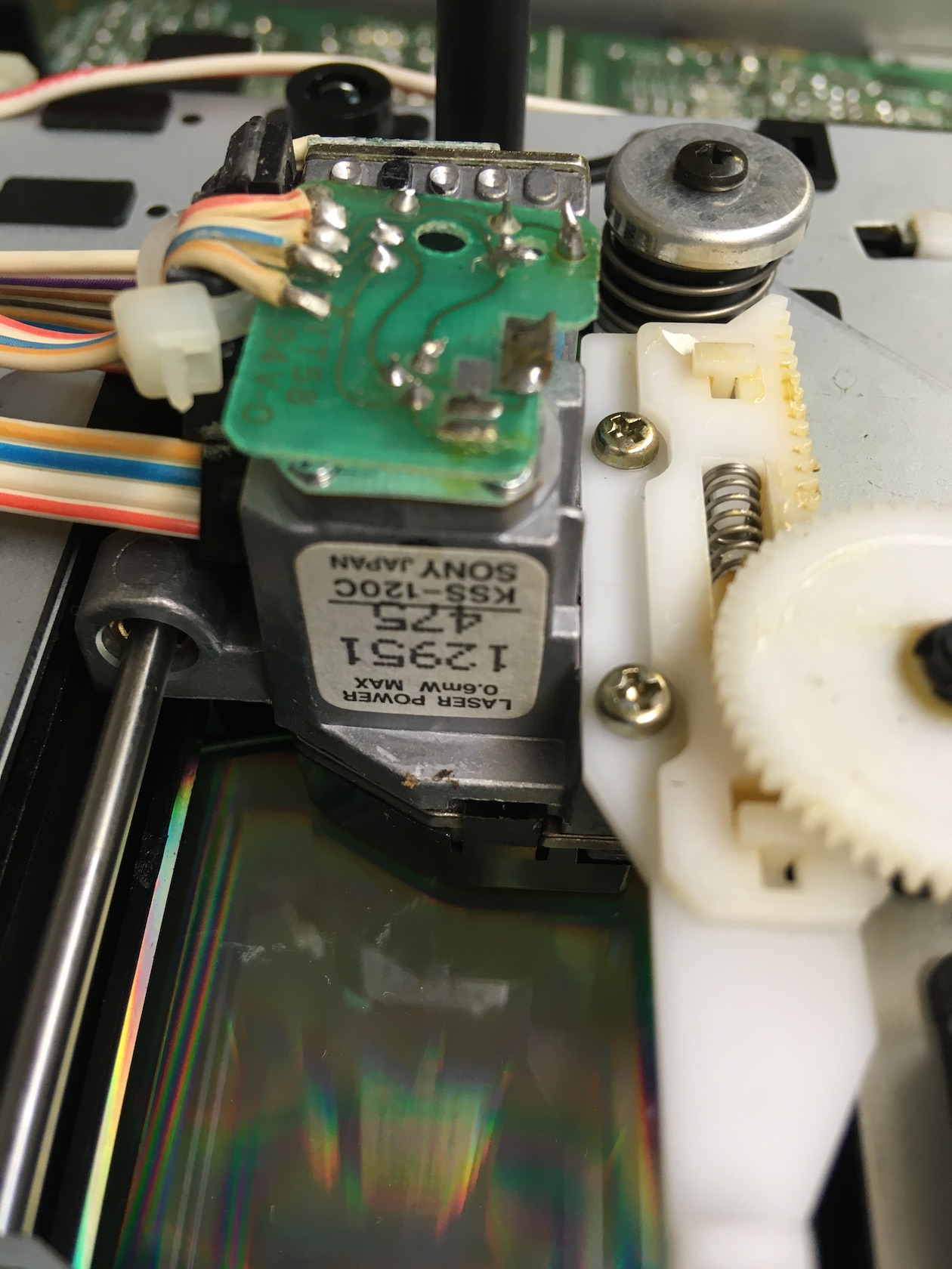

More photos and questions.
The supposed hole at the bottom of the label turns out to be simply a spot of paint, marking... what? ("Not a Hole.jpg")
I haven't found a grating adjustment hole, only the grub screw Salar identified as securing the laser diode assembly, which is just visible below the white zip tie securing the LD cable. ("Laser Barrel Grub Screw.jpg")
It's possible it's under the cable strain relief plastic.
There is, however, another hex-key screw. I don't know if it's for securing or adjustment, but Sony went out of their way to make it accessible, boring a hole in the laser diode junction board to expose it, which suggests it had to be touched with the laser lit up. What could it be? It's along the optical path between the prism and the photodiode array. It's not the grating, that's between the laser diode and the prism, right? ("Optical Path to PDs.jpg" and "Grub Screw or Adjustment Before PhotoDiodes.jpg")
And have you seen crud like this all over the photodiode array board? I don't know if it's conductive, but I'll put on some alcohol and see if it melts. ("Crud on PD Junction Board.jpg")
Finally, notice the machining marks on the PD block. Five projections, three countersunk, one painted black, one untouched. What does it mean? And the hole in the upper left corner of the plate the PD Board is mounted to matches a hole cast into the block. I'd think it's for locating, but it's not quite lined up.

I would be deeply suspicious of that crud and having worked as a bench tech I've seen countless cases of spillage/liquid damage (which can be anything from Pepsi to cat pee) and that crystalline look has all the hallmarks. It's not just that it's conductive, it's corrosive as well.
I'd agree on the adjustment hole being needed to align 'something' but tbh I've never had to delve that deep into Sony pickups... and I've replaced probably around 1000+ various optical units over the years.
I'll try to remove the crud.

It occurred to me that the mystery grub screw might be connected with a cylindrical lens for focusing - the older optics put that between prism and detector array, have I got that right? (I had Clements' book on inter-library loan but returned it a few weeks ago.)
I've no list of pickups vs models so would be starting from zero on that I'm afraid. Looking at similar model numbers of players of that era would be a start and cross referencing the service manuals.
You've nothing to loose by opening yours up and having a look and play. Its a long time since I've split apart any pickups but I seem to recall the optics in some the Sony's were often glued in place rather than being 'user' adjustable.
