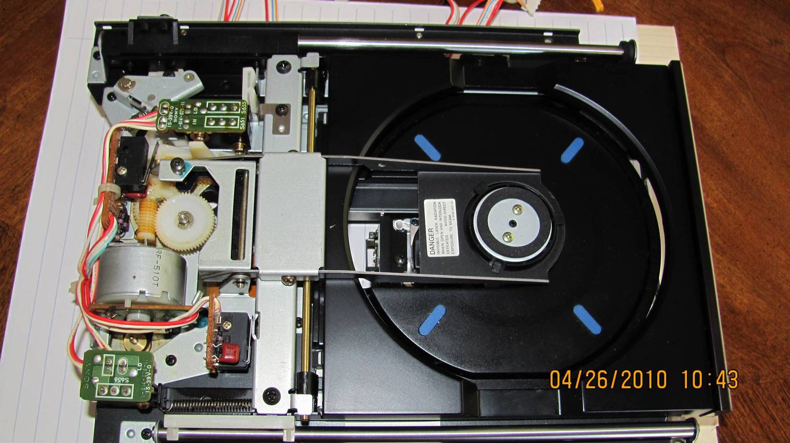

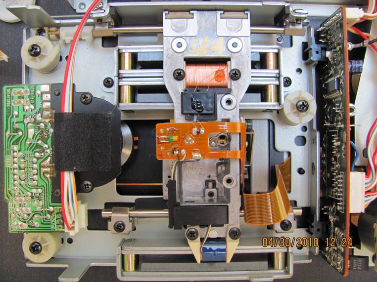

Picture 1 shows the top view of the tray that slides out to the right. Picture 2 shows the two gears before cleaning. I remove them then cleaned 4 gears then apply grease. I ALREADY FIX THE TRAY AND NOW IT SLIDES SMOOTHLY, THANKS. Picture 3 shows the back of the tray assembly. Picture 4 is the bottom of the assembly showing the sled that carries the laser. Tray slides out to the left. The sled moves freely once the assembly's ends are lifted. The unit still does not scan and still plays track 1 and 2 after just cleaning the track, no oil. Is it O.K. to apply heavy oil? Is it safe to clean the plates with isopropyl acohol? Its not really dirty. Sled moves to the center of the disk once loaded. Sorry, don't know how to add photo.

This is picture 1 mentioned in the last post. Top view of the tray and laser assembly. I will post picture no. 4 in the next post if this file becomes too big.

So it is a linear motor... which puts it in a pretty unique class.
The two tubular slides are the critical points... if you gently push the laser very slowly end to end it must feel free. The magnets will cause you to feel "friction" and the flexifoil will oppose you too, but the sled mustn't feel "mechanically" sticky. Make sure there is no dirt/fluff etc in the "gaps" around the coil and magnets that might interfere with the travel of the sled.
On the early players (not with the magnets of a linear motor) the pickup alone should slide freely end to end by just tilting the mech by 40 degrees or so. That's how free it should be... now yours won't do that because of the foil and magnets but you get the idea.
The sure way is to remove each slide and clean the bearings in the pickup carefully and then relubricate. Sony used to recommend a hypoid oil (like a gear oil) years and years ago. I'm guessing the bearings are phosphour bronze inserts so I would clean with iso, reassemble, then use a drop (and only one drop 🙂) of a fairly thick oil on the slides.

Just another thought, check that the flexible foil isn't stopping the pickup or causing friction when the mech is in place. It looks to have a bit of a bend in it... hard to tell in a picture, but if the pickup is free the problem is elsewhere.
Will the slides not wiggle out if you undo the clamps at each end... but again if it really is perfectly free there is no point.
