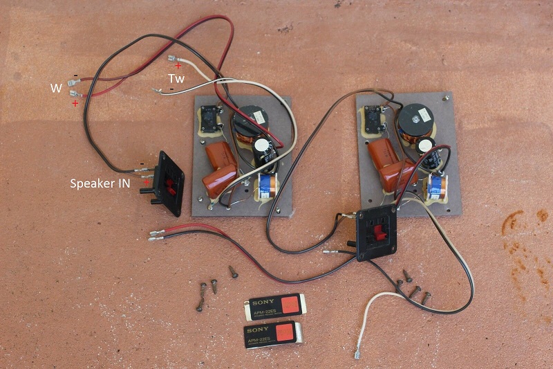

Trying to figure the wiring for a pair of Sony APM-22ES speakers. Can anyone confirm the color of the wires that connect to the terminals, woofer, and tweeter?

Thanks! I'll try that. Very helpful. The previous owner had disconnected the crossover and hooked up a wire directly to the woofer only. Network wasn't in use. This is very good info Lojzek. Will hook them up once I get home from work.

A thousand thank U's Lojzek! That is exactly the info I needed! The APM-22ess are working perfectly!

If I am not mistaken, an R(padding),C,L,C as 3rd order for the tweeter, and L,C as 2nd order for the woofer. Found the photo online.
