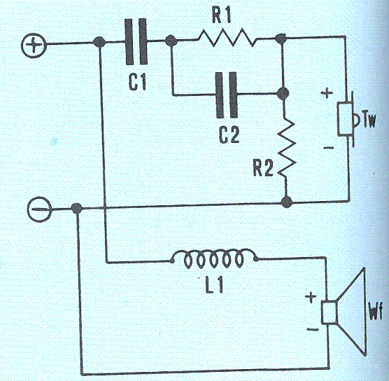

Joined 2006
The cross - over :
Banned
Joined 2004
sonus faber
I agree
the electa amator crossover is very simple
1. wf --> one series inductor for woofer
2. Tw --> one cap in series with RC and R parallel to Tw
all in phase
bass reflex
Fb=40 Hz measured
and Fcross about 2,2 Khz
external dimensions H=370 W=220 Depth=350 mm
white afroacrylic 40 mm left,right and back
stavros

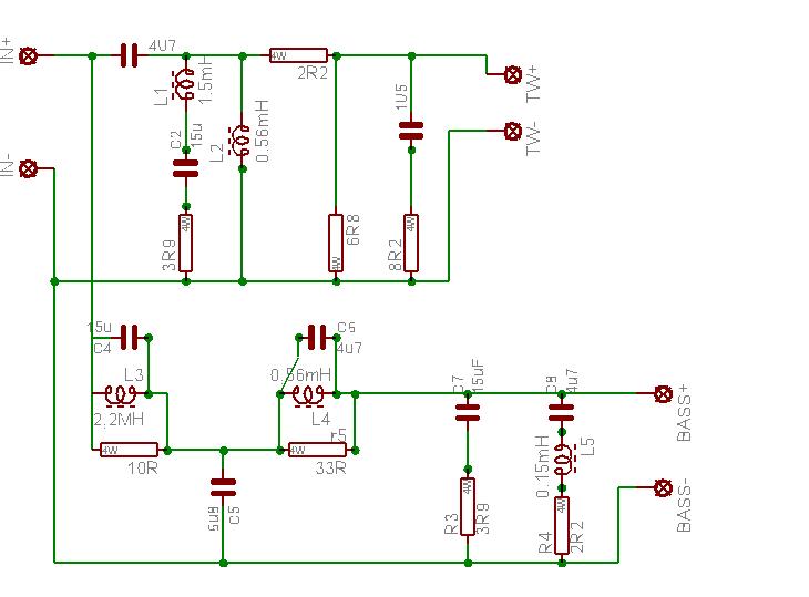

Joined 2014
hello
Electa amator 1 and 2 crossover and box seeking, in addition to published in any drawing, picture, information.
Amator1
MV180SF
Dynaudio Esotar T330
Amator2
Scan Speak 18W8545 (18WSF1)
Scan-Speak D2008/8512
Sorry, Google translator
