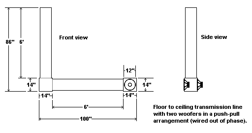

Sonotube TL for 21Hz
I want to do a Sonotube TL with two woofers in a push-pull arrangement where one of the woofers is hooked out of phase and installed backwards in the enclosure. Basically, it'll be sort of like this. http://www.t-linespeakers.org/projects/steve/index.html
I have 8 foot ceilings in my listening area so I suppose I could probably get away with a stuffed 6 footer, but what I'd really like to do is build a TL long enough to take advantage of the 21Hz free air resonance of my 12" drivers.
Woofer specs:
Dual voice coil 8ohm/4ohm
FS 21Hz
QTS .38
QMS 4.2/4.4
QES 0.44/0.42
VAS 13.3 ft³ (376.6L)
SD 0.0532 m²
XMAX 0.460 (11.7mm)
(let me know if I forgot any important ones)
A little basic math tells me...
1128 ÷ 21 Hz = 53.71 feet full wave length
53.71 x 0.25 = 13.428 feet ¼ wave length
13.428 feet = 161.14 inches TL length
Assuming my math is correct, this 13+ foot length presents a problem in my listening area.
I came up with an idea that includes just one 90° bend. The top will only reach as high as about 7'2" leaving some breathing room between it and the ceiling. The rest will be on the floor run along a wall. I have easy access to some 14" x 14" x 14" (1 ft³ internal volume) 3/4" MDF boxes meant for 12" woofers and can probably find some 6' long x 12" diameter Sonotube nearby. I bet I could trim the tubes a little (if necessary) and cut a couple more holes in the boxes and have this thing together pretty quickly.
What do you guys think of this idea? Is there any chance of comb filter effects or any other undesirable operation possible from this design? Should I add something like a 45° reflector to the box in the middle? Thanks.

A single 12" pipe doesn't have enough Vb to perform well with one of these drivers, much less two. The math is mostly correct, an end correction of (0.613*pipe radius) needs to be subtracted from its length and the SoS will probably be somewhat higher, so worst case is it will be a little too long.
Yes, there will be comb filtering. All things considered, best IMO to build an optimum one fold cab out of 19mm no-void plywood with both the drivers and vent at floor level. Use this little calculator to find optimum length/CSA (don't forget to double Vas): http://www.diyaudio.com/forums/attachment.php?s=&postid=657051&stamp=1117991086

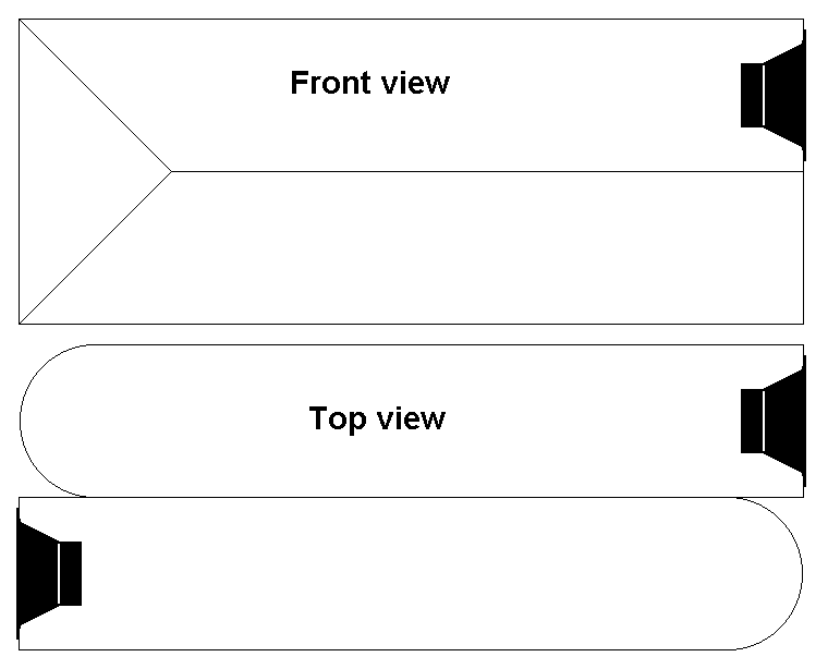

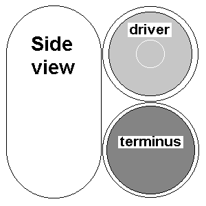

Hey, I just had a brainstorm. How far apart can the driver and the open end be before comb filtering takes place? Better yet, how close together can the driver and open end be before problems occour? Can they be side by side? How about downward firing? I've seen ported home theater woofers where the port and the driver are both down-firing. What about a down-firing TL where both the open end and driver are facing the floor? Will 'floor gain' occour? Is it even desirable? I've got a carpeted floor. If this works, it'll save tons of time and effort (and money) since I could just cut the tubes at 45° angles and liquid nails them back together. It'd just be one fold and vented at floor level, just like you suggested. 🙂 They'd get a couple bolts through both adjacent edges for greater stability and a couple legs to raise it an acceptible height from the floor (whatever that may be). They'd even probably be portable, to some extent.
I could fit two of these in the listening room without too much trouble. If necessary, the driver/open end could even be rotated up so as to aim at the ceiling if that would provide better SQ.
I whipped this up in like two minutes so pardon the sloppyness.
There's always going to be comb filtering, but it can be minimized by placing the multiple sources as close together as practical.

Let me know if I'm doing this right.
To find the CSA of a 12" tube, let's assume the ID is 11.75" due to the differences in tube diameter, which can vary by +/- .5"
11.75 x 11.75 = 138.0625 x 3.1415 (pi) = 433.72334 ÷ 4 = 108.43083
In other words, CSA of a 12" tube is around 108.4 sq inches which looks pretty close to the 107 I've seen elsewhere.
Assuming I did the math correctly,
12" (11.75) = 108.43083
14" (13.75) = 148.48496
16" (15.75) = 194.82208
Give or take.
Again, single driver Sd is 82.46 sq inch and two drivers is 164.92 sq inch. If I really wanted to do two drivers in a push-pull out of phase alignment, a 16" tube would be best. Thoughts? Criticisms?
One more question. Is 125% of 164.92 Sd close to 194.82 CSA? Thanks.

>So what if I just layed the single driver folded tube TL (as pictured above) on its side so both the terminus and driver are perpendicular to the floor? I could still fit two in my listening room, I think.
Can if you want. 'Laydowns' are popular in bedrooms since they can be slid under the bed. They are also occasionally used as faux stages or seating riser platforms in HTs.

>I still want to use the 12" woofers and I think I can with this latest idea. First, can anybody tell me the CSA of a 14" and 16" Sonotube? (I suck at math so be gentle)
It can't be any worse than mine, so give it a try based on what I posted awhile ago.
>One 12" driver's Sd is 82.46 sq inch
Two 12" drivers' Sd is 164.92 sq inch.
The CSA of a 12" diameter tube is 107 sq inch. (as seen on TL web pages)
One driver per tube should work. If I could calculate the CSA of a 14" and 16" tube, I could continue.
One more time, don't base it on the driver's Sd for best performance! This isn't to say that a pipe CSA = Sd can't work properly, just that in the larger size drivers it requires a low Vas. Indeed, the ideal CSA for some of the newer sub drivers compute to as little as 0.7*Sd! These are not good candidates for TLs either. This isn't the case with your high Vas drivers though.
>I think I understand now that maybe I don't want a TL tuned to 21Hz by length. I could appearantly shorten it to 60 Hz or so and stuff it down to 30Hz or so (and be within the realm of what GM said would work best). But these drivers need a large sealed box due to their low compliance, so I don't know.
Again, you can't 'stuff ' a 60 Hz line to 30 Hz! What did I say or you read that you interpretted it this way?
>The latest idea is basically a compromise between my original really long tube tuned for 21Hz idea and the short tubes seen here. http://www.teresaudio.com/haven/subs/subs.html
