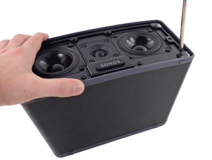

AFAIK, Sonos use paired 4" drivers for most of their systems. And it's low distortion. Active amplification, filters and equalisation to the room acoustics and placement. The Class D amps are in the speaker cabinets.
I think we must do an A/B comparison with my latest conventional squeeze to resolve this. Because it takes a long evaluation to really decide, IMO. At least an hour. 😀
Please God, don't tell me our efforts at multiway have just been rendered obsolete by new technology. Below. 😱

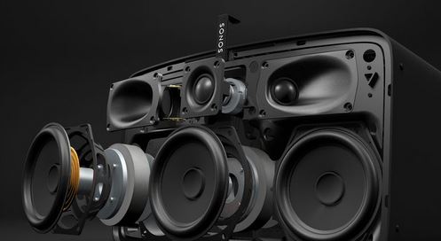

I heard the new Sonos 5 at a store a while back and was very impressed by the sound quality. Not sure how they get so much bass from a sealed box with no passive radiator. Earlier gen ones were ported.
I was so impressed I even started a thread. But it went nowhere. No one around here wants to dicker around with active DSP multiway multi channel speakers in a single box.

When you do the comparison, and you find yourself thinking "this sounds so good it is unreal", that's because it actually sounds that good. Don't be surprised if your speakers lose to the new Play 5. There are so many things going on in the new Play 5 that DIY can't even come close.
xrk971: The woofers in the Play 5 have a claimed Xmax of 8mm. That seems ridiculous, but since Dan Wiggins was the main designer, it uses the XBL2 motor and is most likely true . The Sd is a lot higher than a typical 4" woofer. They maximized the cone area by minimizing the frame with a pin-cushion style frame so the woofer has an surround to surround diameter of 4". Then they apply ~20dB of bass boost to flatten the response to 30Hz, and add a very effective variable high pass limiter, and the result is stunningly deep and loud bass from a very small box.
