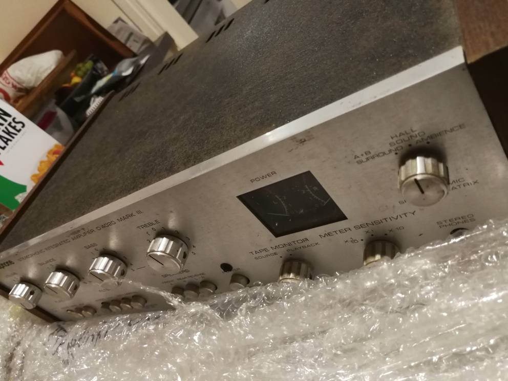

Ha, also looking (a good year or more later) but I'll probably manage. I've accidentally one on trade me [emoji51]

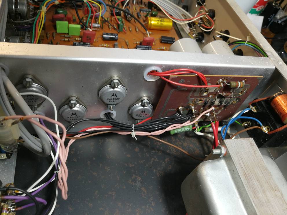

Lo and behold, initial impressions are, it may well be working...
Dim bulb stayed dim.
Output emitters sitting at half supply.
Nothing got hot.
I'll dig deeper another time.

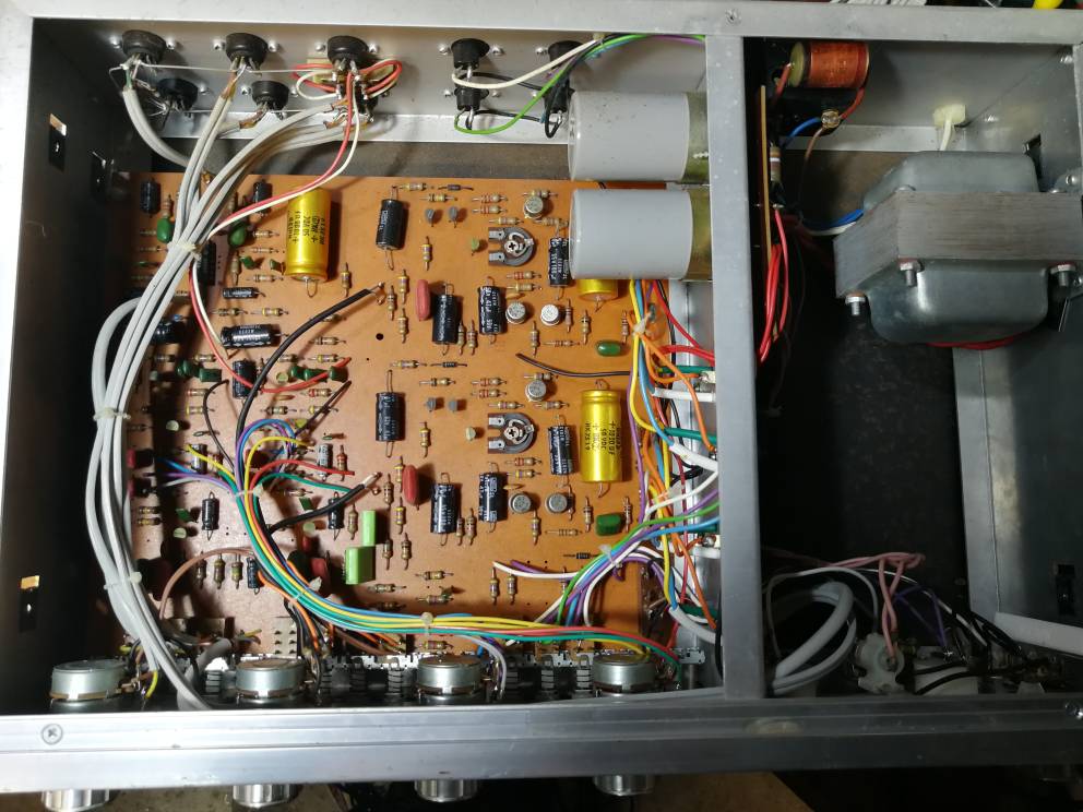

Nicely laid out and plenty of room in here. I might be tempted to build something with a bit more oomph into this enclosure at some stage.
