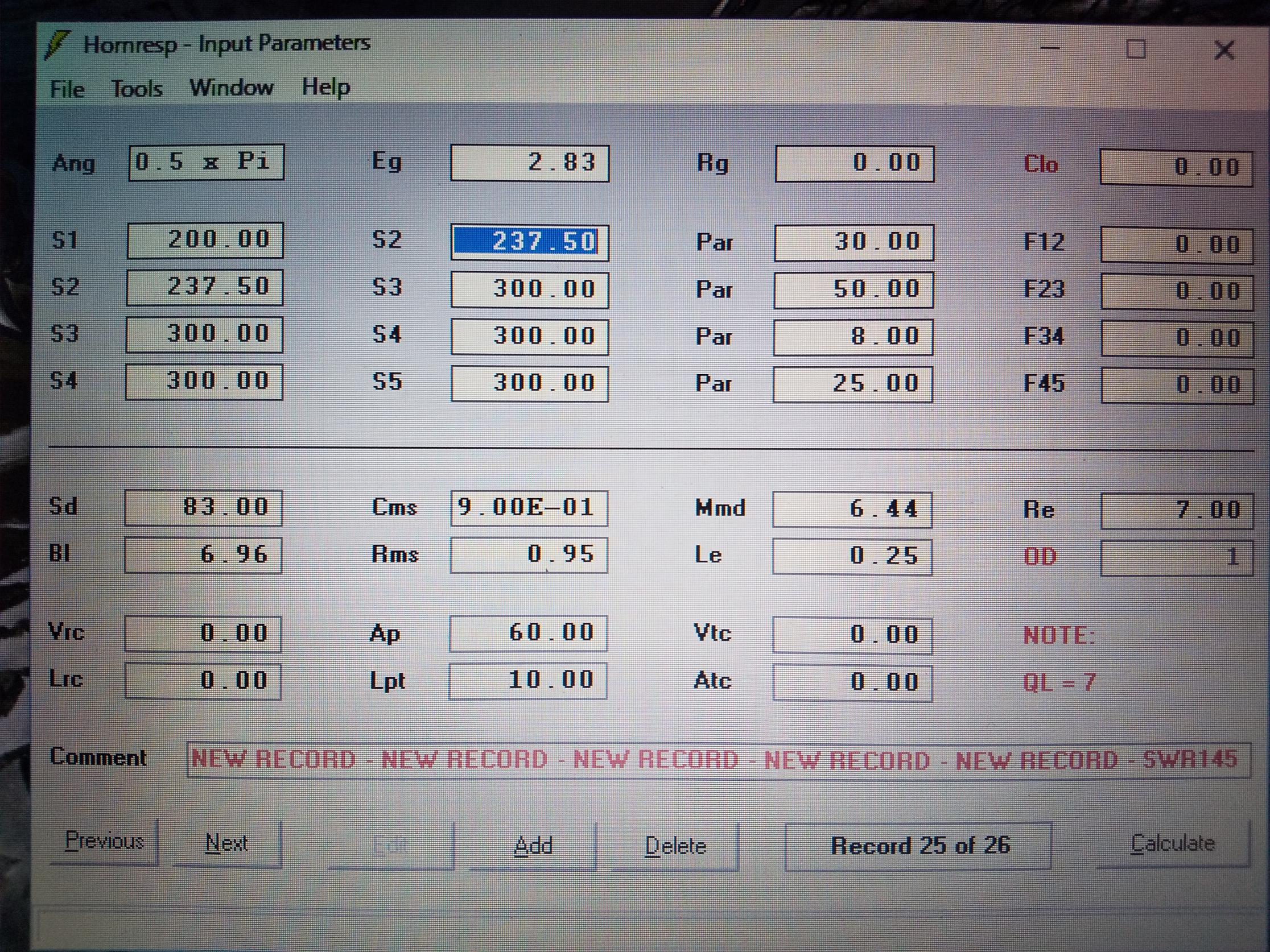

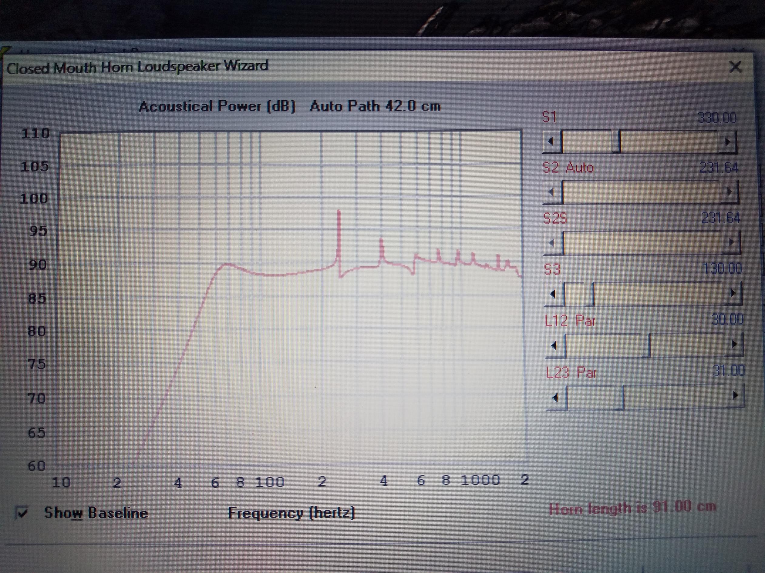

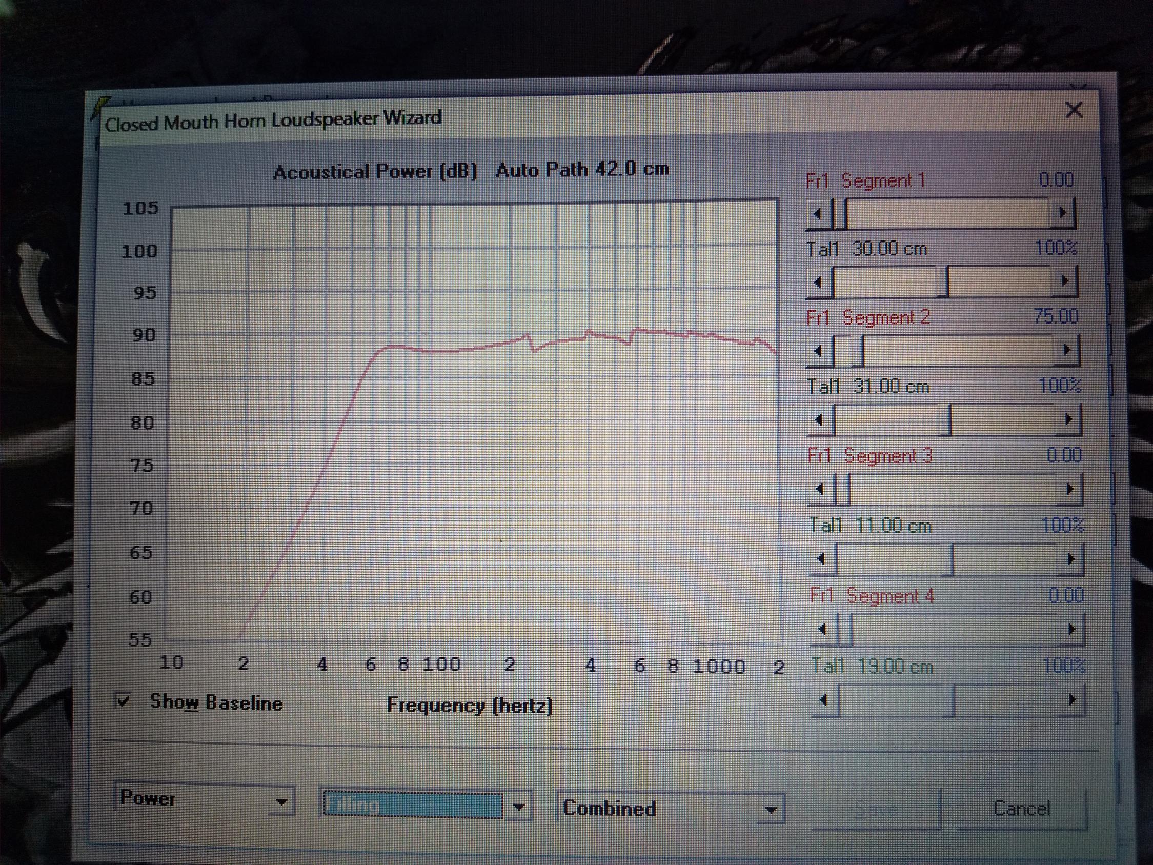

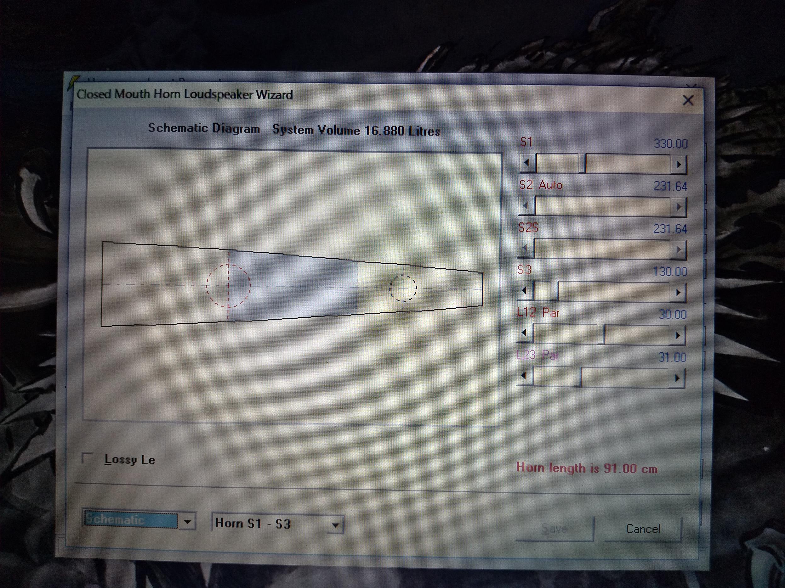

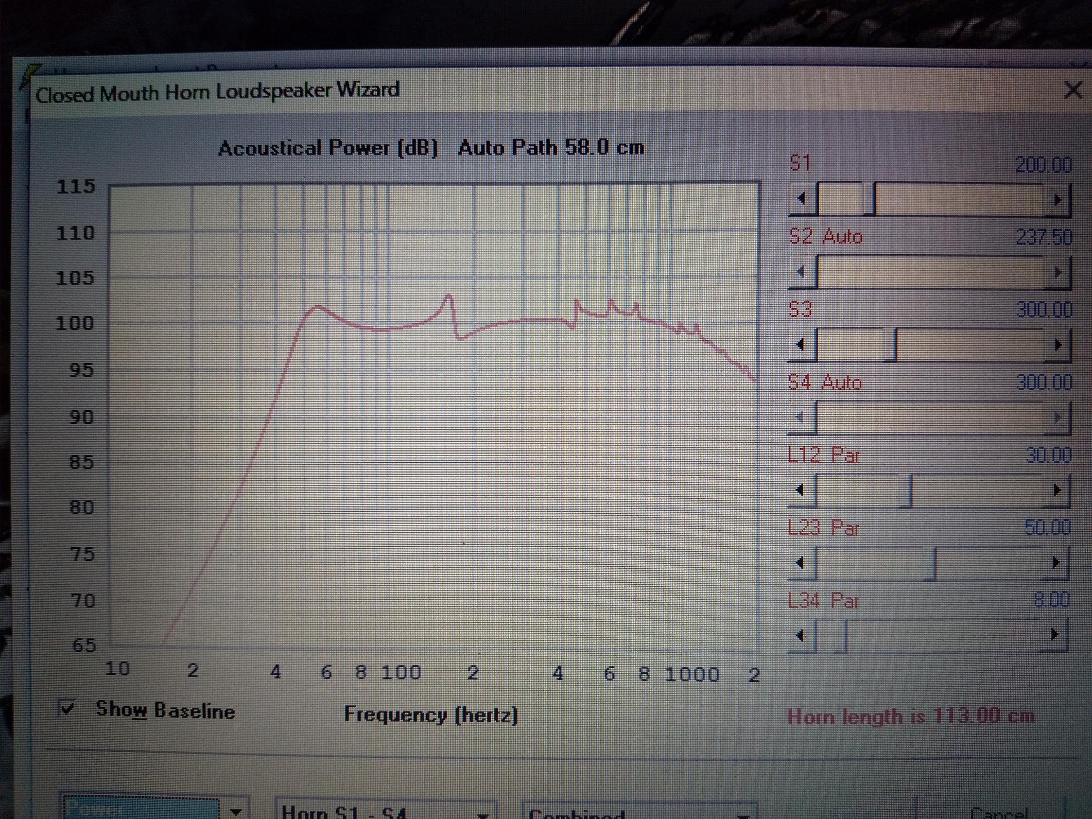

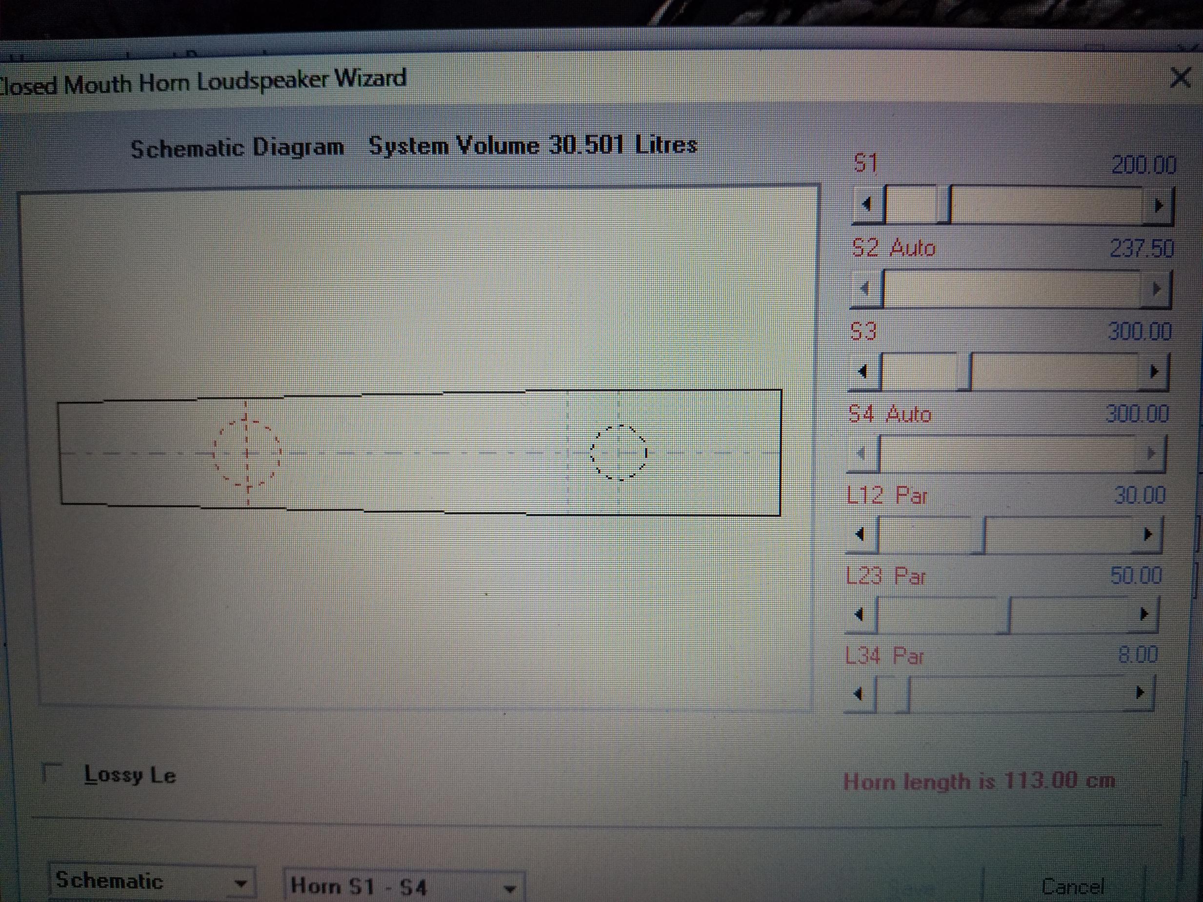

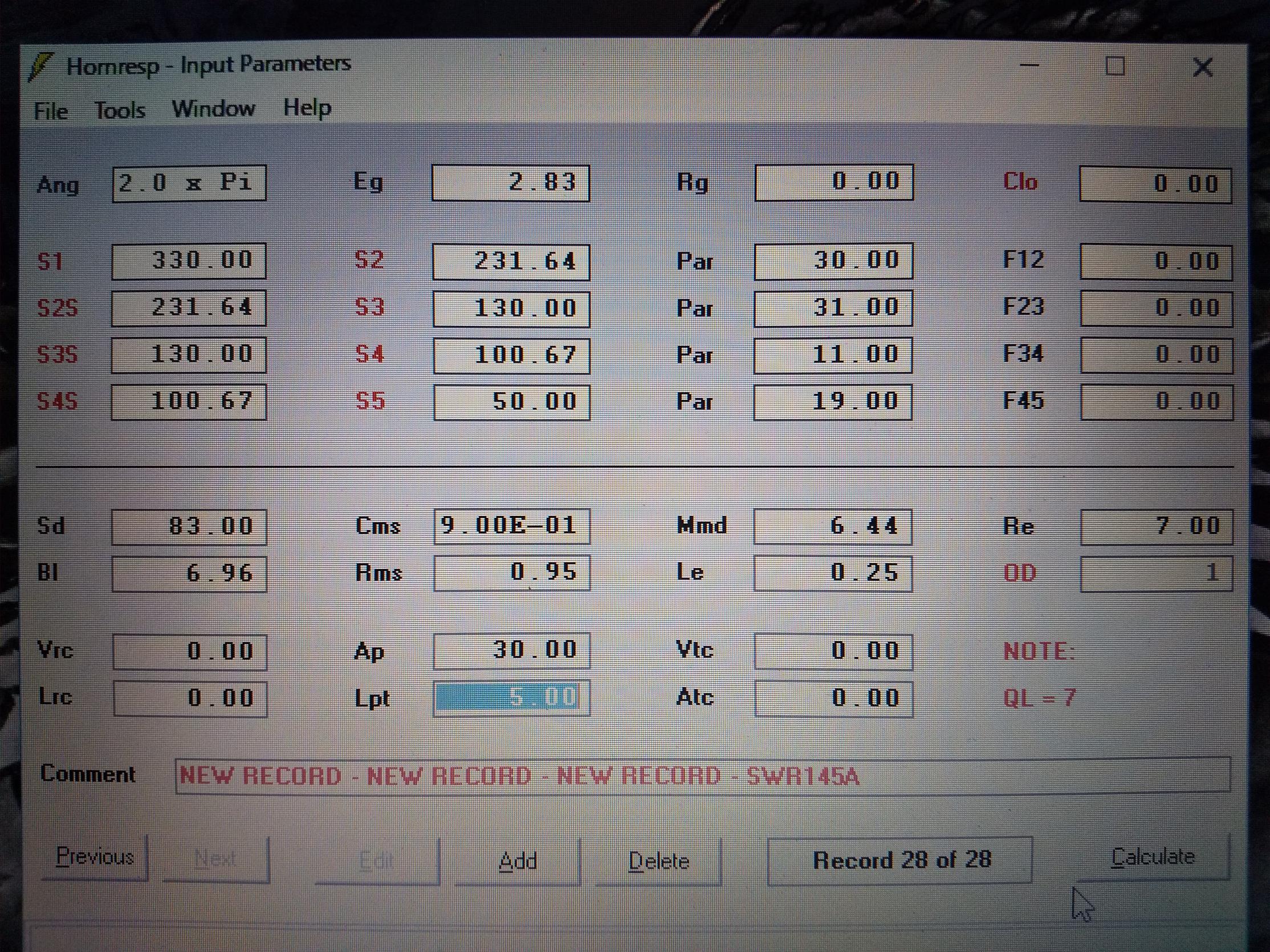

Just for my practice,I designed ported TL.
Please give me suggestions...
Hornresp gives a good result in the horn design. But if you use full-range speakers in the TL, TQWP and in the loaded horn, then the sound comes from 2 sources:
-mid and high frequencies directly from the speakers cone and
-low from the horn.
And they are summed in the air. The Hornresp program does not take this into account, so we get inaccurate calculations.

Thank you for guidance.I’d try to increase the damping. The bump up at the bottom should be slower and gentler.

Hornresp takes both sources into account. Quote from their user manual:
"For a finite damped transmission line enclosure loudspeaker system, the
Combined output option combines the transmission line acoustical power
output with the direct radiator acoustical power output."
I am not sure it have dumped more,I think better design than before and I filled in the middle.I’d try to increase the damping. The bump up at the bottom should be slower and gentler.dave
Less spl in at low-end though.
The simulation is very beatiful, but unfortunately, in practice it will not be so.
