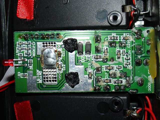

After a few months of working perfectly, one of the channels stopped working.
Thought it had fixed itself, but it cut out again after a few minutes (after warming up ?).
It's hooked up to my PC soundcard, connected to 4 ohm speakers and I'm powering it from a 9v transformer.
I'm clueless about amps, have only tried swapping the speakers and leads around to no effect.
Is it worthwhile having a look inside the box ?
Thanks for any suggestions...
(one suggestion might be buy another....SI have offered to repair it for a cost of $59 + return shipping ! )
Does it usually work when you switch on from cold and then does it shut down? This MIGHT be the thermal protection.
Have you tried gently tapping the case while switched on. Sometimes it is possible to have a bad (dry) solder joint that is affected by thermal expansion.
I suppose that you may as well have a go at fixing it yourself with some advice from this forum. Take advice first though!! There are a few simple things that you could look at yourself with a good eye, soldering iron, and a multimeter! Fancy a challenge? A schematic would help also (circuit diagram).

Censored version...
Hmmmm....
Just put the box back together, and where previously only the left channel had been working, now it was the right channel that was ok, and the left could be heard at much lower volume, which faded away completely after about 30 seconds.
At least my speakers are getting evenly used.
Does it matter that the power supply is rated 500 mAmp ?
lampman said:
Hmmmm....
Difficult to tell but C11 looks suspect...
Even though, you need more than half an amp at 12V to keep it sweet..... try a more powerful PSU
I opened it up again, and after cleaning 'C11' a bit, and staring hard for a while, I nudged the lid and the other speaker sprang to life.
In other words its a dodgy connection between the volume switch and the main PCB. Have just squeezed it all back in the box and its working fine, so I'm going to leave it for the time being. If it goes again I shall take a closer look at the white connector.
