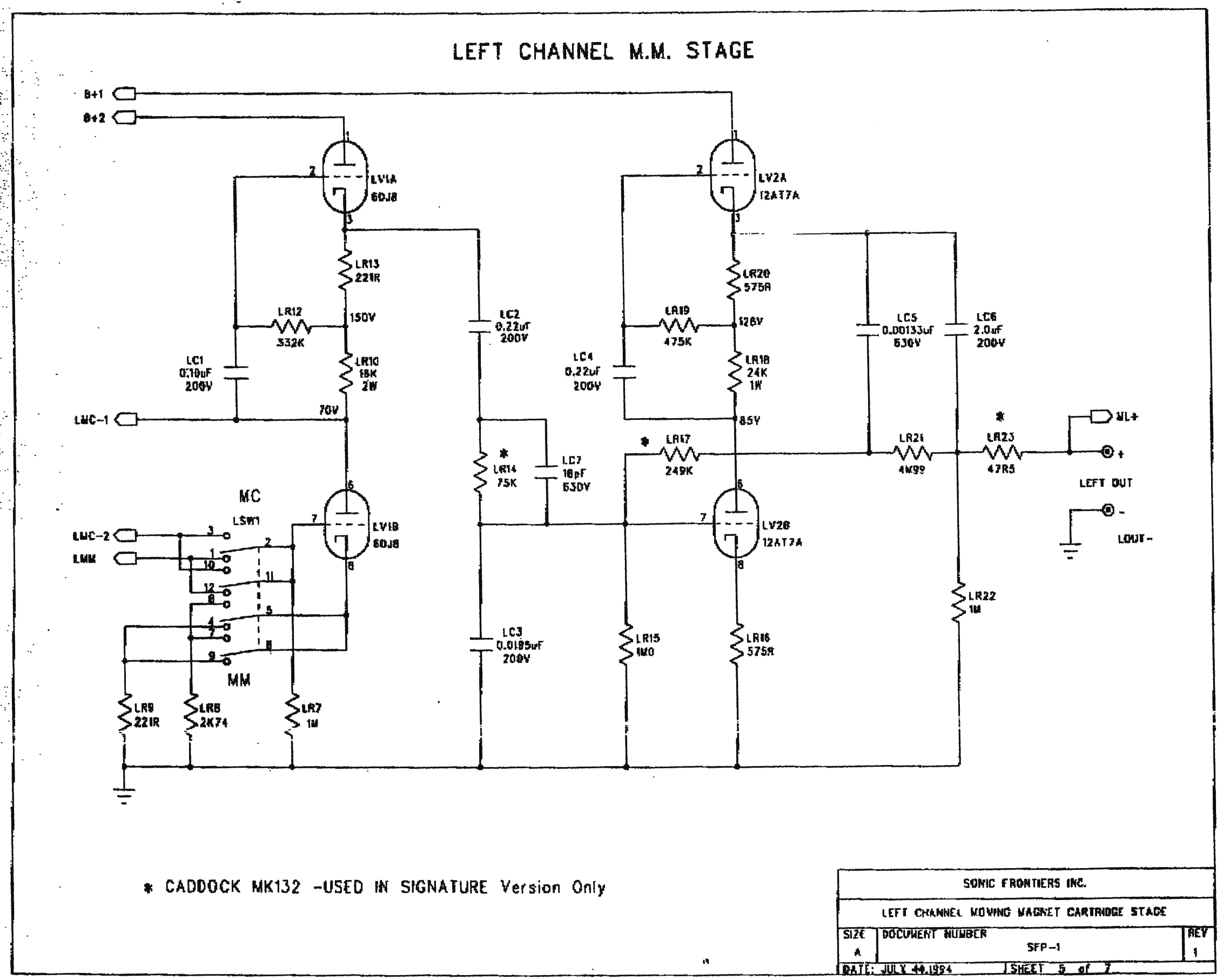

If got an Sonic Frontiers SFP-1 can I change the 12at7 for 12au7

The 12AU7 is a low gain tube with a mu of 20. The 12AT7 has a mu of 60.
I need more gain I thought that the ecc81/82/83 can be change without damage anything.

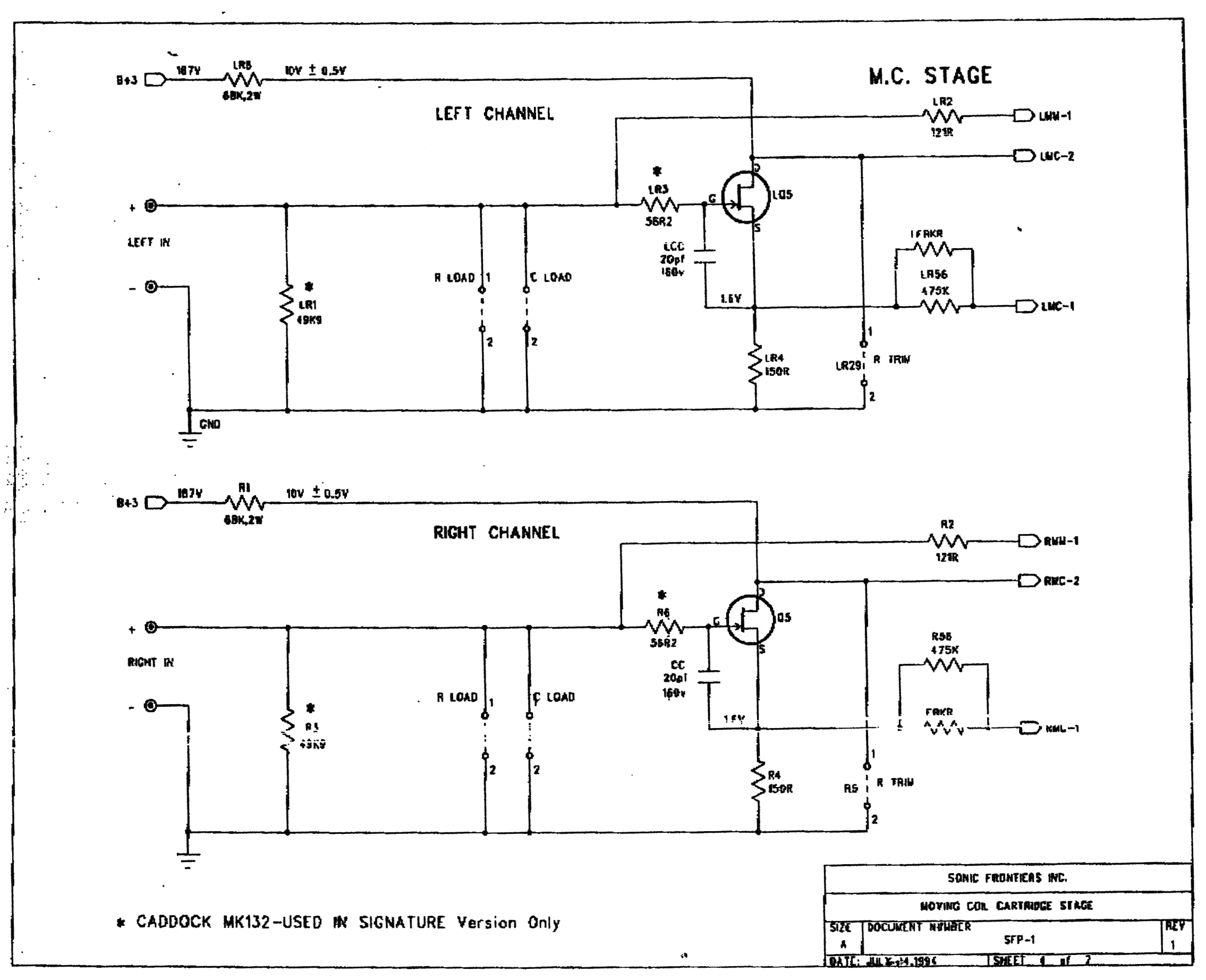

Here you can find the specs and downloadable user manual. I wouldn't change the tubes and should leave them as intended. 12AU7 will give you LESS gain. Assuming you are using a low output MC cartridge, you can try to add a step-up transformer of moderate gain and make sure the MC stage's input impedance stays at 47K. Or you can using a high gain step-up transformer into the MM stage. Or you can use a line preamp with higher gain. Or.... use a different phono preamp!

Gain: 37dB (MM), 57dB (MC)

There is no SUT I am aware of that is compatible with an MM (moving magnet) cartridge. Connecting an MM to a typical MC SUT will present the MM cartridge with something looking a lot like a short to its relatively high source impedance, the transformer gain will not compensate for that.
So there is no way too increase the gain for mc

The circuit looks 'interesting'. I am unable to see exactly how they do RIAA, but I suspect that the curve will depend on valve gain rather more than is wise from an engineering point of view. Scope for tube rolling, though! Some may regard this as a good feature.
Sorry. To change the gain would need a redesign. To do a redesign would require a careful reverse engineering of an 'interesting' circuit - which may or may not contain basic flaws. You can't simply swap valves and get more gain.
